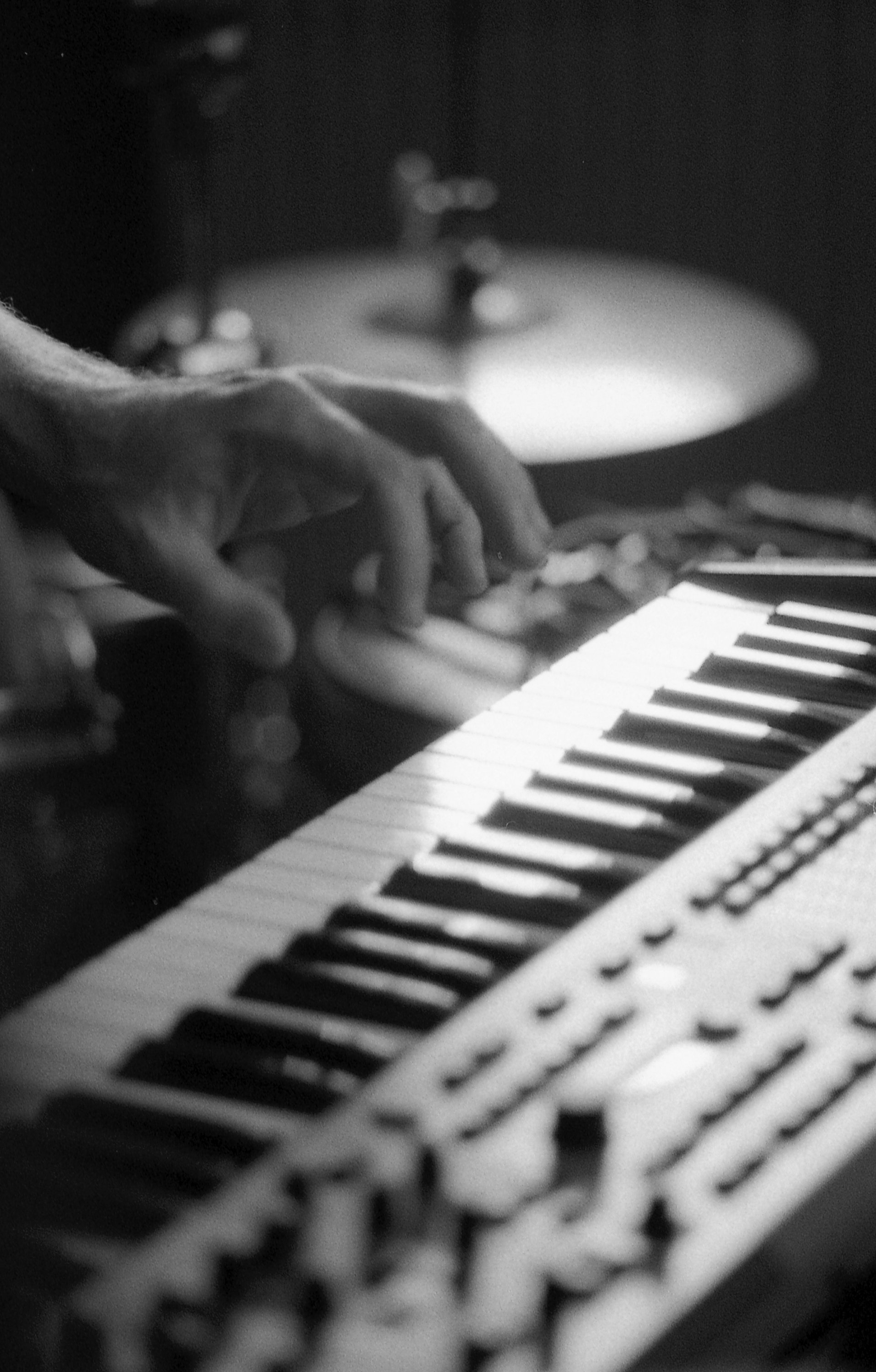

@MattKing : Below is the example of the severed hand :wink:
As for backlighting, I probably did not explain it properly (and spoke about exposure compensation when it was not appropriate) : it's not that the face of the musician is underexposed, since I had used an incident light reading for her face. It's just that, because she has no light falling directly on her face, the shadows (under the eyes or the chin) are really unflattering. Compensating wouldn't have helped in that case, I realized that after you answered.

@MattKing : Below is the example of the severed hand .
I like that - think of a bunch of them, from a bunch of different musicians. It could make for a great gallery show!
And if you wrote it up in Gallery Speak, there might be awards!:D
Thanks ! I'll keep that in mind :smile:

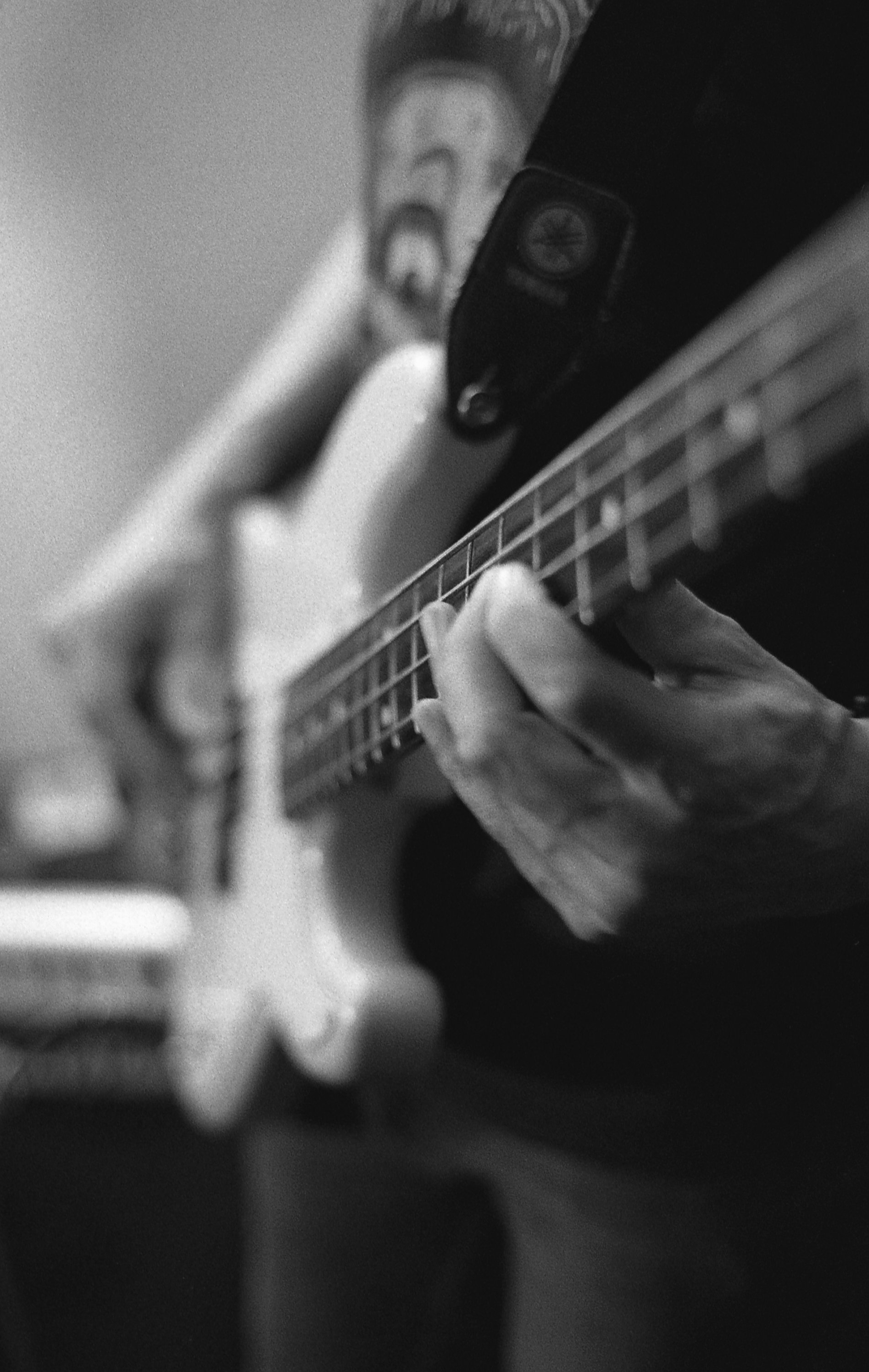

This one is not technically as "Addams Family style" as the other, but would fit in the gallery, I think... I have another project in mind for now though, something that I think I need to do once and for all. But you'll probably see a post about it in a few weeks :wink:

I think I have just read in this thread which film setting was used for the movie, Young Frankenstein. Just take a 400 film with a relatively long toe to begin with, chop two zones off even that by using gross underexposure, and you'll have ample creepy dark spaces for a monster to emerge from. "Smoke good ....Fire good .... good for burning underexposed negatives."
One can get away with significant areas of blank black in a small print, even a contact print from a large format negative, in a manner that gets downright annoying if viewed on bigger scale. And let's say you do know how to handle pure black in a compositional graphic sense like Brett Weston did - in that case, I'd rather underexpose and overdevelop a film with a longer straight line like TMY400, where one simply drops off a cliff at a certain point into sheer darkness, than employ one with a long toe like HP5, where one transitionally drifts from murkiness into mud, and eventually in black. But to each his own, I guess. Just follow the instructions on that Frankendeveloper bottle Igor is carrying around, attach the electrical cables, and then you've got it.
@DREW WILEY : :smile: Don't psychoanalyse me, but it's the kind of atmosphere and look I like in photography... Brassaï at night in Paris, film noir, "ghosts" of people (Saul Leiter is a master at that), dark and moody / rainy / stormy pictures, etc...
Edit : as to the technical points you mentioned, I'm not sure I completely understand, because I lack the knowledge to get it. Do you mean that you prefer complete blacks to almost blacks, and that some films will allow that while HP5 won't ? Or maybe that HP5 pushed in Rodinal won't ? Can you tell me, from the images I posted, what areas you would consider murky or muddy, so that I can understand better ? Because personally, nothing appears muddy or murky to my eyes (except in the out of focus picture, but I thought this was more due to focusing than to the film stock per se).
Just depends on what look you're after. I do all kinds of things. But understanding how various films behave in this respect is important for getting it to cooperate with your own esthetic objectives. Bill Brandt would be another well-known photographer to look at in terms of gloomier moods. The bigger problem is to not go so overboard in the negative itself that you have little fine-tuning wiggle room when it comes to printing it. You'd can't print gradation if it's not even there is the thinner parts of the neg to begin with; but it is fairly easy to fully darken something during printing. In other words, don't paint yourself into a corner in this respect. It's pretty difficult to adjudicate fine-tuning issues from web posted images via scans; the web is a relatively crude visual medium. Just do what you like. If you like the look, why not? But getting that special look in a predictable manner might require quite a bit of experience both shooting and printing. Then after awhile, you'll be in a position to better understand some of the axioms behind these kinds of discussion, like the relation of different kinds of characteristic film curves in relation to this. In the meantime, don't let it interrupt your fun!
@DREW WILEY : got it :smile: And I agree, I think it's better, from a technical standpoint, to have something to work with on the negative (in the shadows I mean), even if you choose later to darken it completely. I also agree on the difference between scanning and printing. And I finally agree with my need for experience and practice. Wow, that's a lot of agreement :wink: I think your last words are also very important : I shoot for my pleasure and for friends, and I'm only just starting to develop film at home. I'm probably still at the stage where it's all fun and games, where I experiment, try things out, see the outcome. After a while, I will certainly start looking for consistency, predictability, and higher quality. But fun will (I hope) still be an important part of the process. I think it's David Burnett who, when asked why he still shoots on film, and chooses to use a Holga and a view camera on assignement, said something like : "because it keeps me interested. It breaks the routine, keeps things exciting". Thanks for your comment !
