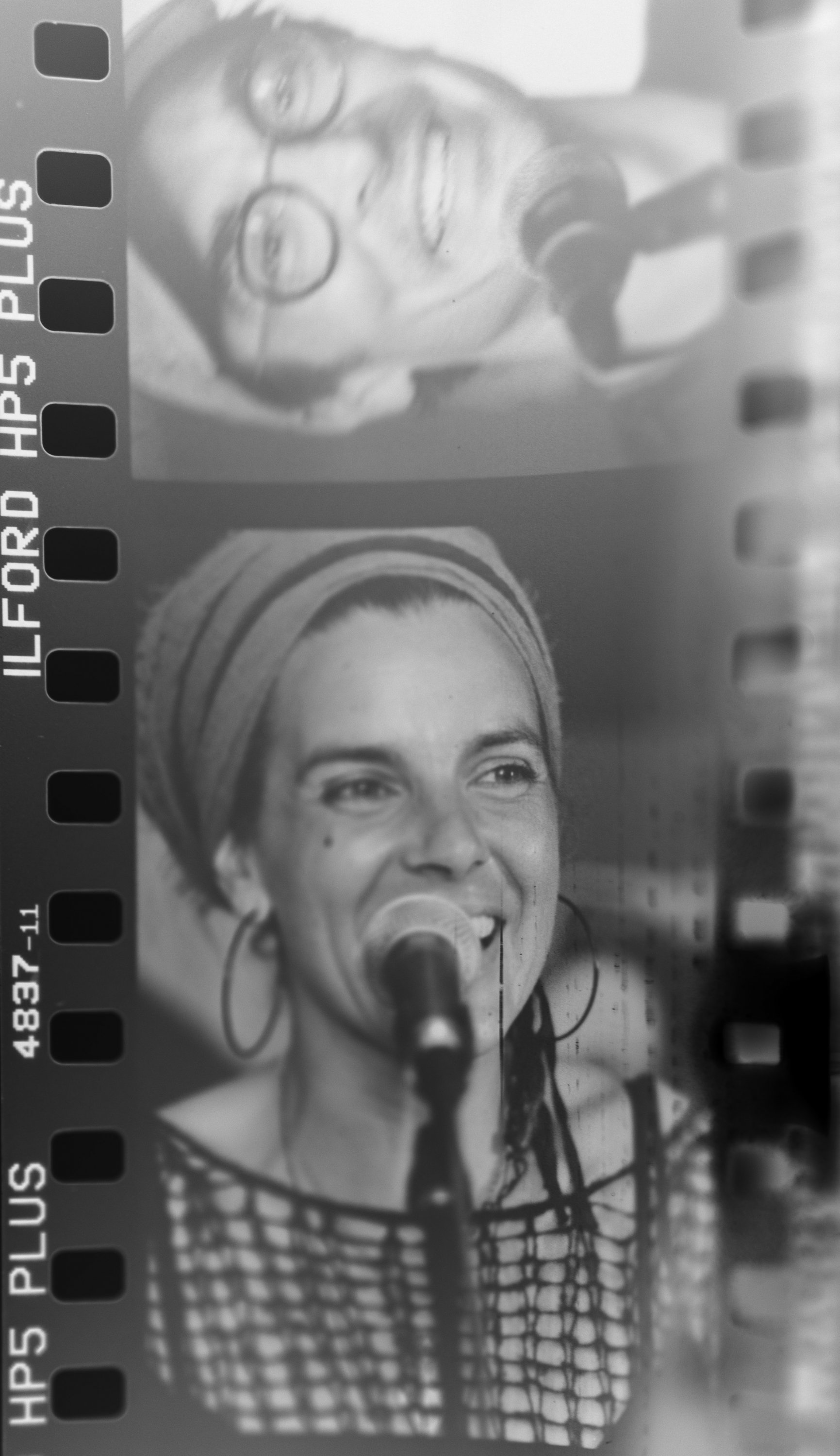

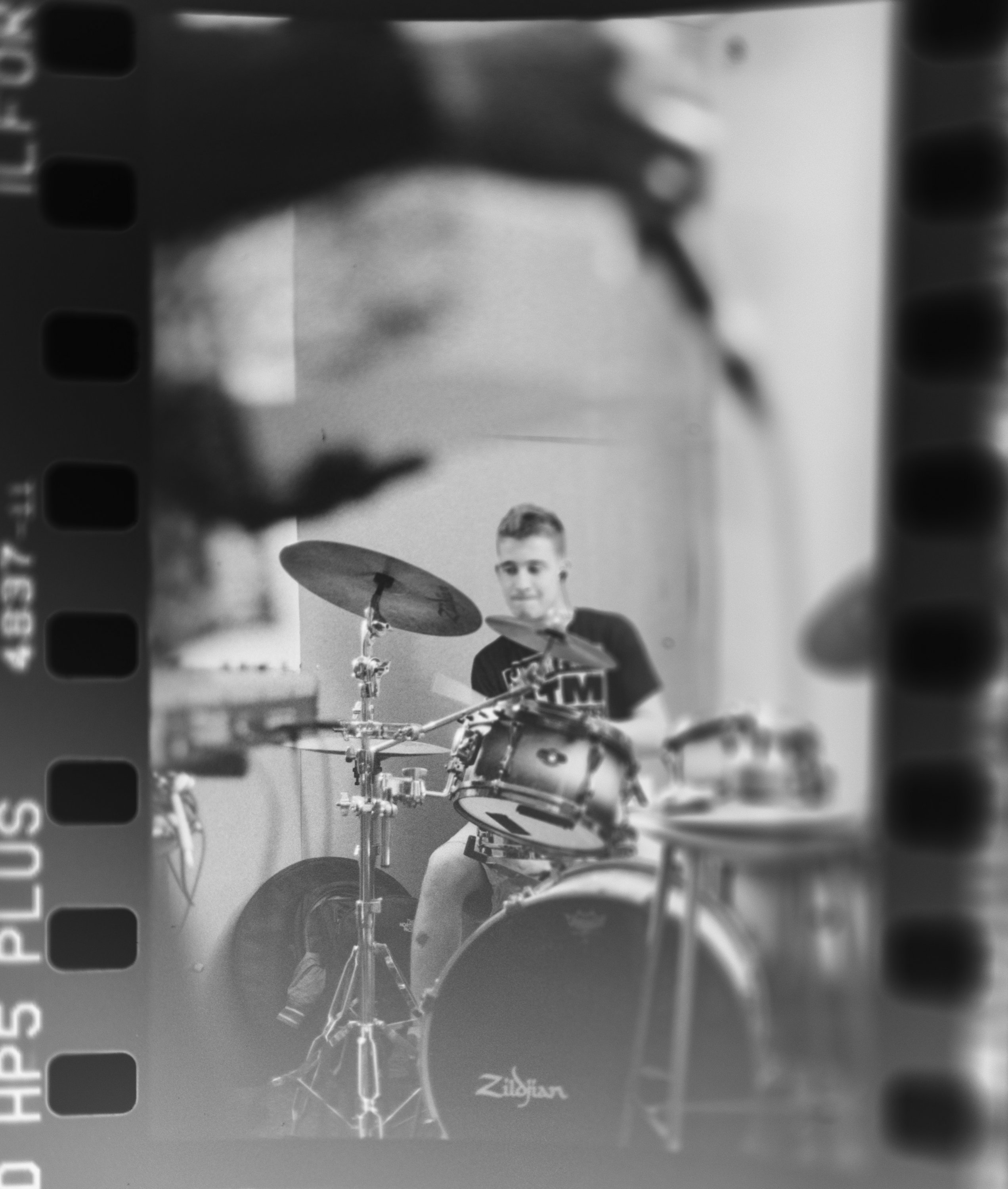

Good evening to you all !
Quick update : development over, and... there's something on the roll ! Which means I didn't screw up the whole process :smile:
For a first time developping at home, I consider it, so far, a semi-success (I'm still afraid of what it's gonna look like once scanned). I was very excited to see that there was something on the roll !
Here are 2 pictures, taken off-handedly (not sure the translation is correct for that word) in my bathroom, lit with my phone's torch, with a macro lens. The negative was still wet. Impossible to tell what the grain will be like, but the exposure seems decent enough, I'd say. They're very low resolution (I kept receiving an error message saying that they were too large, so they're only about 2Mb).
I hope to be able to scan this weekend and give you a more "in depth" result.
I followed the recipe almost to a T : Rodinal 1+50 (7ml in 350ml water) at 20°C (I tried to monitor it but the temperature probably rose a little during the process), 1 min gentle inversions at first, then 1 gentle inversion (roughly 10 sec) each minute for 52 minutes. I couldn't remember whether or not you're supposed to agitate during the stop bath and fixer, so I did about 30 sec in Ilfostop 1+19 with constant agitation, and then 5 min in Adofix 1+4 with almost constant agitation also, and then a 10 min rince, all at 20°C.

Congrats! :smile:
Helge
Jun 27, 2018
3,938
Denmark
Looks very encouraging, and nice shots those two.
Maybe it isn’t such a terrible combo, depending on the look you want.

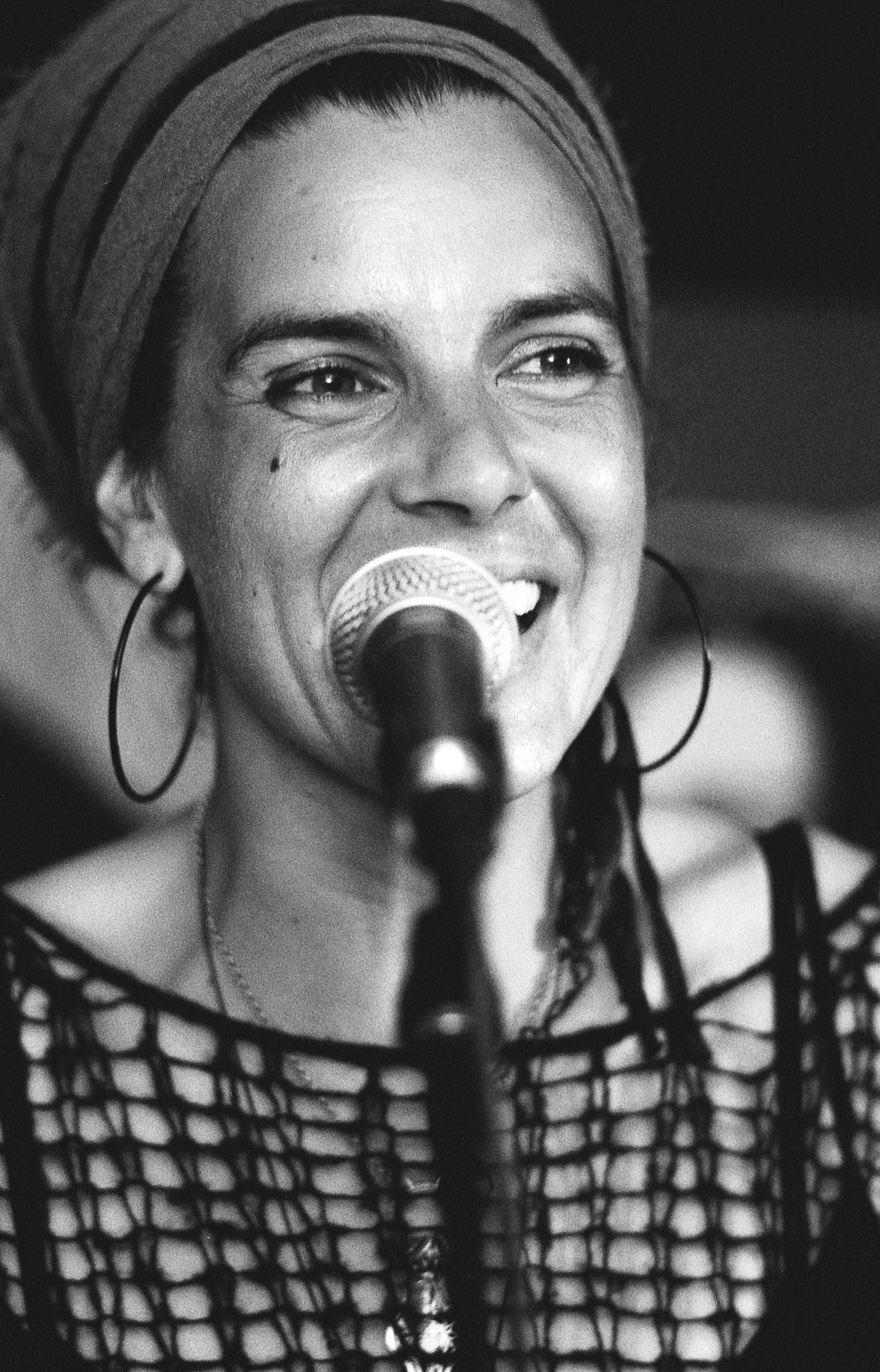

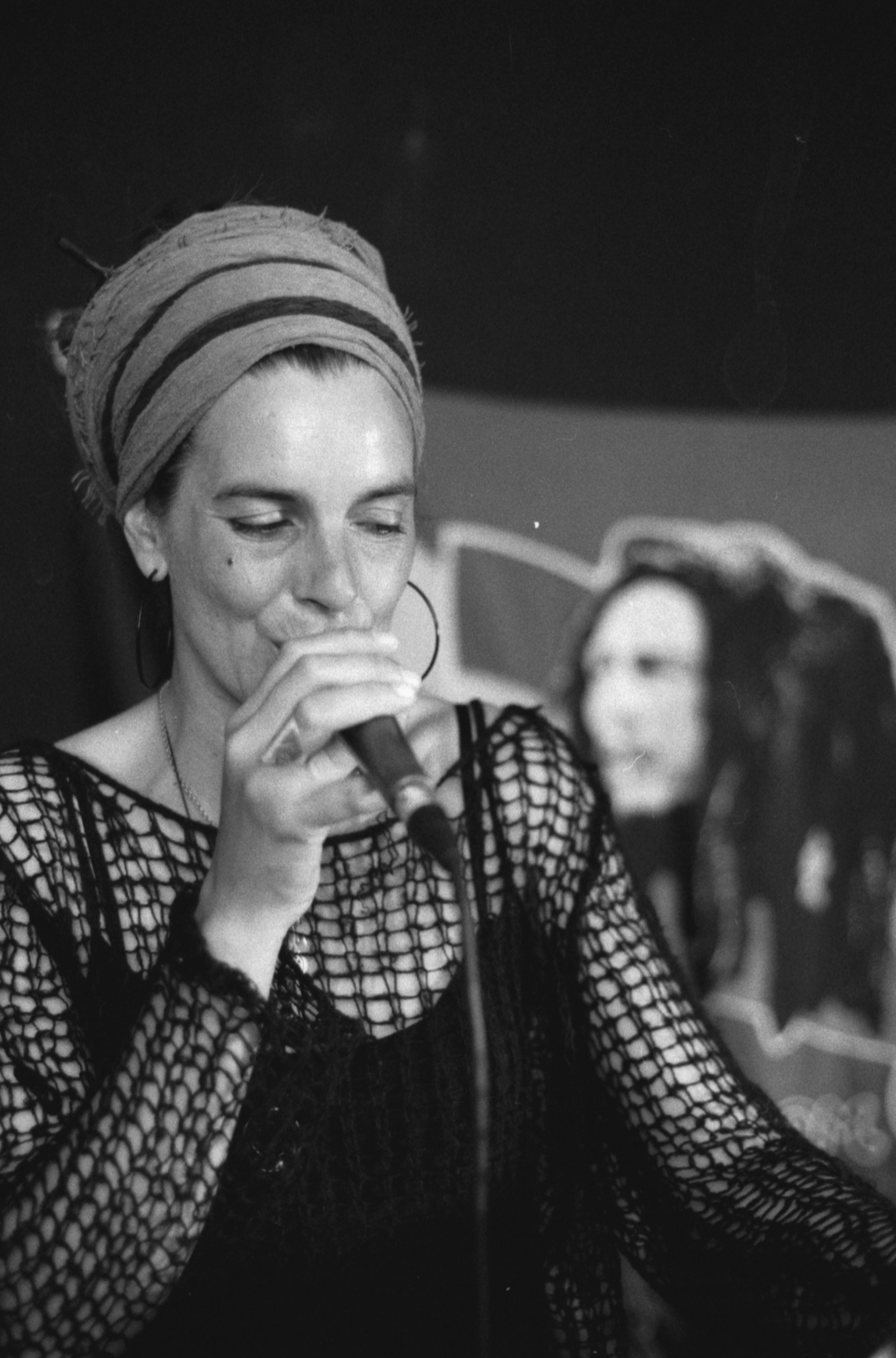

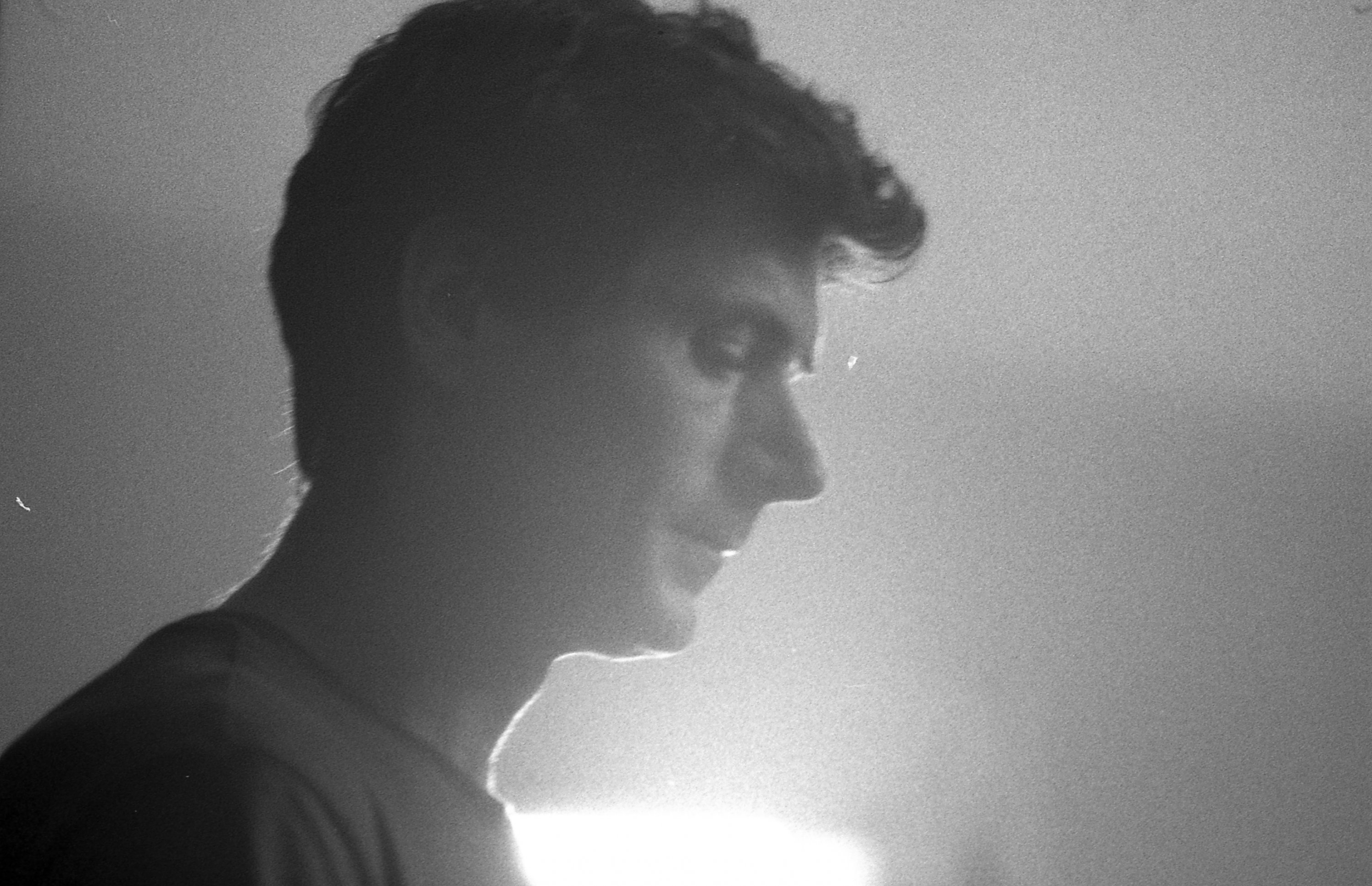

No, I didn't use a squeegee (didn't have one... another thing I forgot to buy), but I very gently ran the film between my fingers, without applying pressure, just after hanging it to dry. I didn't use a wetting agent either, and to be honest, I have no idea what the quality of the tap water is here... Beginner's mistakes... I'll know more after the scans.
So far, from the 12 first pictures, I can say that, to my eye, the tonality is decent, and the grain surprisingly not too bad (that's what I was fearing the most). It's quite noticeable on some pictures, and much less on others (it's worse on uniform tones like light grey which, as far as I understand, is normal). It could also be my scanning process, because I'm not master at that either... It looks like the grain is a bit worse when I "lighten" (open ?) the grey point. Overall, for my taste, I'm pretty happy with the result. The thing I'm not happy with is all the rest : composition, moment captured and all that :sad: But I suppose it comes down to practice : the first pictures I took of skydivers were honestly so bad that I can't for the life of me understand why they agreed to let me come back :D Now, after 3 years, it's much better. So... we'll see in 3 years !
Yaeli
Jun 2, 2021
103
France
Ok, here are 3 samples : the one which shows the most grain of all (018), one with a rather low amount of grain (012), both flat / unedited scans on the V600, and probably my favourite, with a quick edit (but no grain reduction). I don't know what you think, but I'm glad I tried that recipe. I can't see any of the horrible things many people (not specifically here) foretold me if I were to use Rodinal on HP5 at 3200...
All were shot on an OM2n, with the 28mm f/2.8, the 50mm f/1.4 or the 135mm f/2.8.

Very well done Yael. :smile:
I have found through experience over the years, both on forums and in books and magazines, is that you can look or ask for an answer to just about anything, in this case photographically, and you will get sometimes, dozens or more of different replies, all giving different advice.
The best way to learn anything is to both read, but also to try things out yourself. For as you have learned, what your actual result is like, is quite different from many of the answers given.
One can definitely learn from books and others, but sometimes one just has to go with ones own feelings and give something a go.
Well done once more.

Really Nice work. 12 and 17 look absolutely wonderful. Problem with 18 is not grain - grain gives it a wonderful atmosphere; it's more a question of focus, the main challenge when you photograph concerts full open.
