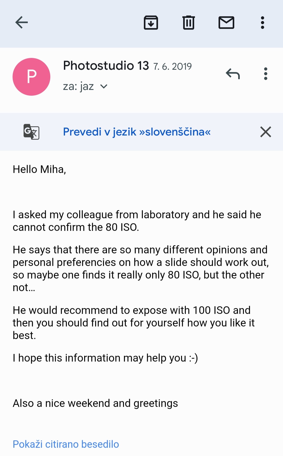

What is more important I have consulted Photo Studio 13 (you know them well, they were one of the biggest German pro labs before they were swallowed by another company in 2022) soon after I read your posts on ISO 80 and they advised against it, bellow you can read their answer from 2019:
Hello Miha,
I asked my colleague from laboratory and he said he cannot confirm the 80 ISO.
He says that there are so many different opinions and personal preferencies on how a slide should work out, so maybe one finds it really only 80 ISO, but the other not…
He would recommend to expose with 100 ISO and then you should find out for yourself how you like it best.
I hope this information may help you :smile:
Also a nice weekend and greetings.
Andrea

Whats the point of this question? I have exsposed quite a few. Does it lose the speed after certain number of rolls?
Please.......
No, you have not contacted Photo Studio 13, because they have stopped their operation already at 31.12.21.
So very long before anyone here in this thread discussed that topic.
Photo Studio 13 simply does not exist anymore. Their lab closed, the machines stopped. The most experienced employees retired. Period.
And Prolab in Stuttgart had just taken a part of the PS 13 customers, as recommended by PS 13. But Prolab always has been independent and established before, a complety different lab.
Saying that as fomer long-term PS 13 customer.

@Film-Niko I'm attaching a print-screen from my google email account.
@miha:
The response you have posted is from 2019.
Our discussion here is from August 2023.
@miha:
Are you suggesting the film (E100) changed from 2019 till now. Please re-read my post. This ISO 80 thing stared at that time by certain vocal forum members over at the RF forum.
What may have been posted on Rf forum is completely irrelevant for our discussion here. We are on photrio here.
