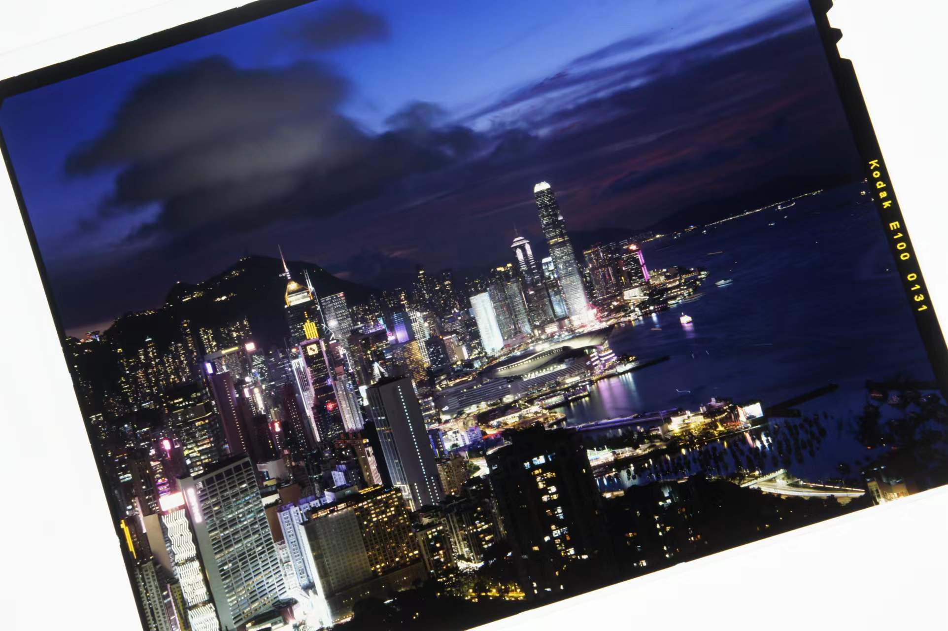

Here has two wonderful works photographed by my friend and client photographer Deng:smile:
The comparison with rvp should be handed over to e100vs. e100 is more similar to rdp. Of course, I think the highlight bearing capacity of e100 is slightly better.
Now I think the biggest problem with reversal films is the need for an e6 process that meets the standards of Kodak and Fuji. In this regard, I think Fuji hunt and Bellini should be able to do it, but the former seems to have been discontinued
Regarding the problem of bluishness, reversal films will inevitably turn blue when shooting at high color temperature, and rvp100 is no exception. This is the same reason as 5219 shooting daylight.
From my experience with processing, the e100/5294 and rdp does have a slightly darker blue than rvp100,but rvp50 can get away from it

Are filters used here?
Night photography has its own idiosyncrasies, especially when artificial lights are involved in the scene.
For example see this exposure guide:
