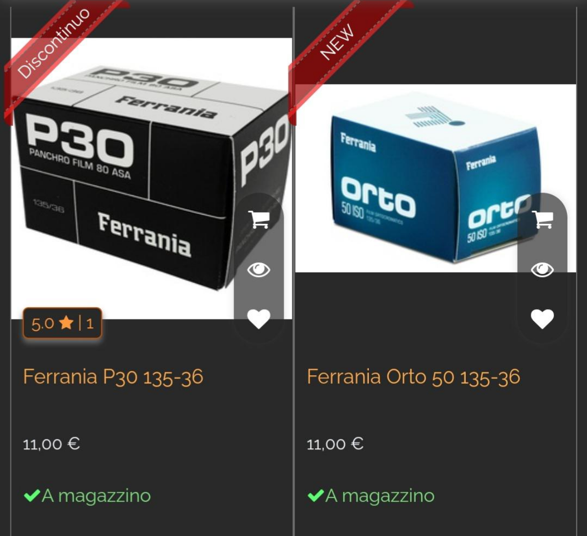

Why would it?
maybe you misinterpret what’s written in Italian?
...aha....yes that is a good thing (no discontinued P30). !
Then the Italian dealer will have made a mistake - this probably meant that the P30 is just sold out for him.
It just means it is intermittently available only

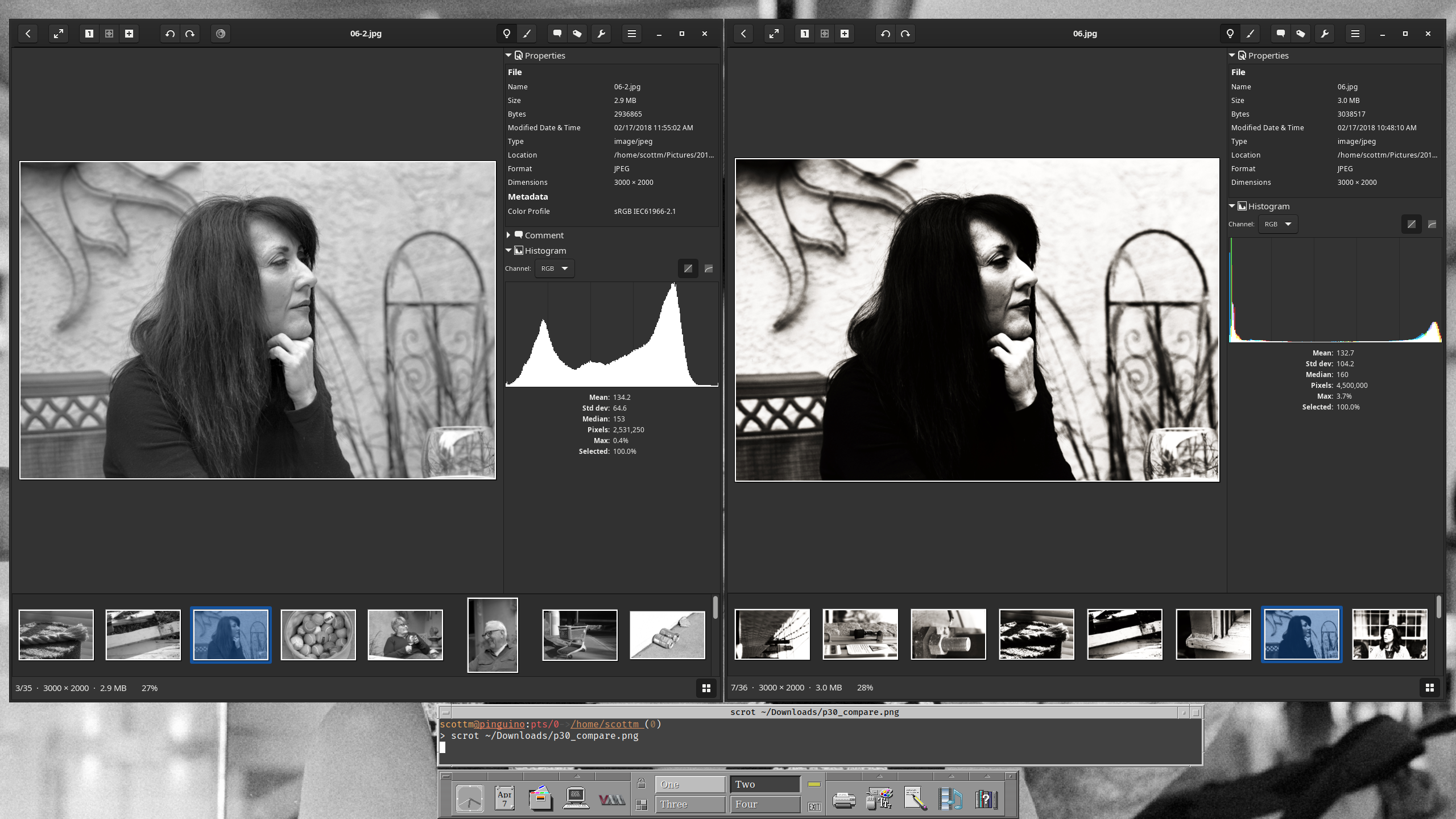

I've never gotten the P30 through the Pakon in its default jpeg output, no matter if I shoot at EI 32 of 80. For whatever reason, the software might have trouble finding the black point or white point. I usually output the pakon as 16 bit raw and just do a log inversion using either imagemagick or Negative lab pro in gamma mode. The Orto, however, is much like HP5/FP4 and even better than Acros, which outputs incredible grays from the little F135.
Here is a P30 sample, EI 80, developed in Paranol-S 7 minutes 1:50 20C. Pakon on the right.
Thanks Scott but while this may be the case for the F135 scanner, might this not be a quirk of this scanner. Other scanners may or may not handle P30 just as well as they do the new "Orto". Equally enlargers may handle both films equally
My concern is whether this is a real difference in the 2 films and we lack any real data from Ferrania on this
Can you say if your the Macbeth charts demonstrate this improved rendition of the greys. Certainly it would seem that both films look equal in terms of being genuinely Ortho in nature rather than the P30 being Orthopanchromatic and the new film being much more Ortho and yet having the ability to render the greys which are other colours in a more panchromatic way
