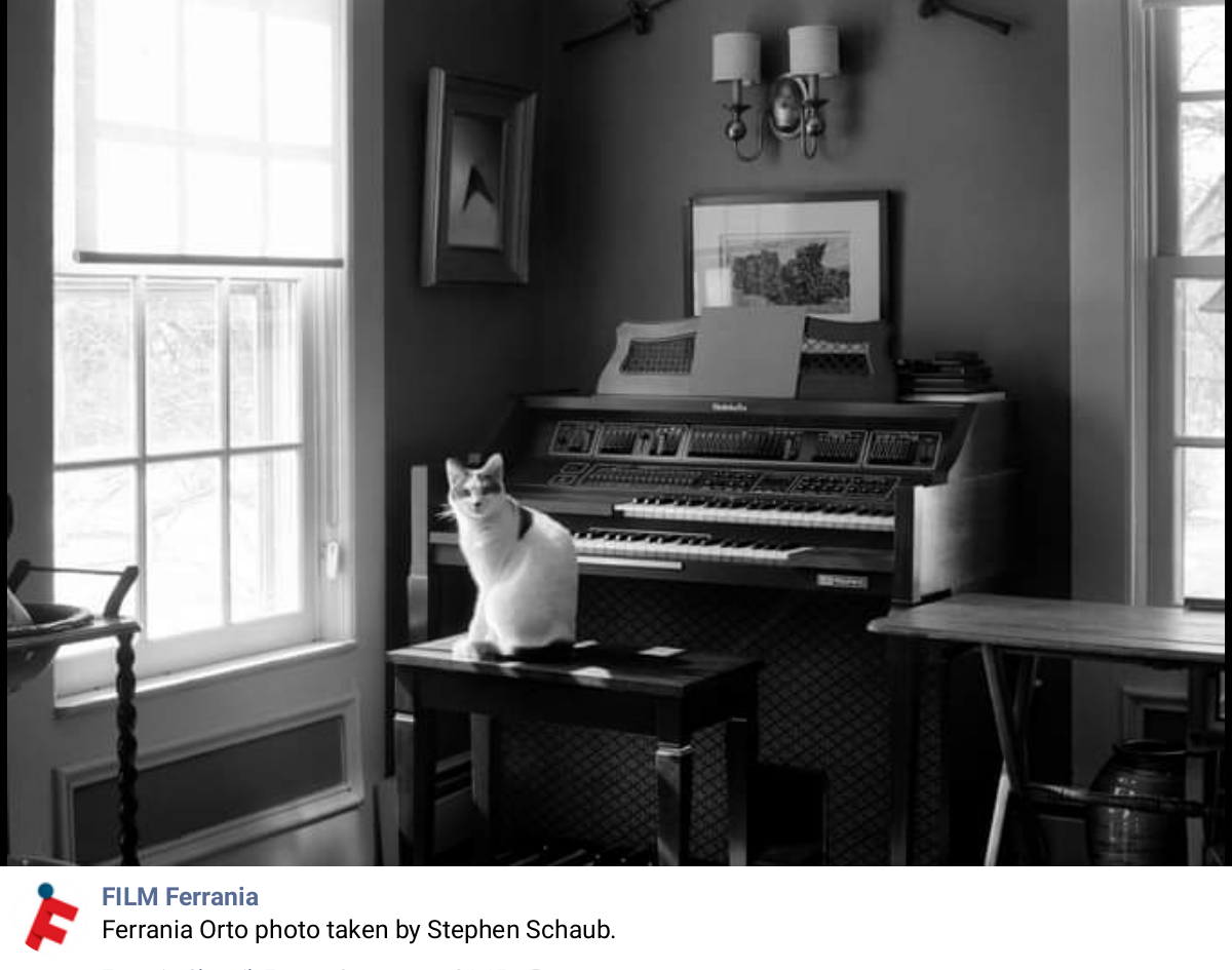

Your first shot looks fine. Are there any reds here? Is this a print or a neg scan and what speed was it shot at and what developer, dilution and time was it developed at

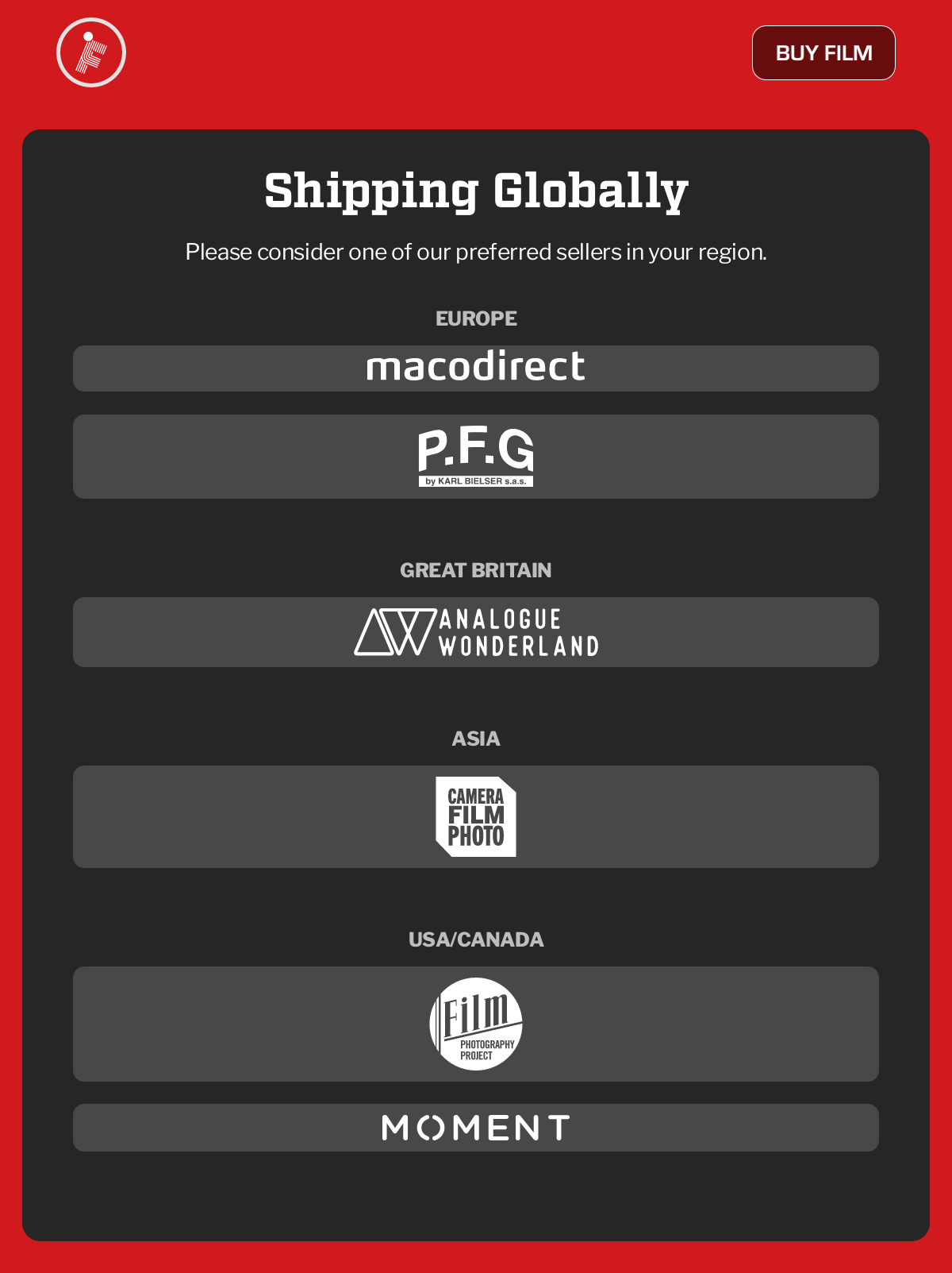

How can one try/review this film when it isn't available yet? 🤔 Us Canadians don't even have a dealer here, and have to order from shops down in the US.

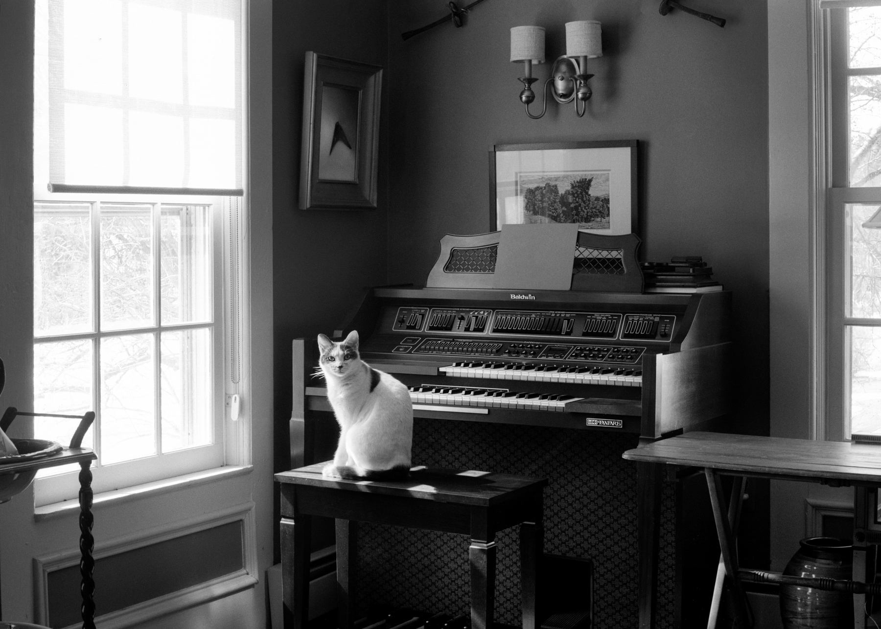

Laboratory developement with a special b&w film like Ferrania Orto ? I'm really thinking about it, but in my understanding that made no sense in the past.
Exeption : Special developement in a special b&w lab with
freely selectable or recommanded developers.(wich was allways the most expensive solution)
Have things changed so much since then ?
Example :
credits by Stephen Schaub
.....I am quite sure, this quality is not easy to achive with a machine developer that is designed for replenishment.
......where it's not too easy for you Canadians to comute between Vancouver and Seattle....🤔?.....but now you have a King again...😅...
seriously : you don't need to be gifted to imagine that the first
deliveries might still take place within the planned times but then there could be a break because the film could be sold out in the meantime!
