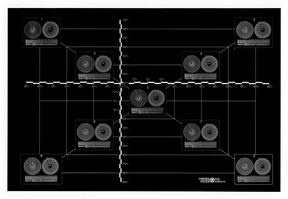

I make my judgements using test negatives for the appropriate format. This one is for 35mm:

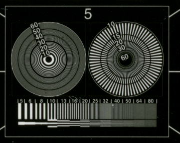

Close up of detail:
If you make prints with something like this, you'll see right away where your lens fails or shines, it's as clear as day.
I find wide open, the corners suffer. That's not to say I won't use my lens wide open, that's foolish. Like Bob says, for a mural print, or a lith print, I'll often use it wide open. The extra light is absolutely worth the trade off. I had a few mural rolls of Fotokemika Emaks paper - man was that stuff slow! One of the slowest papers I remember using. So am I going to stop down two stops if I've already got a 6 minute exposure time? Probably not.
Going back to the test negative above. In real world applications, an actual photograph, the differences in aperture (with the exception of fully closed down) are pretty slight. I'll try and stick to the sweet spot, but will use whatever aperture gives a useful exposure time.

Interesting thread here. I've read in the past that enlarger lenses used wide open is optimal. Obviously this assumes glass carrier, aligned enlarger, etc... I've never found it to be true. This is with more than a few 6-element lenses, and a few APOs. I consistently found that the sharpest prints were made 1 or 2 stops down. Without exception, the worst results came from a lens full stopped down - I'd change bulbs or switch to a longer lens before using my lenses at f16 or f22.

Close up of detail:
attachment.php
