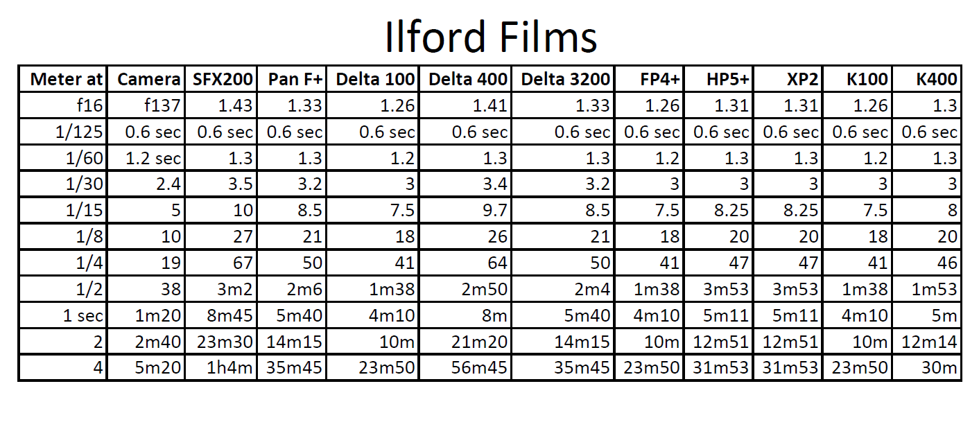

I shoot Ilford SFX 200 behind a #25 red filter at E.I. = 25 and at E.I. = 6 behind a IR720 filter.
The reciprocity failure correction number given by Ilford is 1.43. This means for measured exposure times more than a couple of seconds
take that measured exposure time to the power 1.43 to get the corrected time.
Good luck.
I made this table with their reciprocity numbers for this specific camera RSS 6x9 (f137). I'm just not sure where the failure begins. That is not on any datasheet. I had that information in the past when I sold my Zero I gave it to the buyer. So your guess is as good as mine as to exactly what point reciprocity failure occurs. I believe this would be around 1-2 seconds, more towards 2 seconds being the failure point where meter no longer provides the right exposure time. I also posted this in the Pinhole forum in case anyone else can use it.
Also you can see easily that SFX is the worst film to work with for long exposures. That factor is worse than Delta 400 which I have always called out in the past. So If I play with SFX and pinhole, I'm going to be waiting a long long long long time to bracket my shots :smile:
