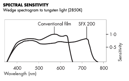

Hello everyone, looking for advice from shooters of Ilford SFX 200.
I'm just now hopping back into analog world after over a decade and plan on using some Ilford SFX 200 film in a pinhole camera deep in the forest. I want the lightening or highlighting of the forest greenery which adds a lot of interest, and the darkening of skies seems pretty neato too. So, I bought a camera (RSS 6x9 F - f meaning filter ring) and on the Ilford film datasheet it shows a table of filter colors. Prior to reading the datasheet I read online from many people that I should use a Red 25a, so I bought one. Now I look at the datasheet and see there's a 29 "Deep Red" and a 89B "Very Deep Red" and I'm wondering if maybe I should have selected one of them instead because I plan to shoot forest scenes while backpacking and want the definition of greens to be prominent. Ilford says "The redder the filter, the more dramatic the effect" so is this a go big or go home moment where I should acquire the deepest reddest filter possible to get the effect I want?
The 25 filter has a filter factor of 2.8 but -1.5 stops
The 29 filter has a filter factor of 3 but -1.66 stops
The 89 filter has a filter factor of 16 but wow, it's -4 stops. On pinhole this could be either disaster (fogging of the wind rustling the leaves) or sublime (mountain creek)

The 89B is the equivalent of the R72 which is the filter for a film like SFX 200 if you want an infrared effect of white foliage. The other filters will help to produce black skies but not really produce the full IR effect
Are you hoping to get this look when you say you want the definitions of greens to be prominent? If you only want to lighten green foliage to make it different from the brown bark of the trees then a green filter will achieve this
If you are seeking the IR effect then you are right that the long exposure will cause motion to show on the film as blur

I shoot Ilford SFX 200 behind a #25 red filter at E.I. = 25 and at E.I. = 6 behind a IR720 filter.
The reciprocity failure correction number given by Ilford is 1.43. This means for measured exposure times more than a couple of seconds
take that measured exposure time to the power 1.43 to get the corrected time.

Oh thanks so much! I was looking for this. I got the datasheet but if it's in there I didn't spot it. Where do you get this information from? I want to get it for all their films. I used to have this information years ago but when I sold my Zero Image pinhole I sold it with all this historically proven charts for exposure times for all configurations of my camera. I had every Ilford, every Kodak, every Adox, every Foma and Bergger BFP 200.

Ilford SFX is a near infrared film, not a true infrared film if my memory serves me correctly. I used to shoot it with a Red 25 and I would dead recon the exposures, not rely on the cameras meter. An ISO of 25 sounds about right with the Red 25. Been a loooong time since I've used it though.

I found that the difference in results between a standard dark red #25 and an R72 filter used with either SFX or Rollei IR films was minimal. So, I would suggest that if you pursue using SFX with a filter that you just got with a #25 red. It will make it much easier to get good exposures, especially if you choose a pinhole device. With a regular (lensed) camera, the #25 red VS the R72 will be the difference between being able to make hand-held exposures, VS using a tripod.

To achieve the most pronounced "wood effect", the amount of exposure is more critical than your choice of filters. As others have explained, overexposure increases the "dreamy" IR effects you can get from SFX. Its not quite as easy to achieve as it is with the Rollei IR, but very close.

I believe that the 720 filter is mostly beyond the reach of the SFX 200 and you will be disappointed with the results. Look on line for tests of the various IR films with the same scene with different filters. Also look at the data sheet below for SFX 200 and its spectrum response.

Sirius, I am pretty sure that those shots I have seen with the R72 on SFX have been the only ones to capture the "Wood effect" which I cannot recall seeing captured by the red 25 and certainly I have never managed the "Wood effect" with a red 25.
However retina restoration suggested that you get close to the full IR effect with overexposing with a red 25 which I have never done so I have asked some questions
There is a misunderstanding that near infrared is not true infrared.
It absolutely is.
Anything over 700 nm is well and truly infrared.
IR is just such a large band up to microwaves, that it has to be split up into near, medium and far IR.
Wood effect starts right around 700 and Rayleigh effect has planed off about as much as it will there too.
