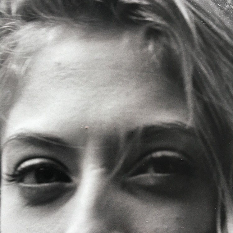

Dear people,
How can remove a little but annoying, black spot, on a FB final print, glossy paper?
Reading the book of Tim Rudman he said, to scratch it. But should I retouch by color?
Maybe the best thing is to leave the print how it is. What you suggest?

This is the spot... but the ensemble view is not very easy to notice it.
