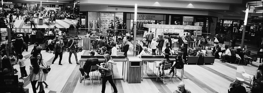

I shot my first roll of Tri-X since I dont know when, maybe 7 years ago. The results are showing very high contrast and I want to know what I could have done to tame this. The literature from Kodak on how to develop this film are woefully insufficient for users of HC-110. Only dilution B is listed and the time is just too short. Useless. The Masive Development Chart has all kinds of times with such a wide range of variables that nothing seems definitive.
I shot this film at ISO400, and developed in HC-110, Dilution E for 7 minutes at 20 C. Continuous agitation for the first minutes and then 10 seconds every minute for the remaining time. Should I have done less agitation with a longer development time to tame the contrast?

By the way, I don't think your photo is so contrasty as to make it objectionable.
The floor is washed out a bit, and the shadow detail is not quite there, but perhaps printing on lower contrast paper will solve the problem.

If the shadows in the picture show everything that is available on the negative, then you are under exposed (for the development used), and a little over developed.
Reduced agitation will lower contrast, and it will permit the shadows to develop further.
Increased dilution will also lower contrast.

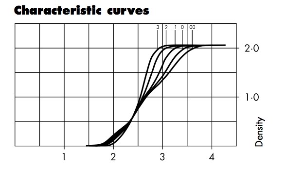

You need to match the film development to the paper grade. You can change both.

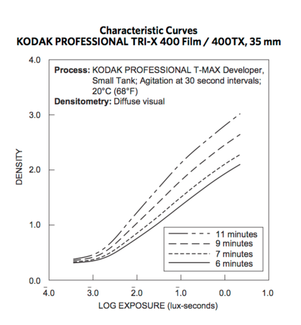

The "conventional wisdom" is that you can reduce contrast by diluting the developer more and increasing development time. It doesn't really work with general purpose developers, so I'm saying don't do it. Keep it simple. Simply decrease development time to decrease contrast. Don't mess with dilutions unless your development time ends up being way too short. If 7 minutes gave you too much contrast, try 5 minutes.

I just consulted my Kodak Darkroom Dataguide which I used all too long ago in high school. It lists HC-110 dil B with Tri-X as 5.3 minutes at 68F, agitation for 5 seconds every 30. My initial agitation was only for 15 seconds. Lower contrast (one paper grade) could be obtained with only 3.6 min. of develop time.
developing times less than 5 minutes have a chance of yielding poorly developed unevenly developed negatives..

I have done tons of rolls of Tri-X in HC110 dil B and never encountered uneven development results. I fail to see where Kodak, one of the great conservatives in process control, would recommend a combination of developer and film when it is prone to issues for the majority. Plus-X at normal contrast was even shorter times than Tri-X...3.6 mins for Plus-X to have normal contrast.
Page 3: HC-110, dilution B @ 70C development time, 3.5 minutes.
Right below that chart it says this, "Development times shorter than 5 minutes may produce unsatisfactory results."
See why I was confused?
http://imaging.kodakalaris.com/sites/prod/files/files/products/f4017.pdf
