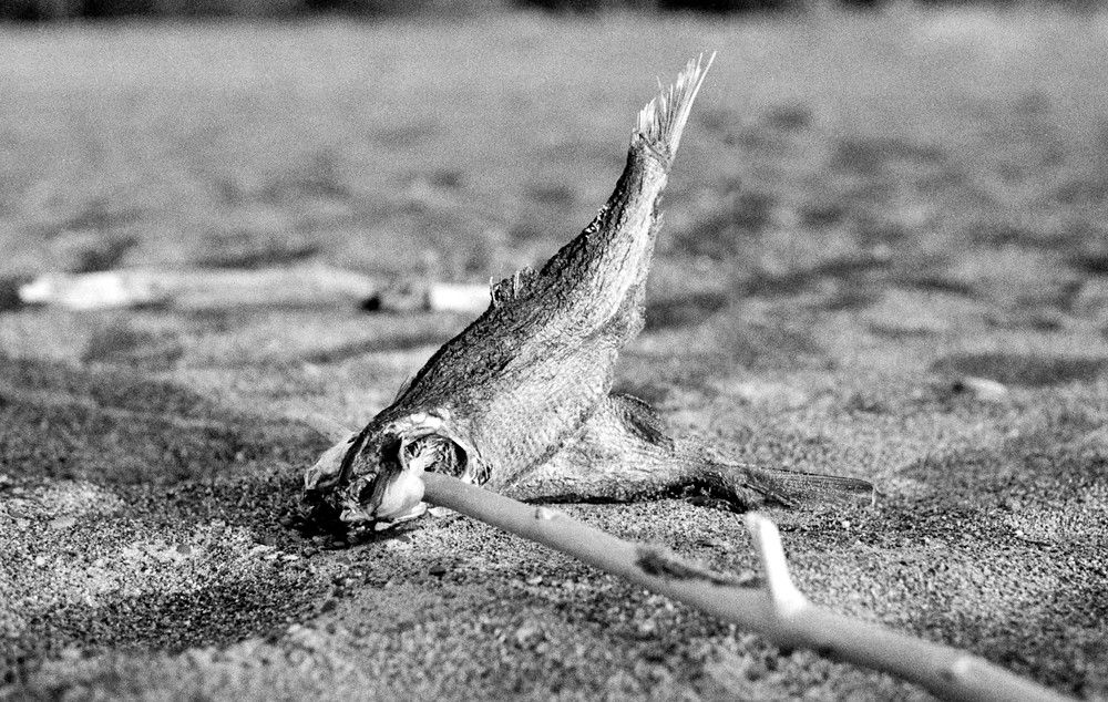

I spend a lot of time at Presque Isle State Park in Erie, PA, shooting pictures on the beach. I get some good shots but find it hard to get really good pictures when everything is the same color or value.
I try to use light and shadow to show texture or detail but, when everything is sandy gray, it's hard to make a subject stand out.
Fish-Kebab by Randy Stankey, on Flickr
Here, the fish is brownish gray. The sand is mostly gray. The branch is steely gray.
I've tried shooting scenes like this before, using different exposures or waiting for the light to change but I never seem to find the right combination to make things stand out.
I wonder if there is a filter, a different developing technique or some other strategy I could use to make a merely "good" puncture better.
Does anybody have any hints?

I took a second look at the image you are not pleased with and thought it would be helpful to see one that you like as well. Some times the place or time influences a shot and viewing it at another time you wonder why you ever took it to begin with. To me the one you are showing just doesn't work (I've got plenty of those too especially being somewhere I won't be able to return to - hey, it's just film). IMO the dark area at the top is not necessary and could be cropped, the fish and sand beside being of similar tone are very similar in texture and the light stick coming to the lower right corner is distracting. The sand could be lighter in printing with less exposure and contrast and burning the fish with more contrast than the sand to make it stand out and crop so the vertical branch doesn't show.
My approach when finding a subject of interest would be to photograph it from different angles and use appropriate filters as well as no filter and perhaps with different lenses. If possible, spend time pre-visualizing what the finished print will look like. Once you have thoroughly covered your subject you can pick and choose the negatives best represent what you saw.

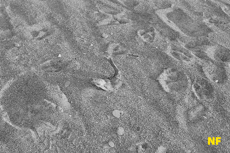

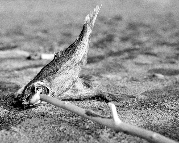

I made some test shots with different filters.
Same roll of film: Legacy 400 + Diafine.
Same location but, unfortunately couldn't do them all on the same day. They were done at the same time of day, though.
Scanned them all from the negative using batch scan with same settings.
Imported to Photoshop with same settings. No post processing except cropping and labeling.
Seems like the results are much as you guys predicted. Similar effect between Y2 and R2.
I think I like the red a little better.
When it comes down to the end, I guess I'll have to size up the subject matter and decide what filter to use based on its color.
Probably should get a green filter while I'm at it, eh?
