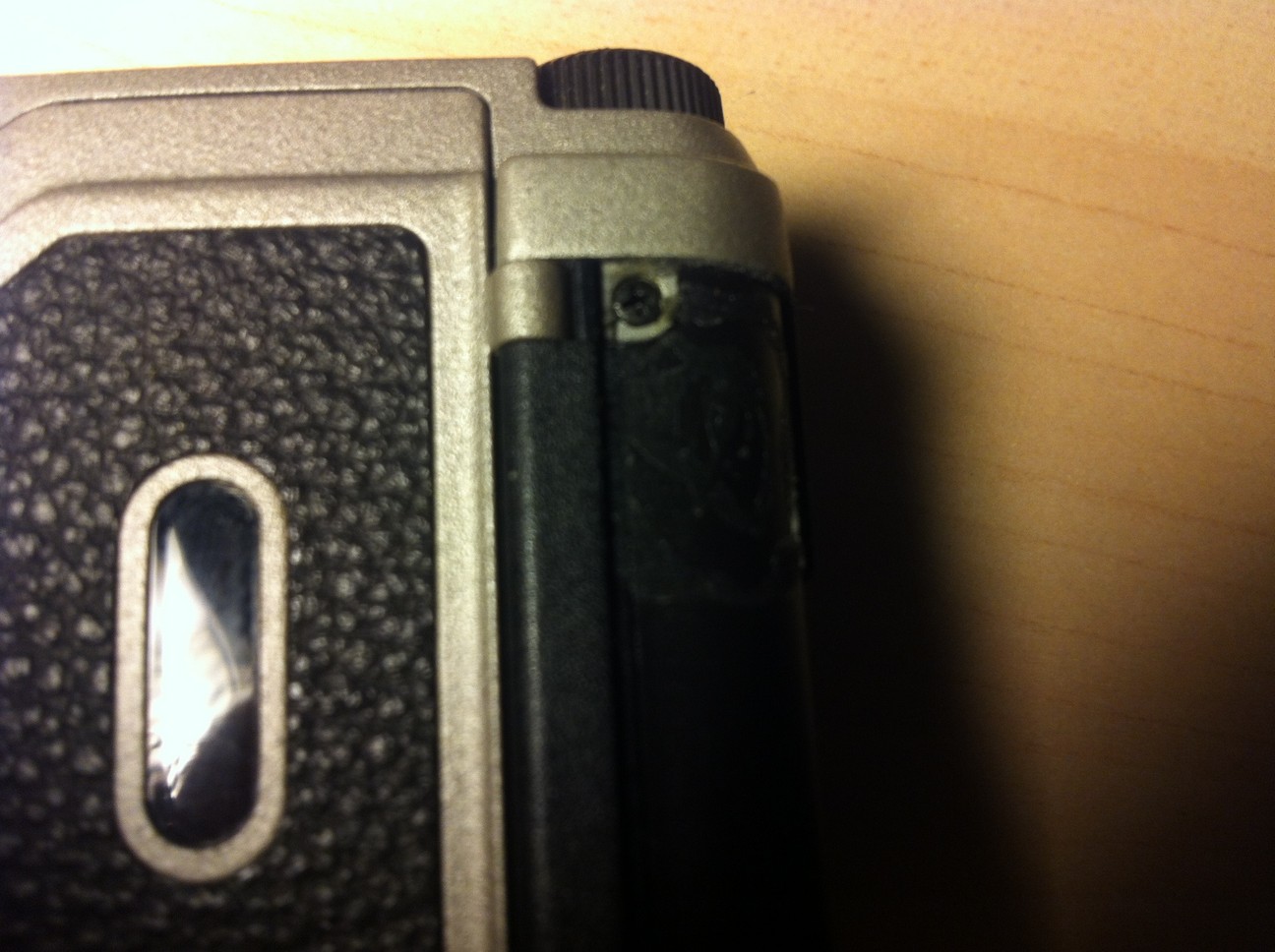

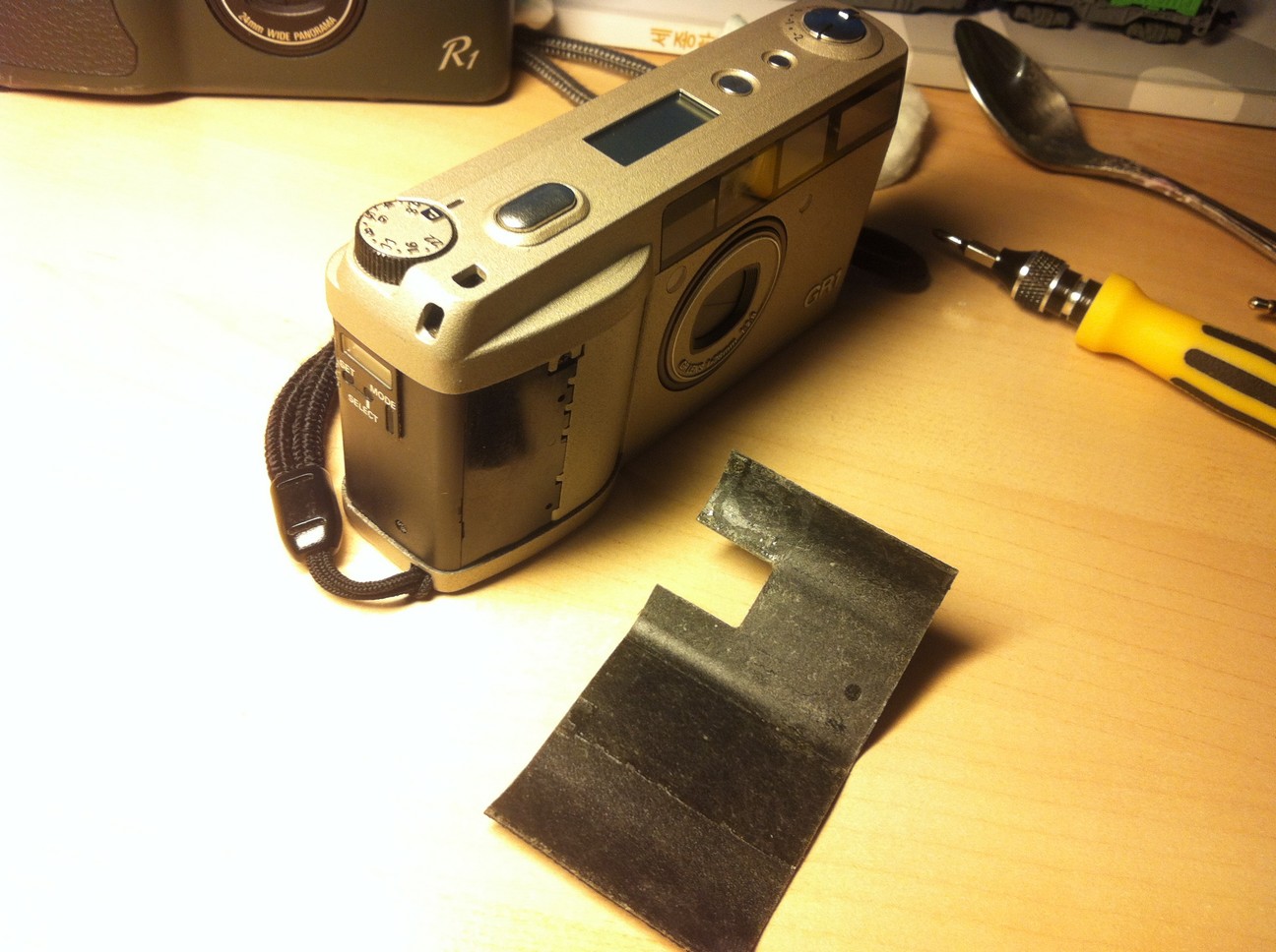

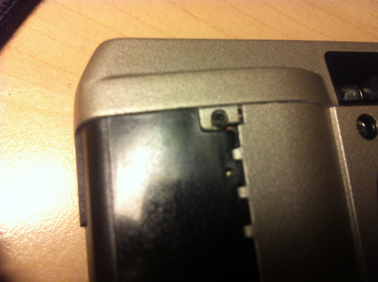

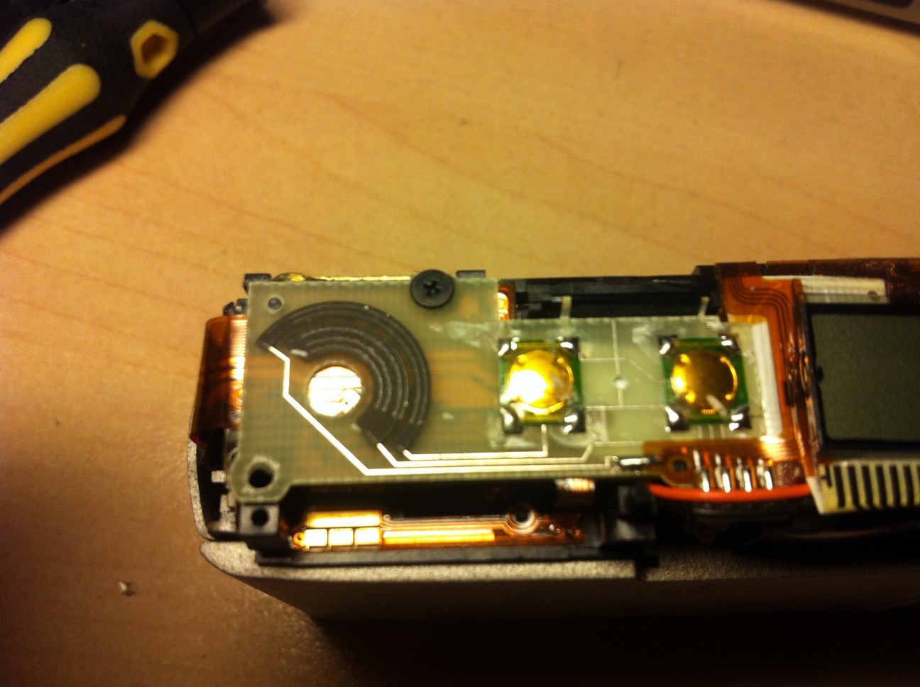

I solved it using just some pressure to ribbon cable connection points.
I made all the main photos to help other guys how to open the camera.
Just one notice - Dont lose the small rubber dome button which is responsible for Rewind.
Pictures:

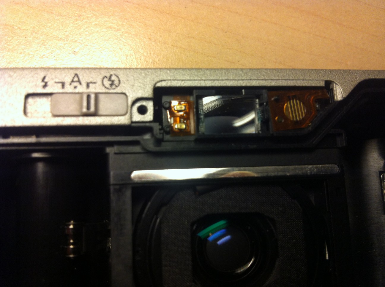

...i have some problems to identify which is the ribbon to replace...i'm in front of the disassembled camera: i look under the LCD and..? the ribbon is the black one under the LCD ? please, help...
TimmyMac
Apr 12, 2010
311
Guelph, Onta
It's the ribbon front and centre in your first photo. You need to follow it underneath the flexi-PCB which is visible in your second photo immediately under the LCD. The LCD ribbon goes under that and then attaches to the rigid PCB below. It's really tricky to get it off - you have to bend the flexi-PCB out of the way GENTLY.

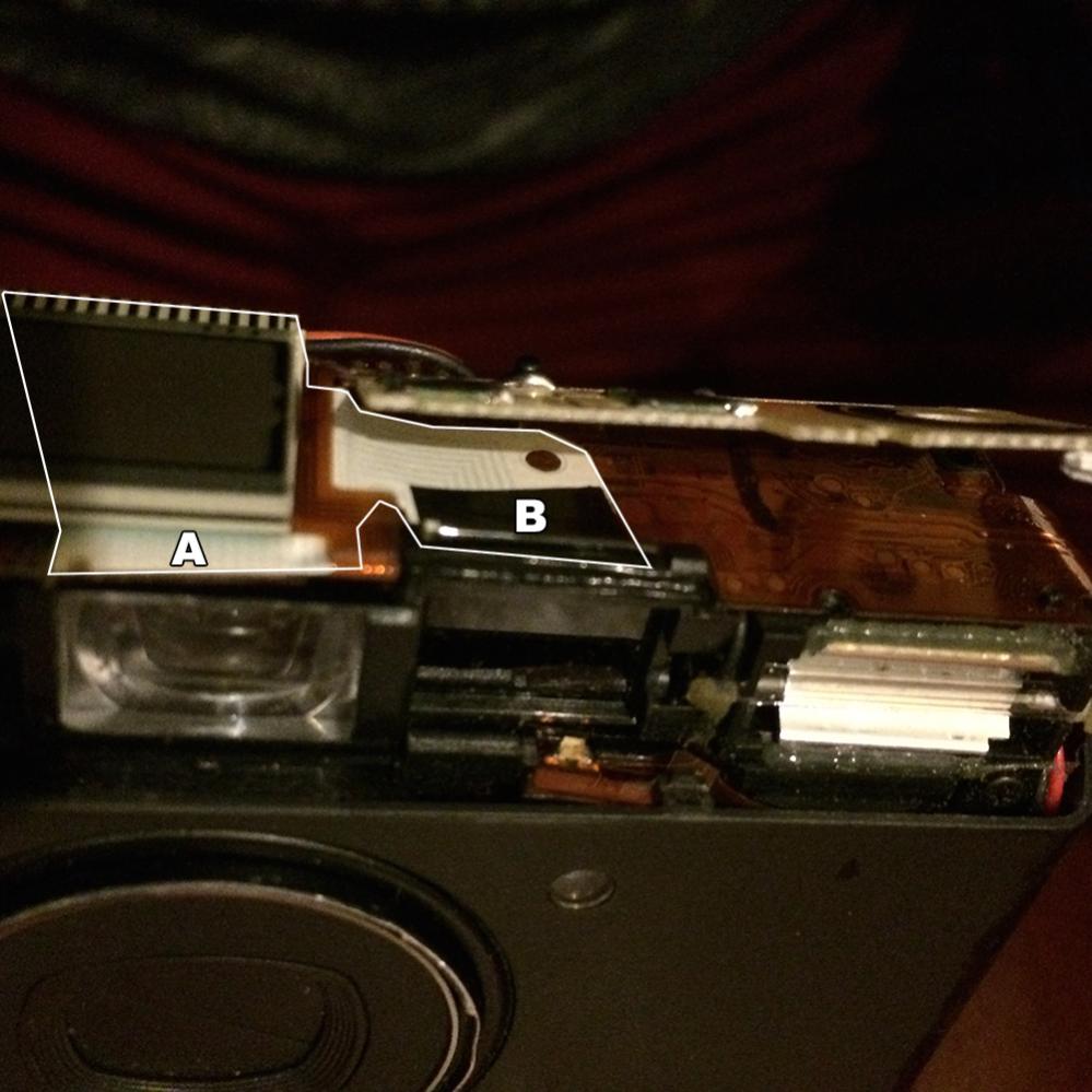

I'm attaching some photos to hopefully gain some clarity for the above tasks. I've added some labels to make sense of things:
  • White Border: The full 'ribbon cable'
  • A: The 'left' side of the ribbon cable, when the camera is pointing at you
  • B: The 'right side of the ribbon cable, camera pointing at you
The way I understand TimmyMac's instructions is:
  • beneath side A is where the conductive rubber strips are
  • side A should be warmed and detached from the circuit board underneath
  • beneath side A you should clean the area and use the 3M adhesive to re-attach the ribbon cable to the circuit board
  • side B should NOT be removed
TimmyMac, is this correct? I've never fiddled with electronics so I need more of a visual guide.

It's been a while since I did this repair and my GR1 has since gotten the clicky-shutter problem which also seems to be pretty common - so I haven't used or seen it in a while. From what I remember, the scotch tape is to be removed as it prevents you from getting at the ribbon cable attachment spots. Spot A is the attachment for the main ribbon cable, which branches to the main LCD and also to the viewfinder LCD. Spot B is the attachment for the viewfinder LCD.
*disclaimer: this is from memory of a repair done a long time ago!
