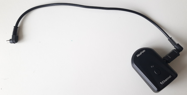

I hope I saw this earlier. I bought the wrong jack, 3.5mm, I am going to exchange it tomorrow for a 3.5mm.
Sorry, to clarify - the cable I use on my wireless sync has a generic "x-contact' plug on one end and 3.5mm jack on the other. The 2.5mm is what the wireless trigger needs, so I'm using a 3.5mm to 2.5mm adapter (which sucks, but it works most of the time at least). This is the whole 'setup':
X-sync contact to the left, the cable ends in a 3.5mm jack (90 degree angle), the thick stub is a 3.5mm female to 2.5mm male converter that plugs into the 'NiceFoto' (ain't that nice) generic wireless trigger.
