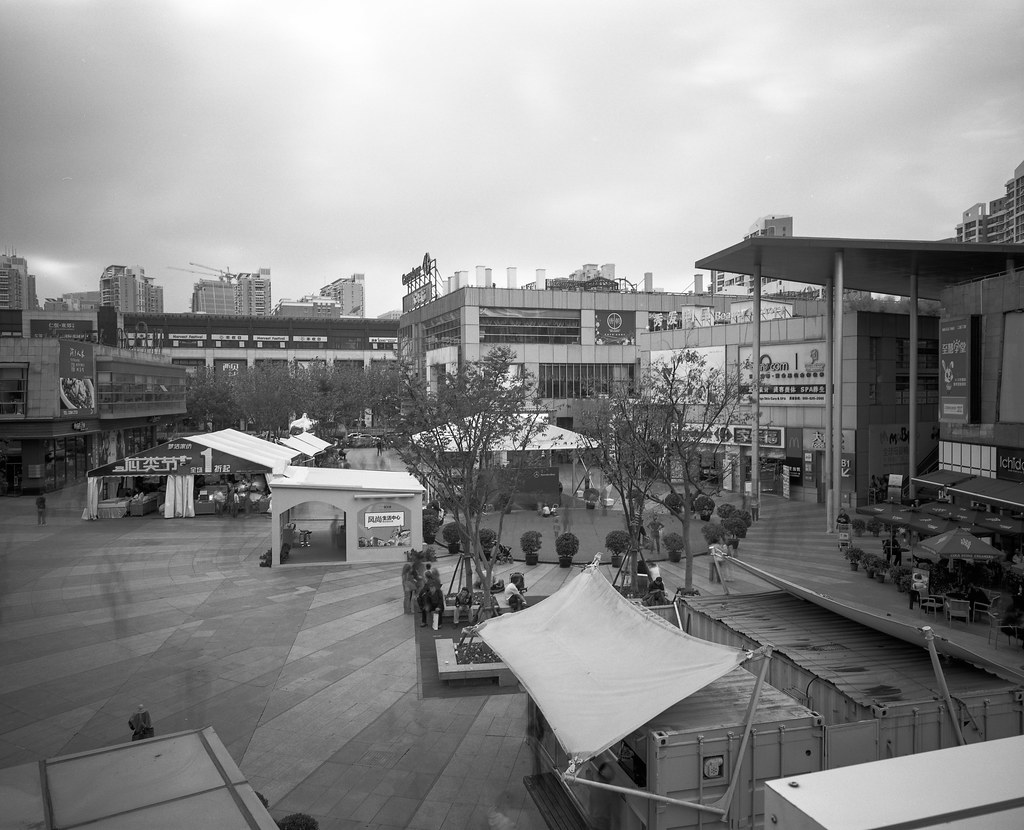

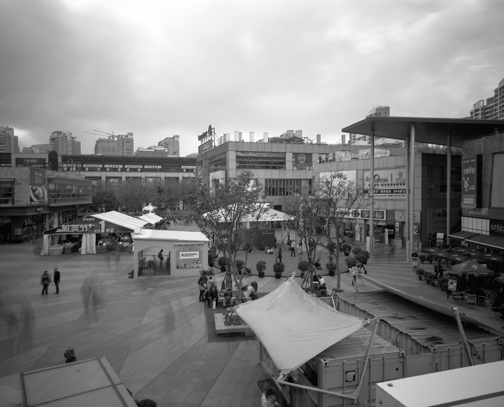

Here are the results from my first experiment, using a 6 stop ND filter. Sadly, my $100 filter is not enough to make the people disappear. A 10 stop filter would have worked I think, but I don't have $100 more to spend on filters.
This is an 8 second exposure using Neopan Acros.
This is a 16 second exposure, the most I could get with a six stop ND filter and using f/22.

I agree, there are a few other things that I can do and get better results. The problem is if I want to try this in good daylight. I struggled to get to 16 seconds while the sky was overcast and it was late in the day. Mid day sun during a cloudless day will need a much more powerful ND filter.

My images taken at 16 seconds shutter speed are almost free of people. That was with a 6 stop ND filter. If I bought a 10 stop ND filter as I planned, then my shutter speeds would have been up to 4 mins long. An exposure of that length would have caused every last moving person/car to be eliminated from the scene.
