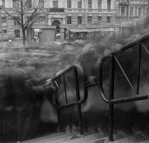

Did you mean this one? I love this image.
attachment.php
(Alexey Titarenko - City of Shadows - St. Petersburg, Russia)

YES !
thank you :smile:
I think he made multiple exposures, mounting up to the "normal" exposure time needed for a single shot.
A sort of time laps, if you like.

Disappearing people are par for the course on long exposures with a pinhole camera. But a successful "disappearing act" depends greatly on having every single person moving about constantly, not stopping and looking around. It's otherwise very simple to digitally remove people, and that effect is something that is a lot more common than the traditional (analogue) method of a long exposure and planned approach to nulling movement.

I suspect that this solid stream would show up as a kind of solid streak a bit like the example already given of people on the stairs, no matter how powerful the ND filter i.e. the traffic/people density means that it is in effect a stationary object.

Look back at that subway shot of the USSR. There's a hand on a handrail clearly visible in a few places, it was obviously holding the rail for a step or two, then moved to the next spot and again.
The hand itself was probably already a stop or two above the brightness of the relatively dark grey coats, so besides being there for not much time it's shown up easily, about the same brightness as the background.
So in short, I don't know, try to aim for at least 90% background 10% people/cars/whatever in terms of time in one spot, probably even 95% or better if you can.
Bert thank you VERY much for this, I hadn't seen Titarenko before and it's rather impressive stuff.
