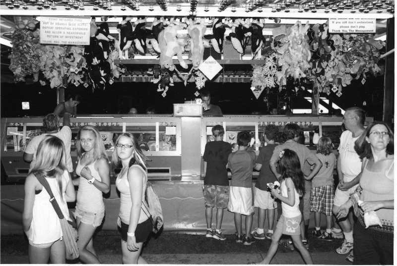

Maybe someone can help me. Here is one. Is this the "D76" look or the "T-Max Dev." look? OR is it the "Tri-X" look or the "Fomapan" look, or the "HP5" look, or is it the Ilford MG FB look or the Kentmere look, or is it the Dektol 1:3 look or the "Ilford Multigrade Liquid Developer 1:14" look? Perhaps the photographer printed it to look like his own work or others in a series?

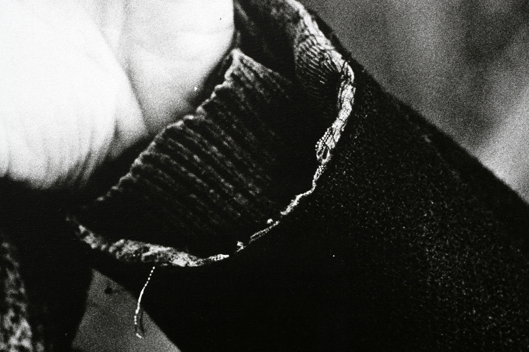

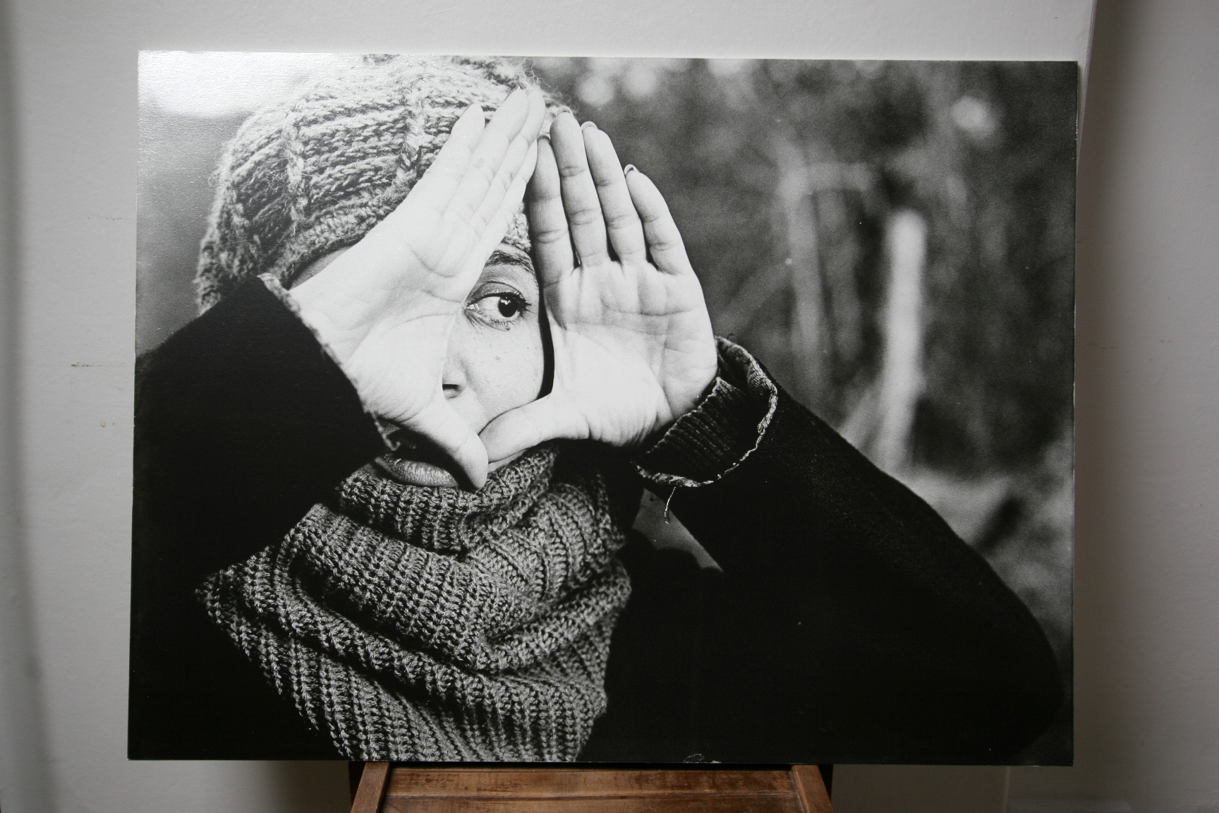

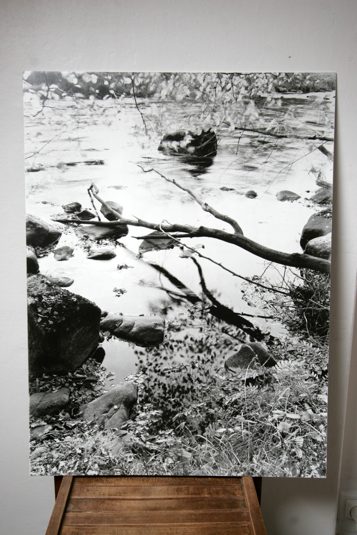

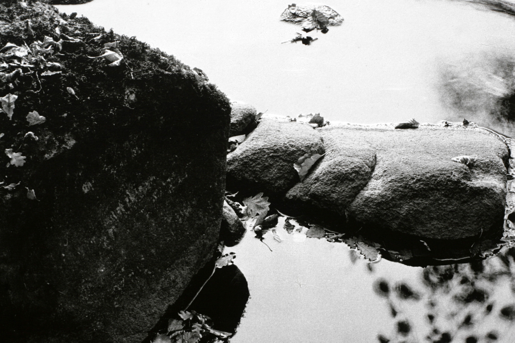

here for example.
one is tri x, the other is fp4
its like night and day at least to my eyes..
same dev, both on rollei emulsion handcoated on plywood.

even without regarding the subject. both shots were done with the same lens, same camera, within a few hours, same day during a long walk.
can you not tell a difference in grain, microcontrast and overall feel therefore?

Post #31, night or day? Tri-x or fp4?
the grainy obe is tri x, the one with no discernible grain fp4. first is gritty and steep, the second mushy, softer and wider range. are you making fun of me?

sorry i misread you.
cannot tell much from this small piv/scan or what.
as i cannot see grain i would nt think its tri x.
otoh i havent used tri x with flash.
hard to tell.
my examples tall more clearly of a comparable difference
