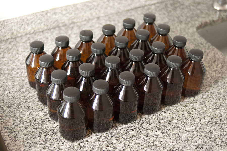

I kept the stock D-76 in this bottles, just to the top. They are 24 bottles, for 24 1:1 developments, or 12 1:0 ones. So the liquid was never exposed to air.
The bottles were kept in a box. And the box in a closet, against the floor. Temperatures were far from ideal. Well, in winter I guess it is okay. But in summers, even in the box in the closet, I think it is hot, at least 25ºC or more. But I read somewhere that the most important factors were air and light. And the liquid wasn’t exposed to any of these.
I also read somewhere that D-76 turns brown sometimes. Mine looks the same as before, as far as I remember. I mean, I don’t know if it is a tiny bit more yellowish or transparent, but it seems to be the same.

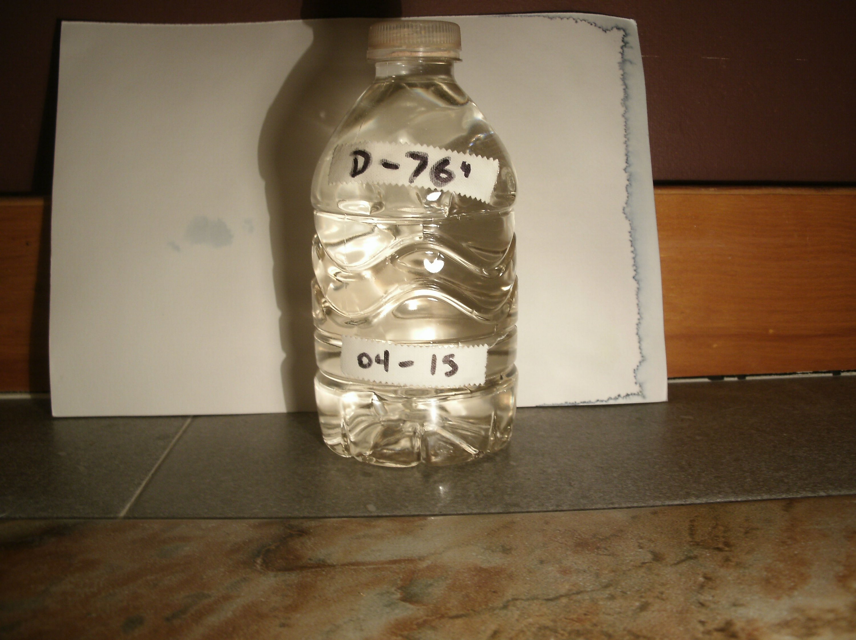

I've never seen D-76 turn color, always clear, even when completely dead.

Yes, I speak with experience. It's always best to do a clip test with oldish D-76. I've never had any D-76 turn brown, only Dektol paper developer.
005.JPG Last bottle from this batch.
