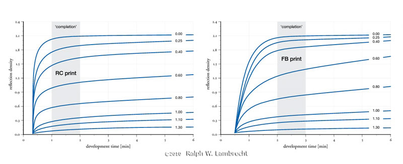

Well, maybe we need to define what is meant with 'top out' or 'develop to completion'. If it means 'reach Dmax', then yes, that does happen fairly quickly. However, if it means 'no further development' for any of the tones in a print, then no, I was never able to find the point in time when development stopped with RC or FB. It seems to continue beyond highlight fogging.
As one can see from the attached graphs, development actually never stops for any print tone that has not reached Dmax yet.
The attached test results are for Ilford MGIV-RC&FB, but I have done the same test with Agfa and Kodak papers with similar results.

So my 3 min. sound about right or not long enough????
3 minutes sounds about right for FB paper. I use Ilford MGIV-FB with factorial development for which I time the first appearance of midtones and multiply this time by a factor of 6 to find the total development time. Using this method, I usually end up with 3 minutes in fresh and up to 4 minutes in nearly exhausted developer. Factorial development is useful to compensate for developer exhaustion as well as for temperature fluctuations.

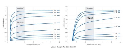

Very interesting Ralph, thanks for posting this, I didn't know this, or at least hadn't seen it so well shown.
However, two questions:
- To what extend might safelight fogging influence the results you graph out? Are these graphs from papers developed in absolute darkness? Considering no safelight is actually truly "safe", I would expect at least part of this issue related to slow safelight fogging with the extended times in the developer.
- Am I right the "0.00" value / line is for the "blacks", while subsequent higher numbers are the negative densities of the "highlights" in your graphs (just to make sure I do really interpret them right)?
Marco
Marco
Your interpretation of the values is correct. My (red) safelights are tested to be 'safe' for up to 32 minutes. These tests show developing times up to 6 minutes. Consequently, safelight fogging can be ignored.
Ralph, thanks for the answer, your remark does make me ponder a bit on though.
I started thinking: in most cases, safe light testing is described by having a piece of DRY paper (so not lying in the developer) being exposed to the safe light's light for an extended period of time. This mimics working conditions during the exposure and any subsequent burning actions.
However, now wondering about it, how sensitive is paper to fogging while being submerged in the developer? I could imagine there is a difference... although I can't really remember ever having read about it.
Is there something you can say about it: fogging of a dry piece of paper versus fogging of a piece of photo paper emerged in developer, both receiving exactly the same amount of light?
Marco

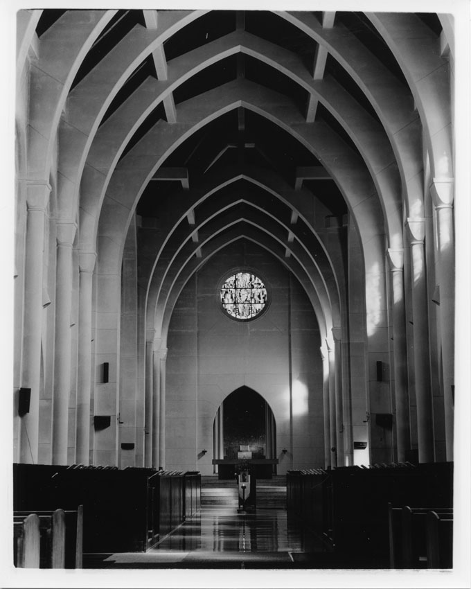

OK, I took the sage advice from this forum. Mixed fresh Dektol and did a test photo. It was the tried old Dektol that was killing me.
Of all of the prints I have done up to this point, last night was the first time I feel like I achieved "some" success. What do you think of the "print" ? The composition is fair but I think I achieved some good tonal values, enlarge focus etc.
No touch up of any kind has been done...this is a straight scan.
Learning to scan prints opposed to negatives needs some work...
Please C&C
stradibarrius:
Looks good to me.
Most importantly, how does it look to you!
The scanning process can interfere with discussions of this type, but if I was going to evaluate the print itself, I would be looking at the following issues:
1) Are the details and contrast in the mid-tones pleasing to you;
2) Do the bright parts of the image "sparkle", with visible detail; and
3) Is there texture and detail in the shadows?
Matt
