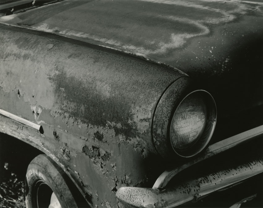

    Here is a scan of a shot made witha Mamiya M645.
    There are several issues I feel I need to work on but starting with the first one...how to get blacker blacks?
    I used Ilford Multigrade IV RC paper with a Ilford 3.5 contrast filter, 14 sec. exposure. Dektol as the developer for 3 min.
    My enlarger is a Burleigh Brooks 670 that no one seems to have heard of before. I used a Fujinon f/5.8 90mm lens.
    I tried using a #4 contrast but the print actually turned out lighter. I also increased the exposer time and the result was just darker not blacker blacks.
    My wet print experience is limited so I am in the beginner learning curve.
    Is this a paper choice or a developer choice issue?

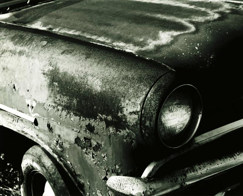

    When I scanned the negative and made a digital print, I was able to get blacks I liked.
    I also attached the digital scan of the negative.
    Before anybody goes nuts, I am trying to learn to print in the darkroom not discuss the digtal print. I only post it as reference to the blacks.

    The obvious difference in the two thumbnails is contrast. I suspect there is not as much separation in the tones in the negative but you were able to correct with the software. The issue is with the negative not the filter. If the negative is important to you try printing for the shadows and dodge or bleaching the highlights that are too muddy.

    I would say the blacks in the silver print are ok. The problem is the midtones (which look muddy and compressed) and the highlights which don't have enough sparkle. The problem could also lie with the film exposure/development as much as the printing.
    I would try to print it a little lighter (less exposure under the enlarger) and on a very hard grade, poss 5.
    Selenium toning the neg can sometimes help with separating the tones in the print and perhaps give half a grade more contrast.
    Also make sure your paper developer is not exhausted

    Try making a max black test strip through the clear film between two negatives. That will show the maximum black of which your paper and paper developer combination are possible. Then you can either expose the negative for the min/max time and see how the high tones fall; or you can expose for the correct detailed high tones (say the headlight) and see how the low tones fall compared to your max black test strip as a comparison.

    Just talking about the maximum black, a paper is only capable of going so black. You might try using a stronger dilution for your dektol or you might try using Ansco 130 to get maximum black density. A warm tone fiber paper will have a blacker black probably.

    First off--if you are using Ilford MG filters, #4 and higher need one stop more enlarging exposure than #3.5 and lower.
    It looks like your wet print doesn't have as much contrast as you want in general. You aren't getting the sparkling whites or the deep blacks you have in the neg scan, but you'll notice that you do have more detail in those areas in the wet print, so the task is going to be to spread those tones out over the range that the paper is capable of rendering.
    I'd start with a grade 3 filter and try to make a print with sparkling highlights. Make a test strip along the chrome bumper to find the best exposure to give you a little detail in that area, but retain the sparkle, and note that other factors like light leaks in the darkroom and an unsafe safelight will cost you at the sparkle end of the spectrum.
    Now if your blacks are hazy instead of solid, try maintaining the same relative exposure (meaning that if you go up to grade 4 or 5, you need to double the exposure time or open the lens one stop) while increasing the contrast, and that will give you better blacks without losing the highlights.
    Still not enough? You could intensify the negative. 8 minutes in Kodak Rapid Selenium Toner 1:3 will give you about a one zone expansion. I use this technique often to push up the highlights on a flat neg.
    Beyond that you could try printing it darker and bleaching the highlights back.
    Contrast masking will give you even more control over contrast, but that's a more involved process.

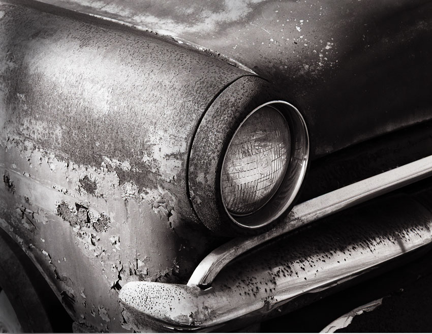

    Are these the same negative?
    Hi all,
    Is it just me, or is there simply no way these two images can be from the same negative?? :confused:
    It is not just a different crop. Look at the "shadow" at the left side of the scanned and digitally manipulated image, it is not visible in the wet Ilford print.
    It seems to me that these may be from two different negatives, the second taken when a bright sunny spot hit the car... Unless the OP did significant additional manipulations like strong dodging and burning in Photoshop, there is just no way the negatives are the same.
    Here's my variant of the Ilford wet print with Photoshop "enhanced" contrast, notice how it is different from the other image... especially in terms of where the shadows and light spots are.
    Again: these are unlikely to be the same negative... start with the same negative, and you will likely have less trouble replicating the results in the wet darkroom.
    Marco

    Looking at the reflections in the chrome, I think they are from the same negative.

    There should be more tonal range that can be yielded from the wet print. Like Bill says, the midtones are compressed and more importantly, the whole image is muddy as a result. Exposing for your highlights and adjusting print contrast for the black you want like John, and Ralph stated is the right starting point. I will also say, I've never gotten results I like with Ilford RC paper.... Without starting a flame war, I would suggest a Variable Contrast fiber paper, or better yet, a graded paper to learn with.
    Simplification is the key, and graded paper teaches you to better tailor your negs to the paper you print with. You've been bombarded by many responses and all the ideas are valid, while only a few are truly accurate for you to learn from. It would be interesting to see the neg scanned as a positive to get some better idea on the tonal scale for this image.

    Yes it is the same negative. I adjusted the curve, contrast sharpened, dodge and burned in Photoshop. To night I am going to do as John and Ralph suggested and test of MAX BLACK. increase the contast filter and exposure time and see if I start moving in the right direction.

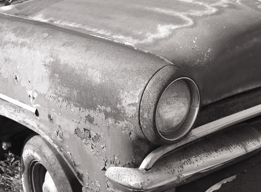

    Here is a scan of the negative with nothing done to it other than resizing it for this forum.

    Looks like this neg 'should' be capable of producing the blacks you want. Try the max black test and expose for the highlights to where that gets you.

    The straight neg scan looks alot better than the print you made, better shadow detail around the chrome bumper and better separated midtones.
    I think some of the problem could be with the rusting paint on the car bodywork having colours which black and white film can't separate and maybe might have been improved by using a coloured filter, orange maybe.

    If my Dektol was old would that cause the problem you are seeing?

    Exhausted Dektol would show a loss of Dmax and contrast, yes.
