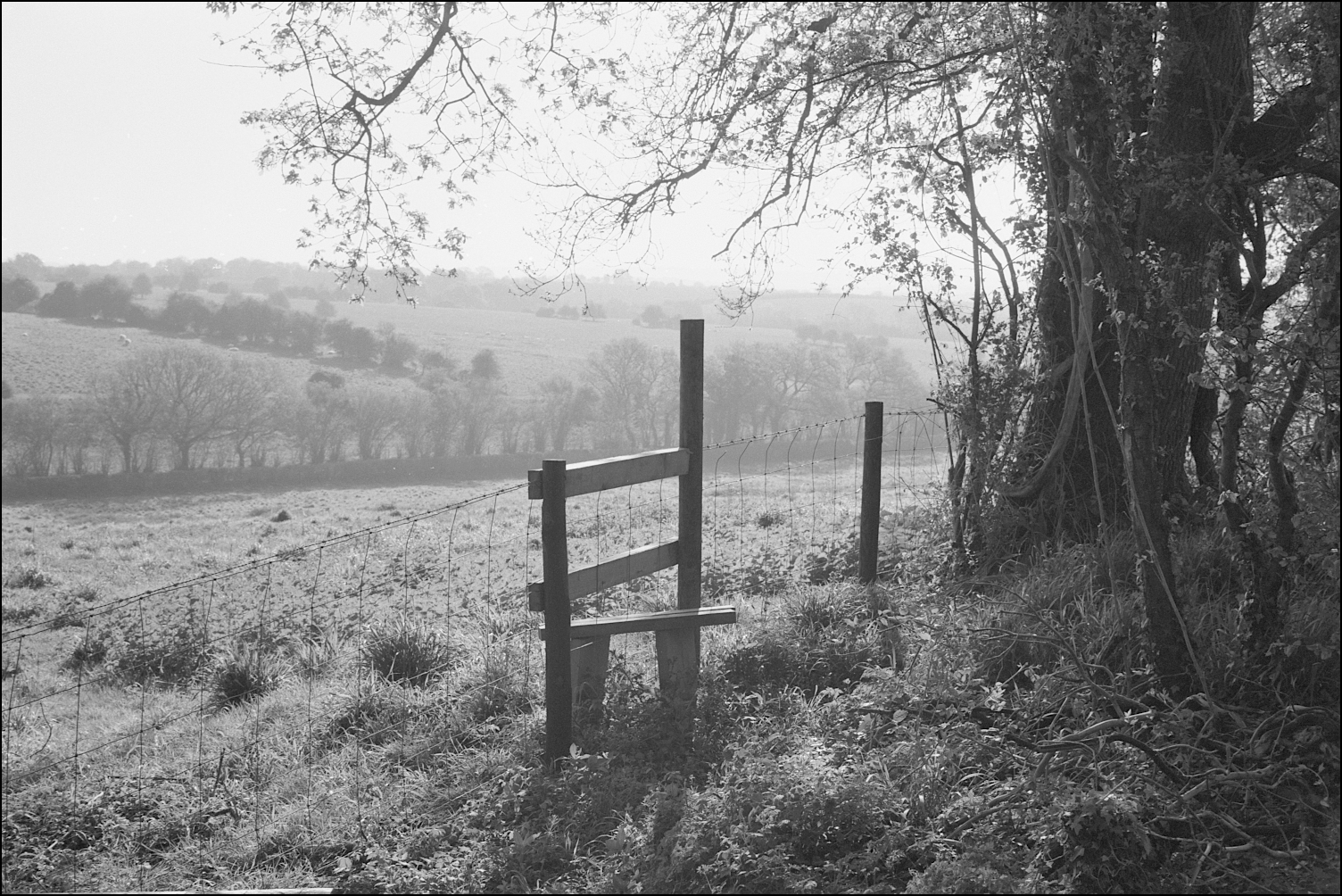

Plenty of atmospheric haze this morning - see attached.
April 23, 08:00 by the sun (3 hours after sunrise), Delta 100 (ie fully panchromatic), light yellow-green #0 filter, BT 2-bath developer, scanned from the negative. Yesterday there were sheep and lambs in the foreground but I had no camera. Today I had the camera, but no sheep.

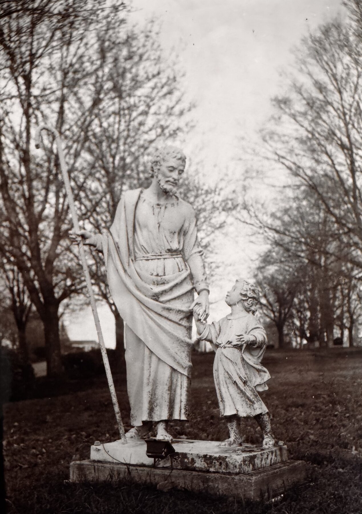

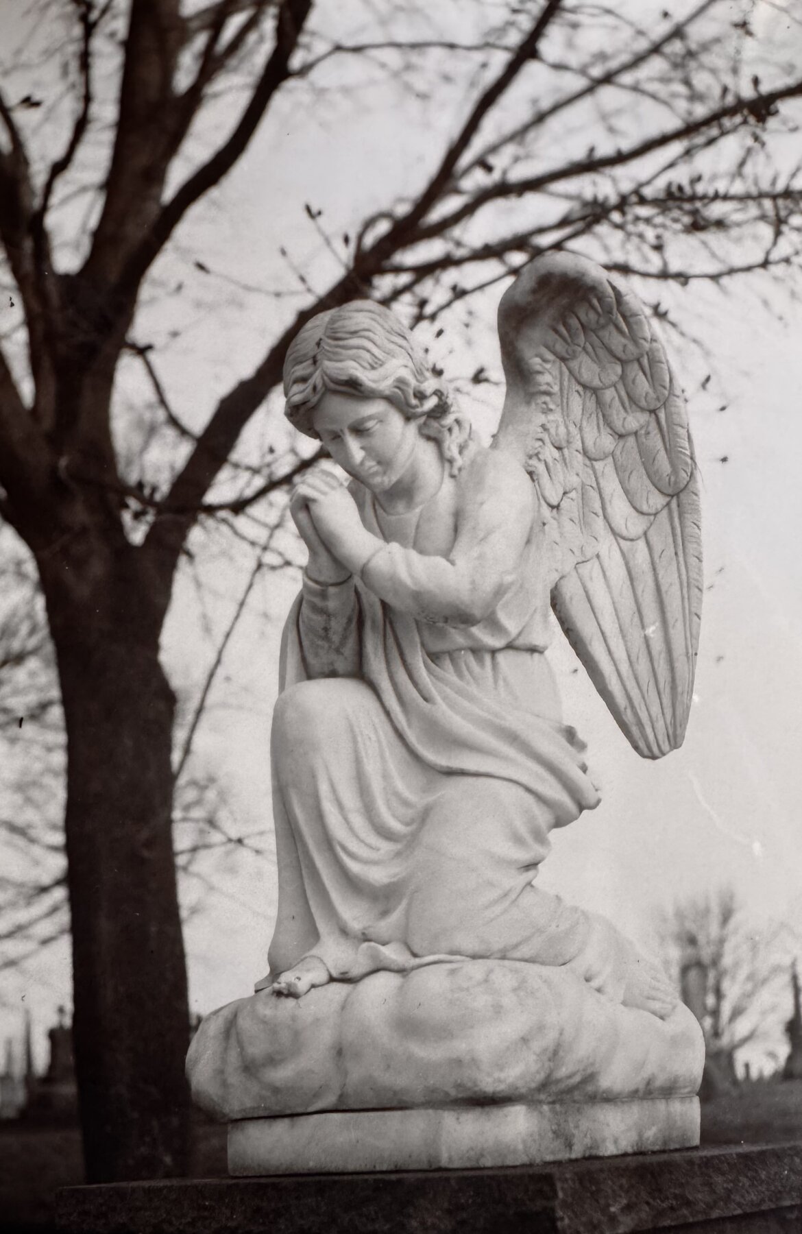

I went out yesterday morning to try an experiment. I used a very slow copy film. The camera was a 5x7 Kodak Premo and the exposure was about 12 seconds. This is a contact print (on Ilfiord WTRC and selenium toned). I wasn't after a masterpiece, but I was trying to see what the specific combination of large format, blue sensitive, and uncoated lens did. (There was no fog or haze at all, by the way.)
Interesting. Thanks for sharing your result.
Yeah, without some intervening atmosphere, you might have aimed for shallower depth of field, blurring the "busy"
distracting background even more. Atget, of course, would typically have tried to isolate the statues against a blank white or gray portion of the sky.
Yes, which would have been sensible, but I was trying to get some background in there to see how it would look - particularly something in the background directly behind the subject, to see how the contrast worked out.

Well, I wasn't trying to fake anything - just wanted to see what would show up using a film that is pretty close to an old dry plate.
What do you conclude? Seems to me you got deep featureless shadows and blank skies (both Atget-like), but no exaggerated distance haze effect.
And I think it's because there was no haze to get. So I conclude Atget got haze in his photos when it was present.

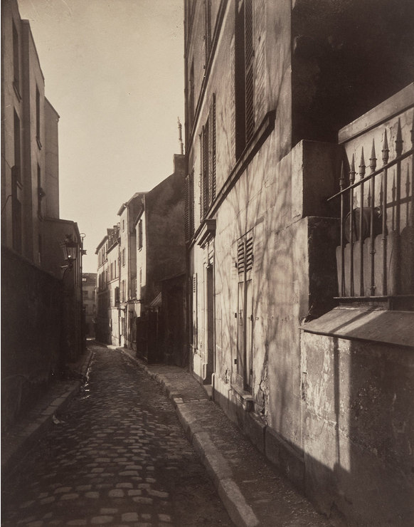

Rue St. Rustique, Montmartre, 1922
