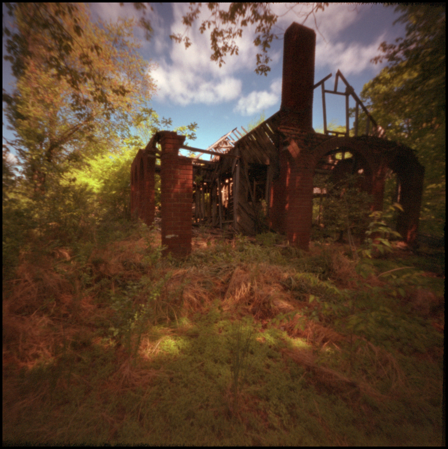

I took some pictures with a 15 years old expired film and the pictures after the developing were quite better than I expected so for pinhole can be ok. I m not expecting to take really god quality pictures. It looks interesting to use some techniques from the past and let's see what I can do.
I've got some pinhole pictures I'm very happy with that were made on some pretty old film.
Congrats! Really beautiful picture.
