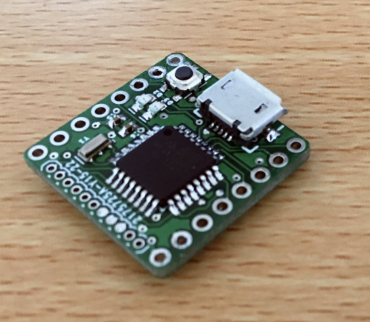

In the more radical direction, maybe some type of "resto-mod" where the meter's outer case and galvometer are preserved and the insides are fitted with a modern photodiode connected to a micro arduino which would allow a perfect software correction for the meter's scale.
The arduino programming could be simplified with a table of 1/3 stop intervals; no complex equation. Then, using your setup, find, by trial and error, the numerical value to output voltage to the galvometer for each light value in the table. That wold be pretty cool because the needle would move in fixed 1/3 increments.

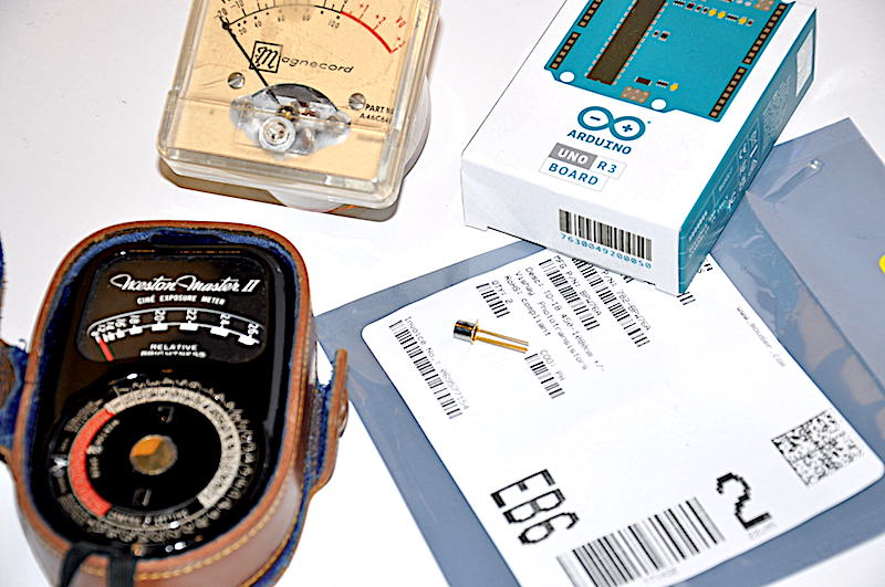

Just as I posted that above I realized I have boxes of spare parts from building the "Film Camera Tester"
I have enough stuff to make a prototype with a 'test' galvometer.
Another version would be for the arduino to 'intercept' the output from the existing selenium cell and then drive the existing Weston galvometer with a voltage to give the correct reading. Though, if going to all this trouble, I'd just replace the selenium cell all together with the modern sensor.

Looks like the Arduino, itself only has a PWM output, so some experimentation with a transistor and resistors would be needed to get the Arduino do power a galvanometer.
'The' Arduino is in fact a whole slew of uC experimenter boards, many of which also have DACs. For a project like this, you're furthermore not limited to an Arduino and can choose from any of the thousands of uC's on the market in a home-made circuit, and if that's insufficient, there are plenty of stand alone DAC chips to choose from.
But a PWM output with an RC filter will also work given the inertia of the needle.

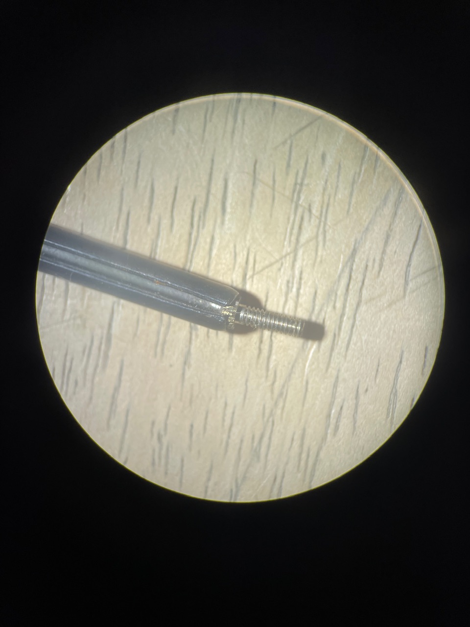

There are two knurled screws in the back behind the serial number plate. I use them as indicators of tampering because you need a special tool to open without damaging. Even when I do open it with a tool the knurls are ever so slightly marred that you can tell it’s been opened.
A hardware store split friction pin is adaptable, I used a carbide scribe to etch ribs inside and ground the outside slightly for better clearance. But if you don’t care about looks it almost works as-is.

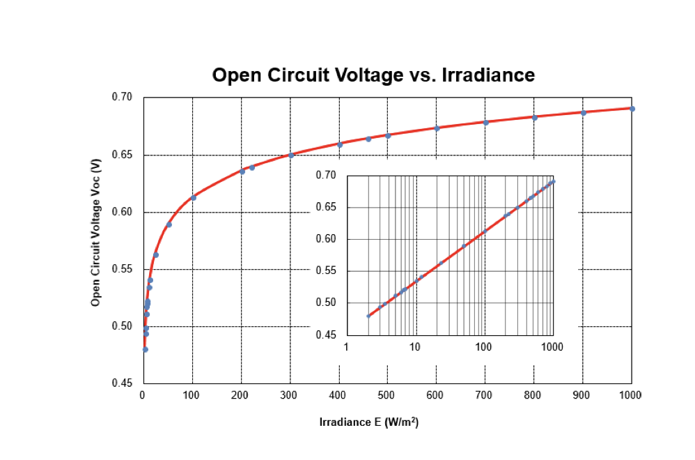

Maybe we should have a thread on replacing photocells. Have you looked at these little ones DigiKey has (KXOB25-14X1F-TR).
It is about an inch by 1/4". This is the output. Do you think that would drive a galvanometer correctly?
The voltage is log of the irradiance which is good for exposure meter. You should try and see if it can generate sufficient current to drive the galvanometer.
