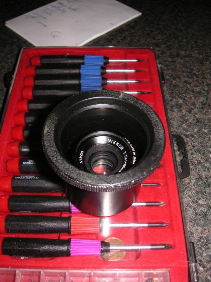

I have a EL-Nikkor 80mm 5.6 mounted in a deeply recessed lens panel for my "new" IFF Ampliator enlarger. The lens panel is very narrow and it's impossible to get the fingers in there to change the aperture. The Nikkor is, I suppose, one of the few 80mm small enough to fit in there at all.
I was thinking about making an aperture changing tool, perhaps some kind of tube that will fit the aperture ring.
Any suggestions?

Why not upside down and inside out? That is maybe mounted the wrong way round: the lens should not be in the recessed part, but on top of it.
Dont see the use of this kind of deeply recessed panel on enlarger.
This enlarger uses screw in type lens panels mounted in a turret, and the lens panel can't be mounted any other way. I don't think it would be possible to focus the 80mm on a flat lens panel.

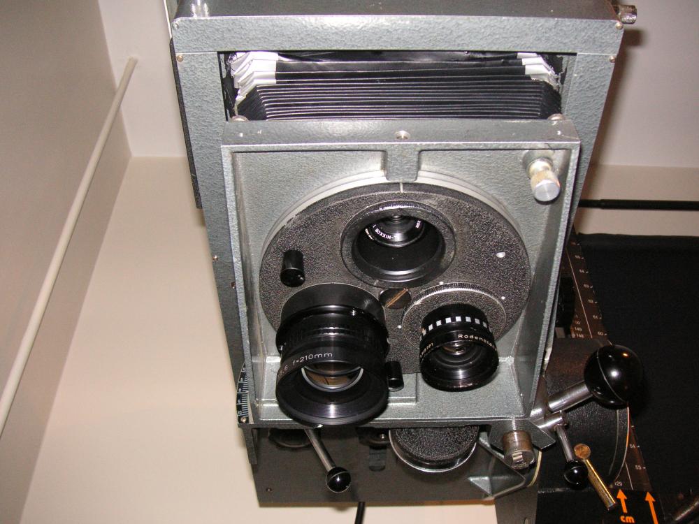

Is that not what you are essentially doing here? (in photo)
I can state with almost certainty that no self respecting engineer would design a collar for an enlarging lens. Your assembly can not be correct.
Does your cone mount from the narrow end or the wide end?
Every cone-lens extender I have used mounted to the enlarger at the wide end and the lens mounted to the cone at the narrow end (rear element towards the negative). It was an efficient way of putting some distance between the lens and negative without over-extending the bellows.
I think your cone is designed to mount a lens in the neighborhood of 360mm, minimizing bellows draw.
The wide flange of your cone probably fits the same slot as your three lens turret. Use one or the other?
There was likely an extension ring made for that purpose. Durst supplied Schneider lenses in recessed mounts complete with dedicated extenders that screwed into the front of the lens. They also had a universal fit extender supplied with one lens mounting board extender assembly.
I'm also suspicious of the assembly. My Philips PCS130 enlarger uses a reversible lens board. It's mounted so that the lens board extends upward/inward for 50mm lenses and downward/outward for 75mm/80mm lenses. (The amount of "dip" is trivial compared to what's in your photo, though.) If your enlarger is the same way, mounting a 50mm lens would require an even more recessed mount, and then the question becomes: Was the designer a sadist or just plain insane?
My advice: Mount the board in the enlarger as it is and see if you can focus. If you can't, reverse your assembly. Don't worry about the aperture ring until you figure out how it's supposed to be mounted.

The lens board isn't reversible, and if the lens was mounted on a flat board it would be impossible to focus. But the lens board doesn't have to be as deep as this one, it could perhaps be 1.5 - 2 cm shallower (I have tested). I have a feeling that lens boards for this enlarger are hard to come by, but I suppose I could get someone to make one.
I have attached a photo to illustrate how it's mounted.
