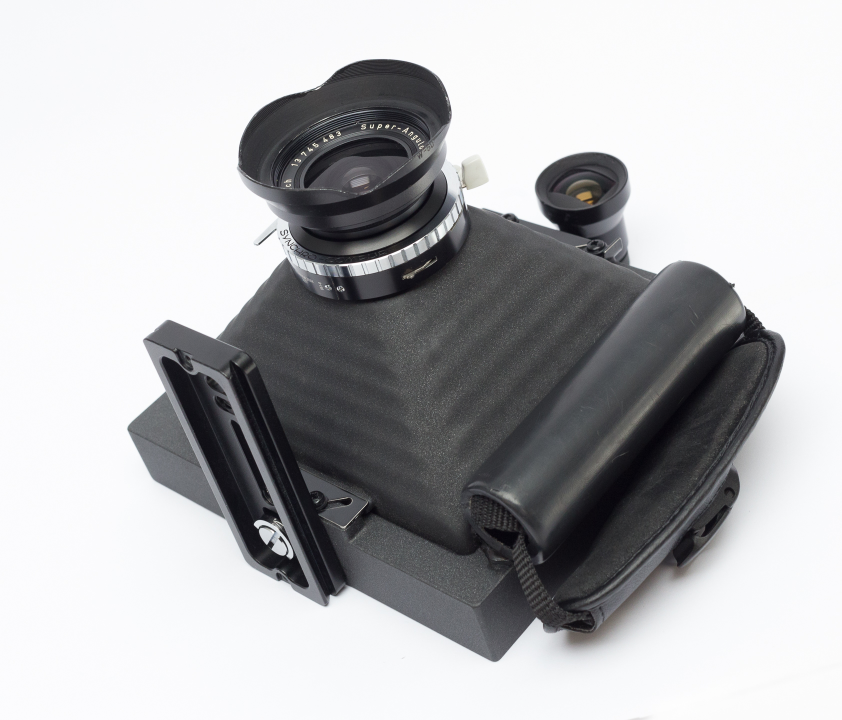

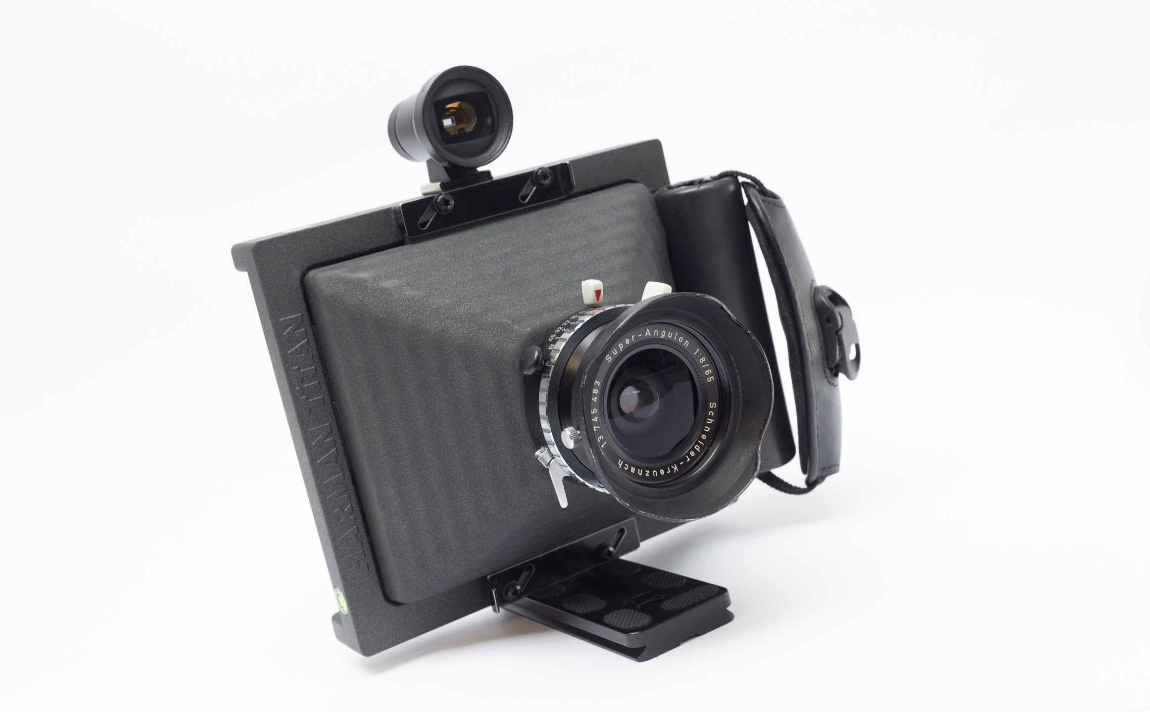

This is a great thread, here is a camera I recently built that uses a fixed focus 65mm SA.
