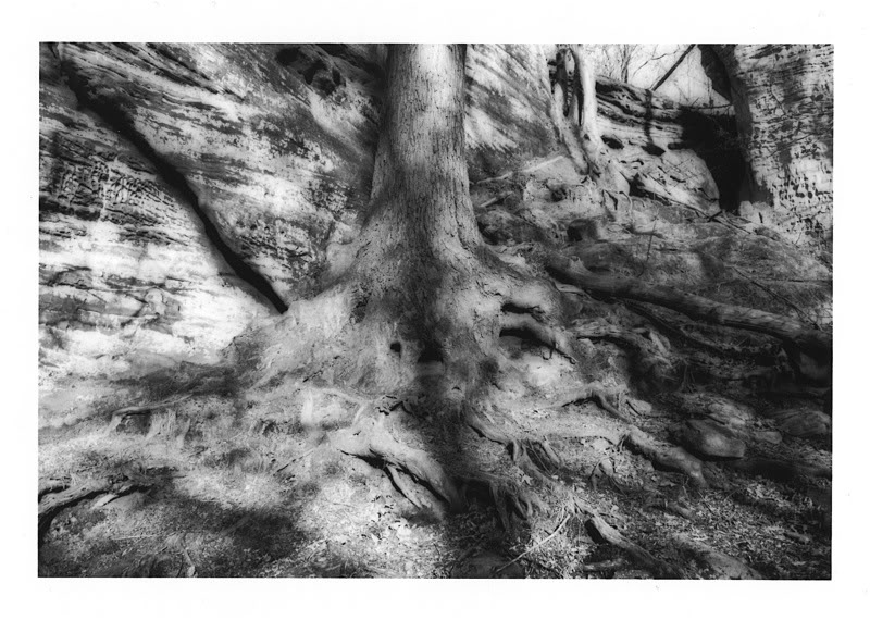

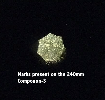

If this thread is about emphasizing distortions from low-quality and/or damaged optics, there is some aesthetic potential to using foggy lenses with high levels of chromatic aberration. For example the damaged Componon used for this print looks and performs like a human eye with cataracts. The effects during projection printing B&W is that the dark areas bleed into the light areas. I find the aesthetics appealing under certain conditions.
TECHNICAL DETAILS: Seems the more area of damaged glass, the more pronounced the effect. Something like this 240mm Componon-S has a massive lens opening of about 70mm.
Using any fast enlarging lens wide open (to emphasize distortions to the projected image) produces a pronounced hot-spot in the middle, so over-sizing the lens focal length for the format can eliminate that.
