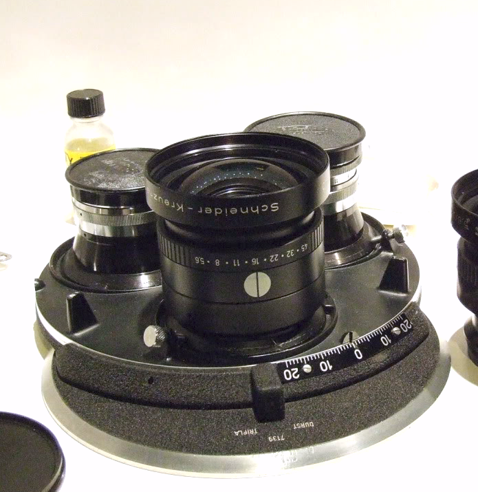

Certainly silver has a stylish, vintage look, but I prefer the modern barrel.
