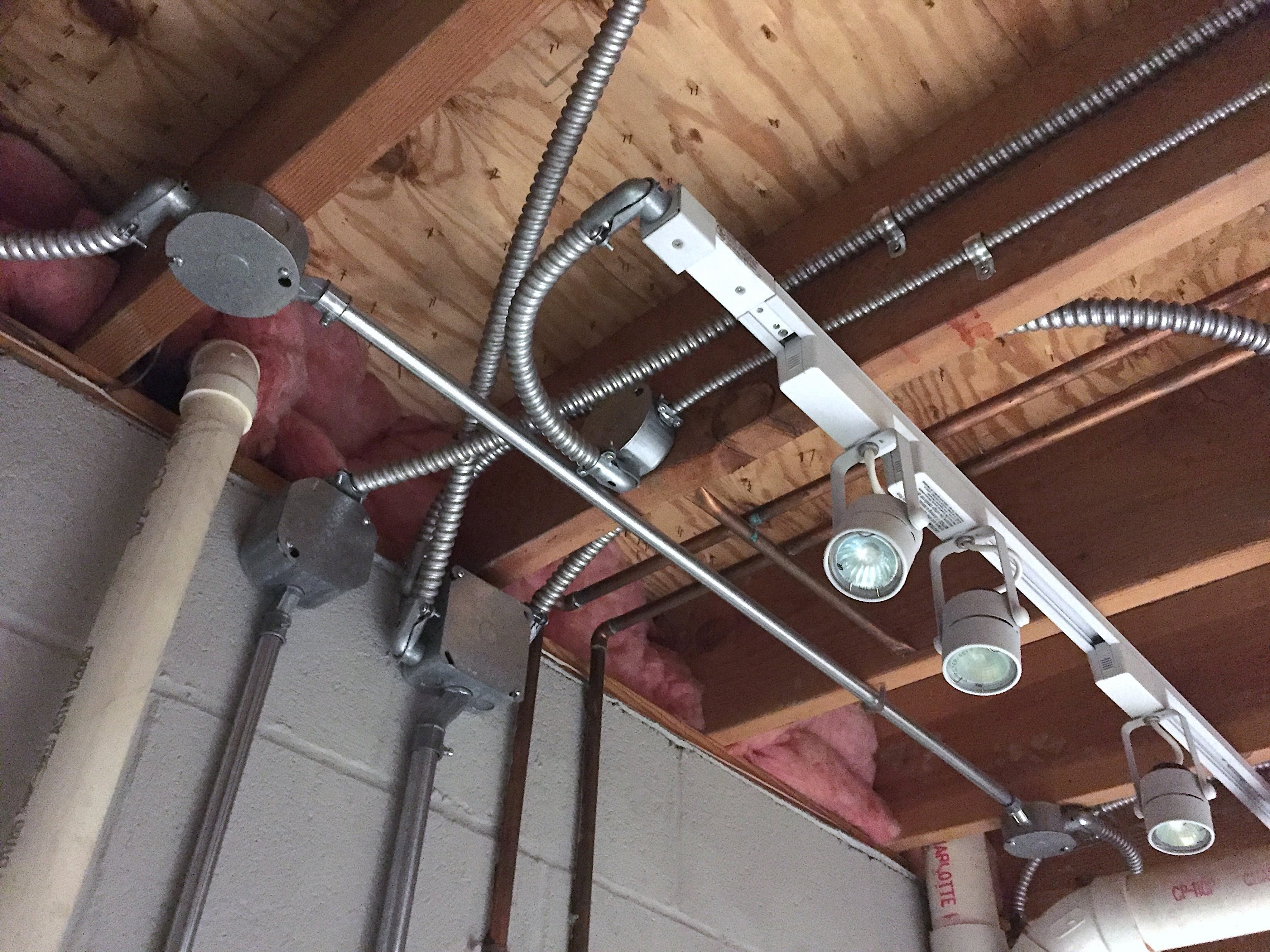

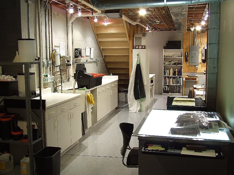

I have 17 outlets. One in the ceiling 220v/20A for Durst, two ceiling for safelights (15A) and 14 round the counter tops (20A GFI breakers).
These things stay plugged in:
4 enlargers
2 air cleaners
3 safelights
1 phone/intercom
1 viewbox
1 view table
1 Vintage Pioneer power amp
1 Dust Vacuum
Processor, densitometer, etc don't stay plugged in.
No computer; though I wish I had some way to make an iPad screen safe. I'm the printer and I don't need to be plugged in.
Including the lighting, I have quite a few circuits, so I have an entire sub panel just for the darkroom (the smaller sub panel in the picture).

Instead of a ring-wiring under the ceiling and various vertical taps to the outlets one could have installed a horizontal cable-channel just above the table. Then one could locate easily outlets whereever necessary, even relocate them. The industrial version would be a wider channel where the outlets could be located even within...
(I'm disappointed, I expected your 1824 to have got a panel of its own... Does it fit into that room? Your ceiling seems at 2.50m. I thought from some older photo the ceiling was higher.)

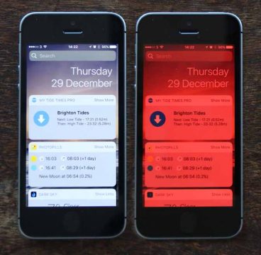

@ic-racer - Nice diggs BTW, I remember seeing those photos somewhere before?
I don't intend to wire plugs for everything on the list, nor do I expect to cram the space full of gadgets, I just want to think about the placement and make sure I have enough in the future.
I see you have a mini vacuum plugged in as well. and you say 2 air cleaners, what are they and why (I assume for dust due to the exposed ceiling)?

Nice set up ic-racer, however I would recommend a ceiling of sorts. I had a basement darkroom years ago, I also had a serious dust problem until I covered the exposed joists. Every time someone walked on the floor above it dropped crap everywhere no matter how good I tried to clean it. As for red covers on phones(or any other piece of gear) that's fine if you only print, but totally useless when you have film out to load into holders or daylight tanks. Scenario: phone laying on counter, you are loading film into your reel to process, the phone rings and lights up. You're screwed. BTW, if you wear a wrist watch, take it off before you load film.

Rick, will the glow of my watch (or any glow for that matter) affect film loading???
Jamie
It has happened to me, took quite a while before I figured out what caused the ghosting on my film, turned out to be the luminous dial of my wrist watch. Also had an issue with the luminous face of a GraLab 300 timer until I covered it up. I have black tape on the switch of my air cleaner to block the red "on" indicator.
Photos are a little old, but the areas over some of the counters have been covered for those exact reasons.
I had considered that but those don't meed the local electrical code. The wiring in the darkroom is all 'Hospital Grade' with all the circuits in metal conduit.
The big Durst does not have its own panel, but it has its own dedicated circuit breaker in the panel. I can get within 3 cm of full head extension before the head hits the rafters.
The Durst is on wheels, so I have had it at different locations throughout the years. The darkroom has changed and times have changed since I took that picture; the era when one could obtained an enlarger like that for $500 is now long gone.
If you wear a Fitbit or the like make sure you leave it outside the darkroom. They have a habit of lighting up at the most inappropriate time.
