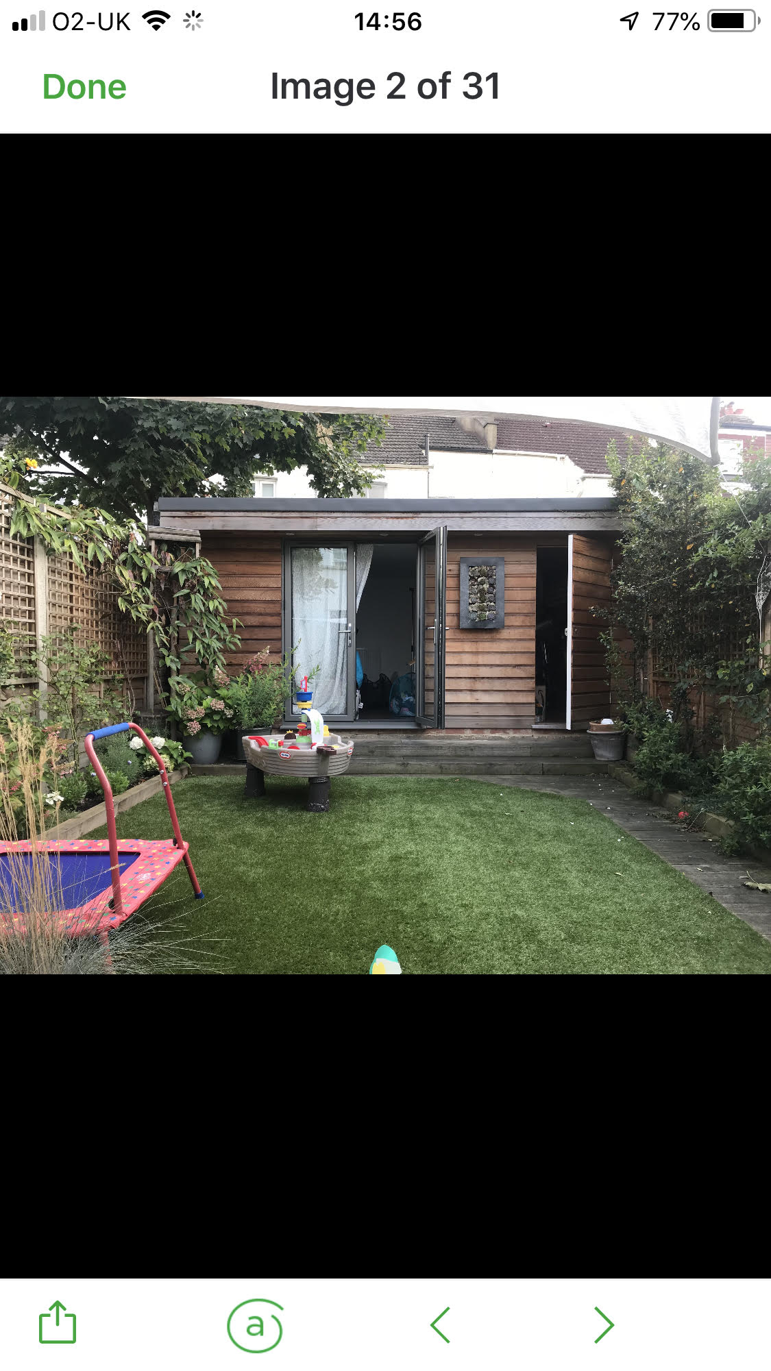

Shed sounds like an excellent retreat from the house but you'll have to consider heating requirements and also how you are going to keep the shed from getting too damp. Dampness is a very bad thing for lenses, boxes of paper, film, negatives and delicate equipment made of ferrous metal etc. You could consider storing lenses and paper in the house and only taking them out when you are actually going to work in the darkroom. Also sheds tend to get very hot in Summer depending on where it is in the garden and this is a problem for paper and chemicals (and the occupants).
'Executive' shed with heating and running water.
Not moved in yet, I get the keys to my new house next Thursday. the shed came as an added bonus! CANT WAIT !
But thanks for the heads up about heat, I never thought about that.
I dont think damp will be a problem, its very well made.
Excellent. You will just have to lightproof it. That is easier said than done but perfectly possible. Thick, lined, curtains might work. My darkroom is not quite perfectly light tight so I tend to work in there at night.
