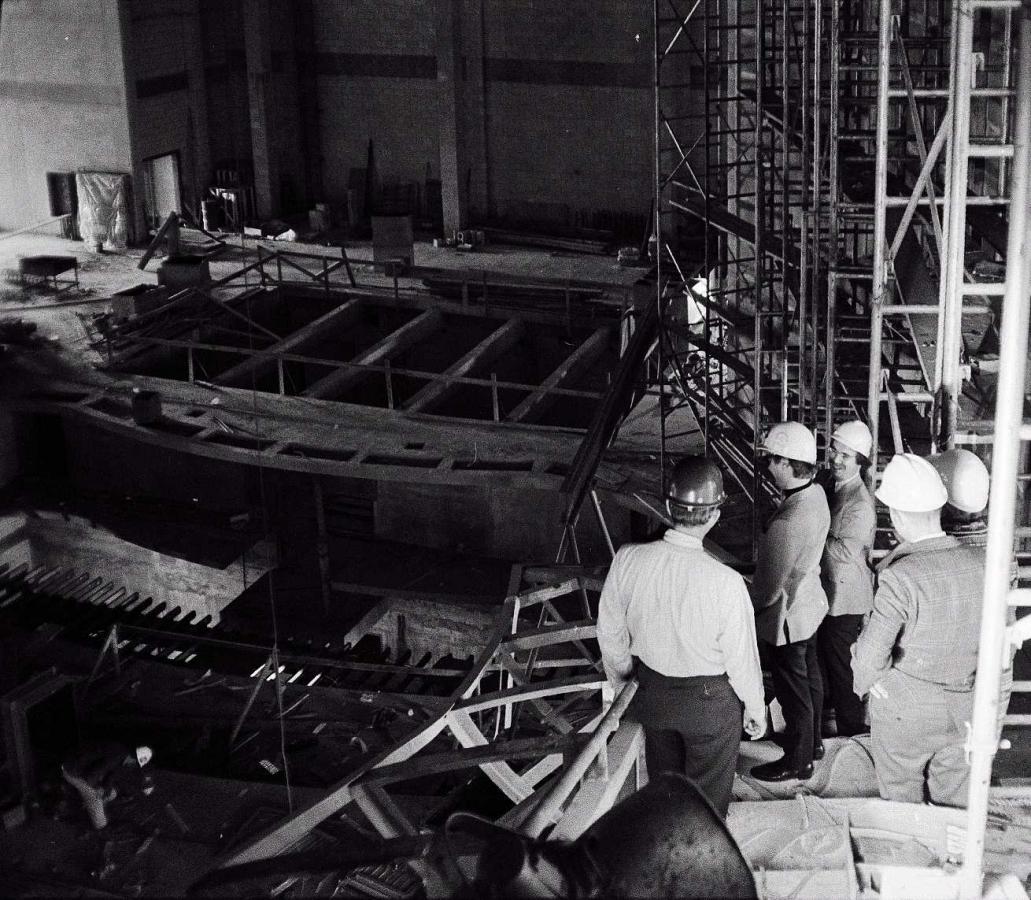

Is there some critical component of this scene that I missed? I captured it in 1971 before I owned a balance while on a photo tour of the future home of the Norfolk Symphony with the conductor and business staff of the orchestra.

Patrick;
There are several things I can say about that picture:
1. I don't have any idea what it would look like in several reference developers
2. I don't have any idea what the developer is you are using, nor what it might be noted from.
3. In the scan it looks grainy and unsharp so IDK what the scan did to it or for it.
4. An isolated photo does not demonstrate any scientific methodology I know of.
Final answer, I can say nothing about an isolated photo like this and cannot tell what you captured or missed. The photo is meaningless. You need side by side comparisons.
PE

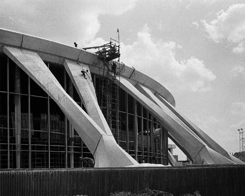

It was 400 film, I don't remember which. You know the limits of resolution we can post. You know that scan resolution interacts with grain resolution to make things worse. If it is meaningless, so is your inference that I don'y know a good photograph when I see it. Are you really trying to say that you cannot see the good photo that is hiding in the scan?
One is not able usually to try more than one developer on shots like this while on an assignment like this. Another one on the same roll is the attachment. It is how I knew it was 400 film.

Patrick;
A good photo does not need to "hide"!
You are trying to make some sort of point with these posts of photos, but actually this devolved into a discussion regarding scientific method, I think. As such, your photos signify nothing in terms of scientific method, but are just random isolated points. If you don't see that, then the discussion is meaningless.
You don't know the film, nor the developer and have no comparisons, so what is the point?
PE

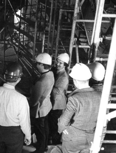

I didn't say I don't know the developer. I posted the teaspoon formula a few days ago. I do know it was before I had a balance, I do know that whatever variances there were in measurement, they did not cause excess grain or loss of resolution. I do remember that I was money poor but love rich, with a beautiful wife, 6 children, a day job with NASA, a night job with music, and an itch to make pictures. If I let you lead me down this path, it was because you were making unfounded statements about the need for precision in B&W developers.
My last post on this subject is this one. The last photo I posted was scanned from a 35 mm negative. I found the original print I made from it about 35 years ago and scanned a portion of it to show how badly scanning can affect apparent grain.
