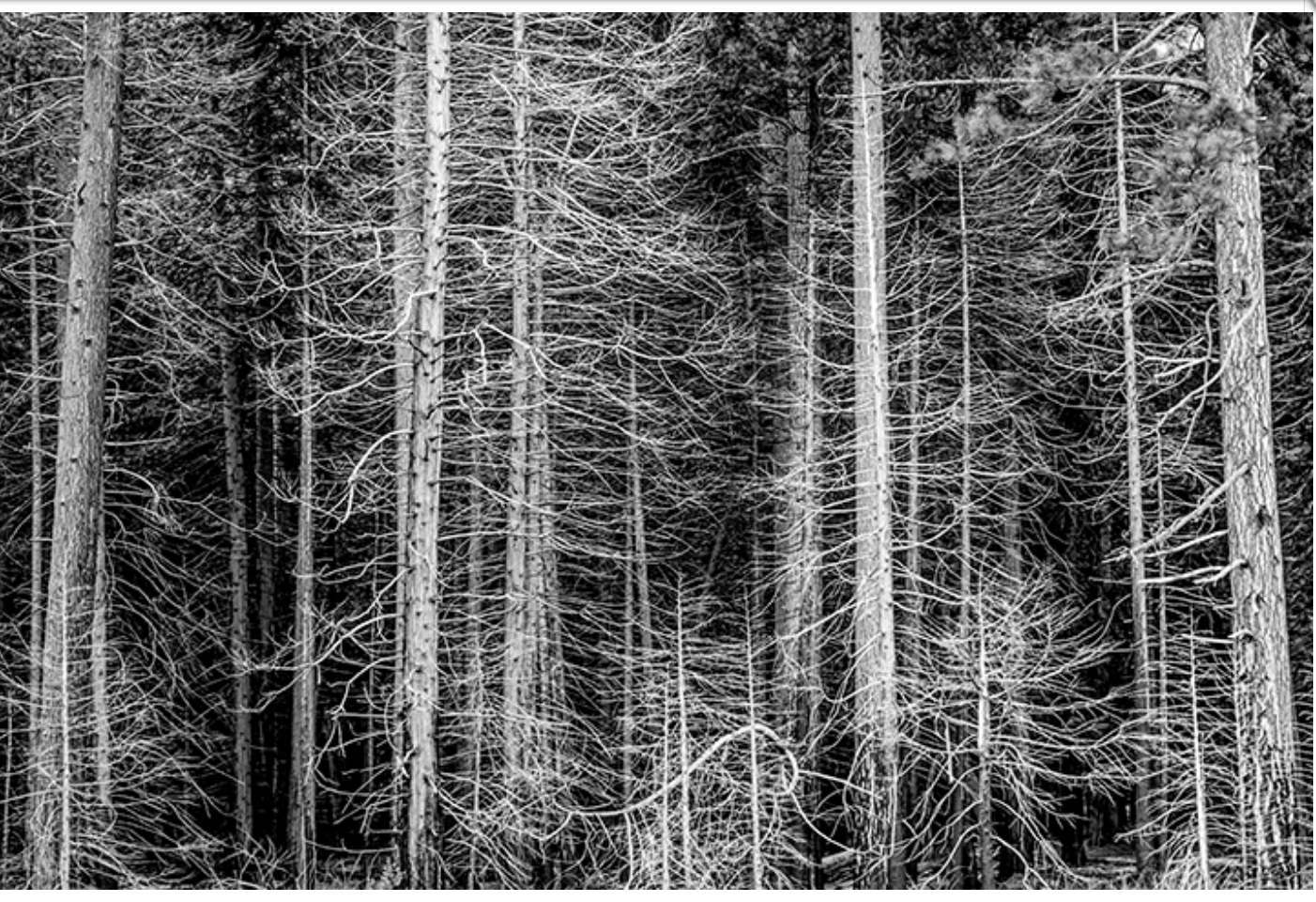

I made a similar image in Yosemite in the late afternoon. The trees are dead; hence the white bark. Notice that the branches are white too and bereft of needles. The photographer made a very nice print to emphasize the inherent contrast. Here is a low res scan from my negative for comparison. I made my final print in platinum/palladium.

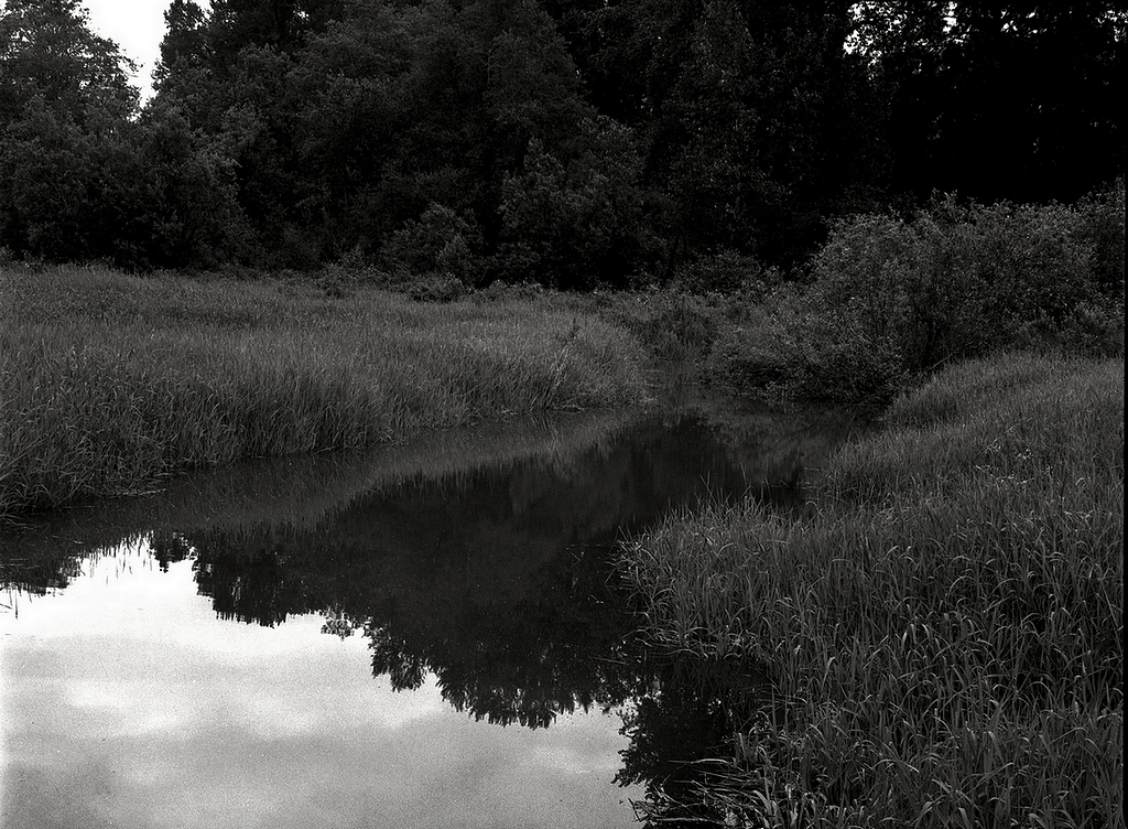

It’s not the same quality of the Paul Hart photo, but this is a shot of a woodland scene I came across last week looking for interesting places to shoot with my Mamiya 330.
