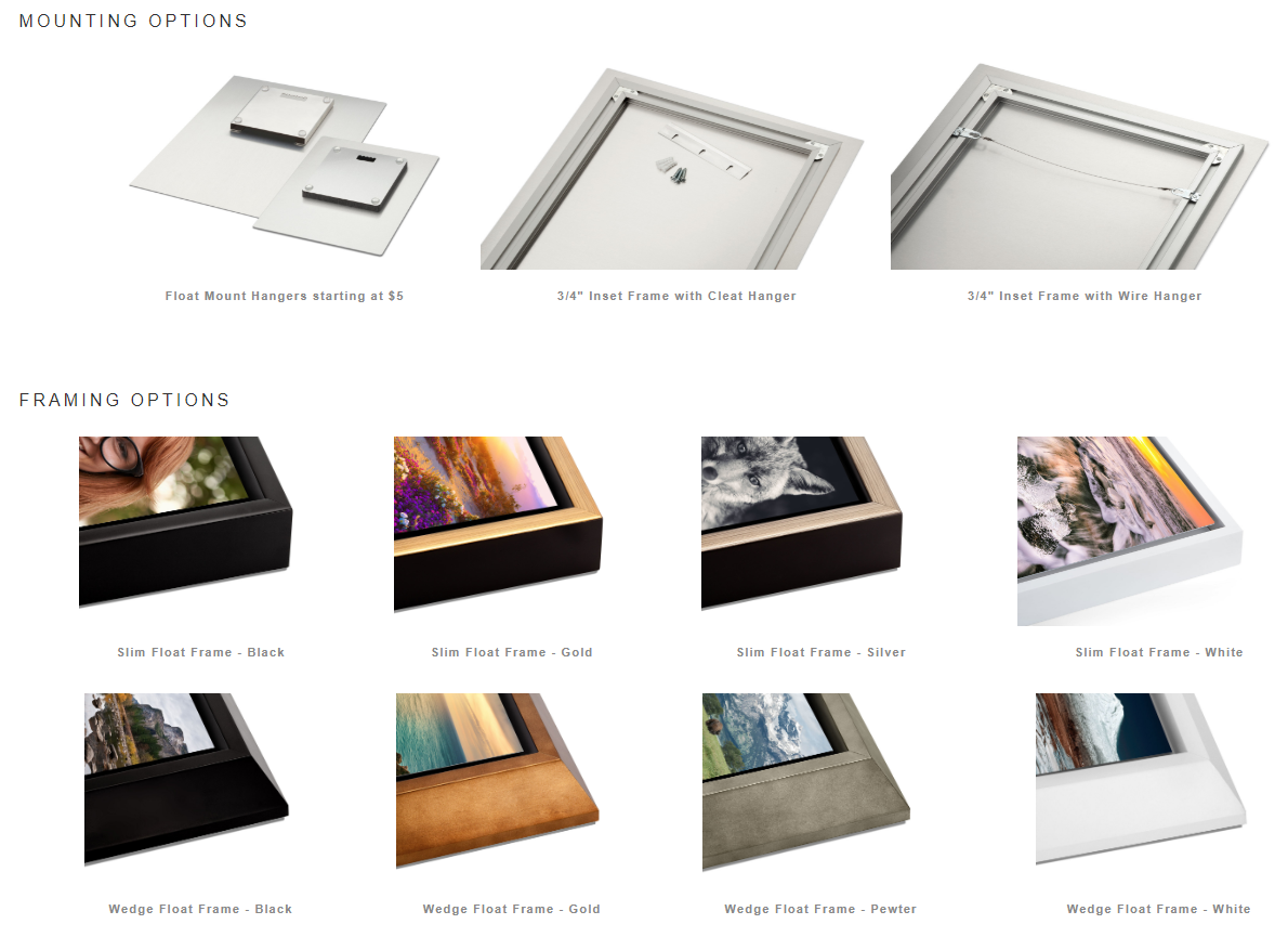

hi koraks
places i have talked to ( being a photo geek like i am and being impressed about metal prints )
told me that they use a dye sublimation printer for aluminium prints. maybe their process was specialized?
no clue. the problem i have with metal prints is that display seems like a PITA...
Dye sub is probably the most common method for aluminum.
Display is easy - maybe easier than a paper print. This is from Metal & Paper's site - you could also use a conventional frame as it wouldn't be any different than a mounted print. I used the black slim float frame and it looked fantastic.
