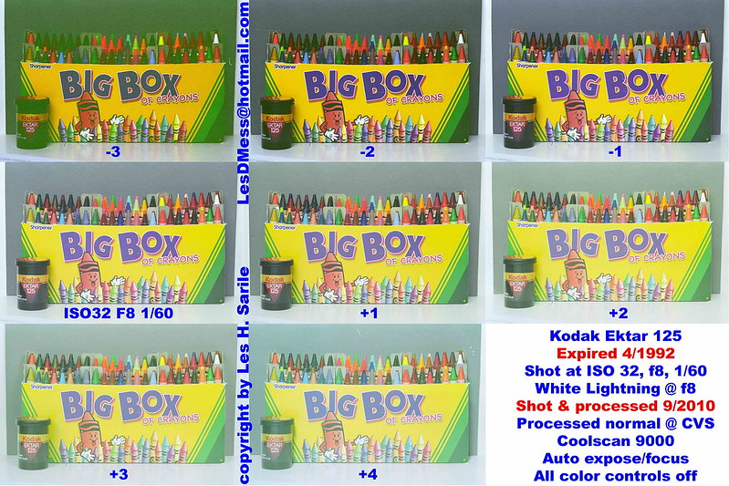

I picked up a big box of film that was kept in an open driveway in Atlanta, GA from 1992 til I picked it up and shot the first roll in 2010. Really shows how robust film can be stored in the worst conditions!
Kodak Ektar 125 box by Les DMess, on Flickr
Test roll of Kodak Ektar 125 expired since 4/1992 and shot and processed at box speed in 9/2010.
Kodak Ektar 125-1_03 by Les DMess, on Flickr
To my eyes, seems ISO32 seems best.
