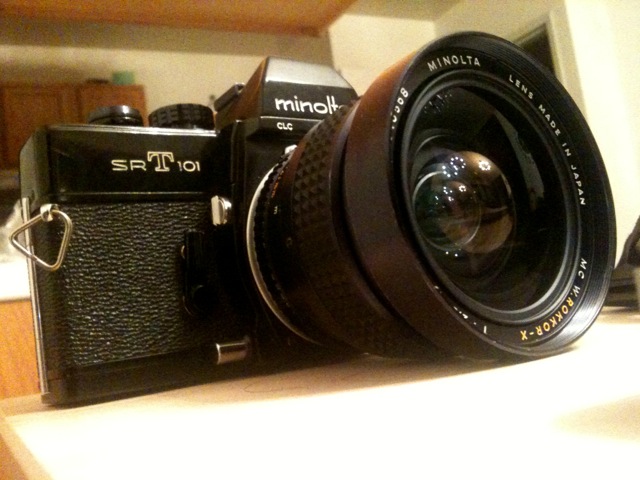

Les, how do you feel the XE advance rates against the F2? I consider the F2 to have one of the most satisfying advances of any camera I've ever used.
On another note, anyone ever remove the flash shoe from an SR-T 101? They annoy me and I wouldn't mind taking them off.
Here's one of my SR-Ts:
attachment.php

In what way though? Maybe I don't actually mean smooth, but pleasurable. :smile: For instance, as an F3 owner you know how the F3 advance feels, and you probably know how the F2 feels compared to the F3. To me the F2 is better than the F3 even though the F3 advance may feel more "fluid."
