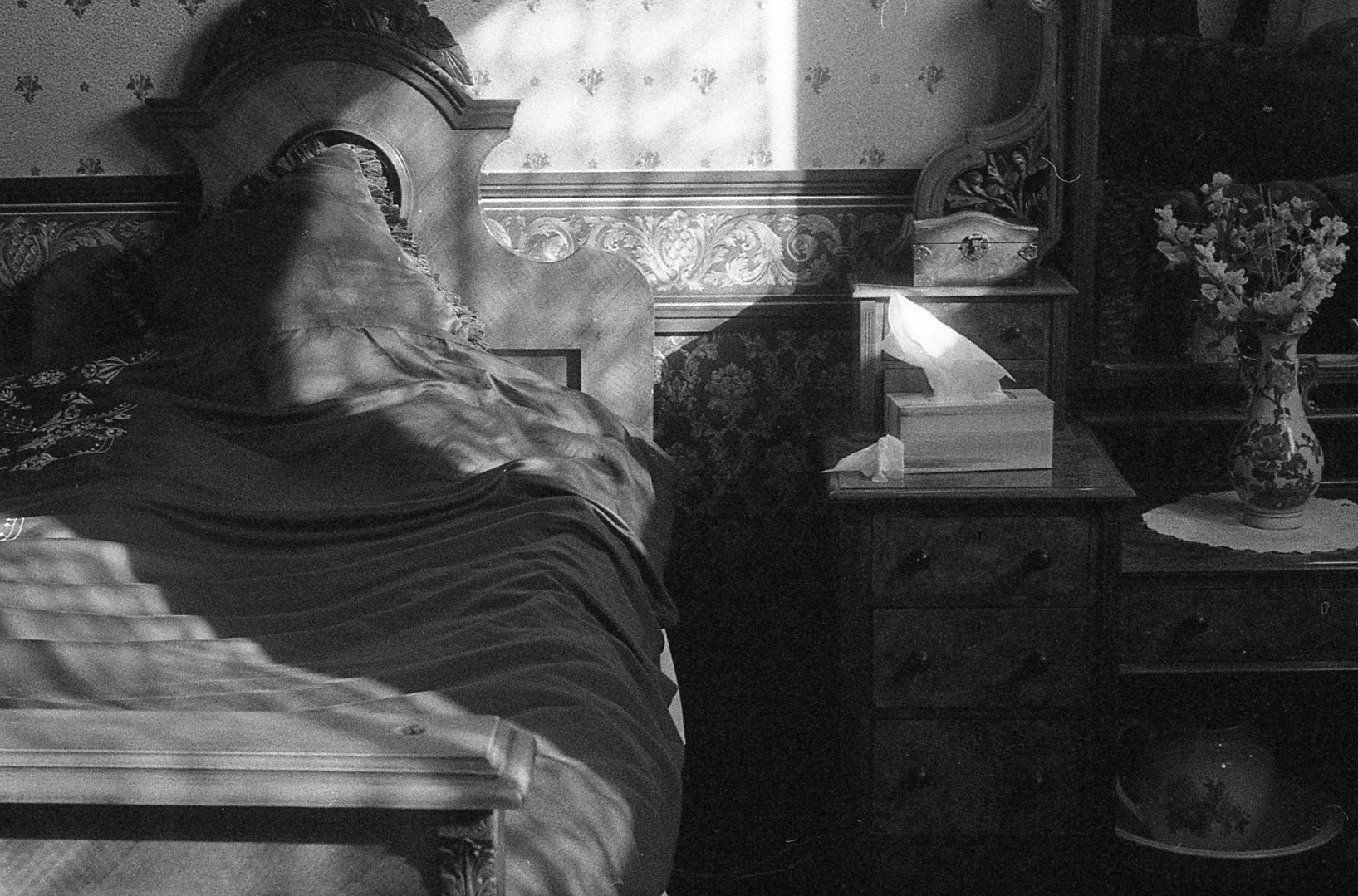

Delta 3200 in d76 1:1

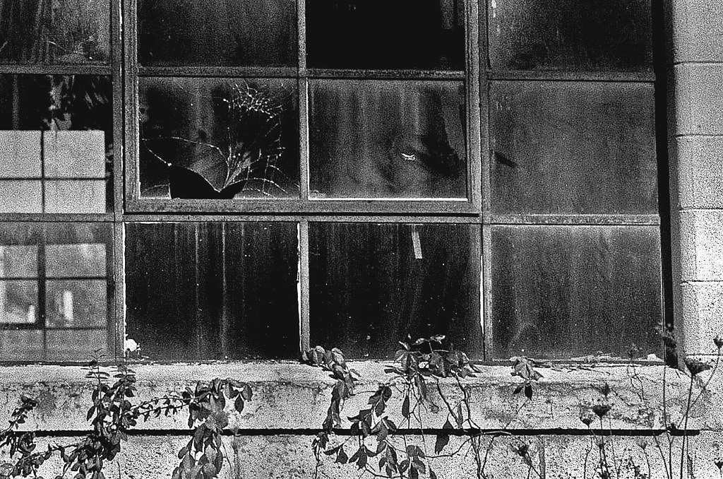

This is Eastman 5222 Double-X in ADOX Borax MQ which I mix myself. Has some grain to scan. I loved 2475 Recording Film. Anybody here still able to shoot any? This was scanned on a Minolta Scan Dual II.

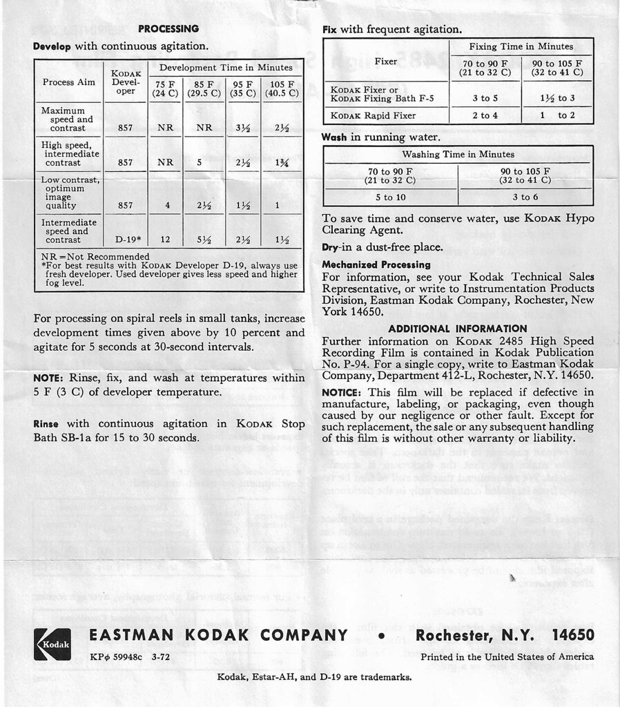

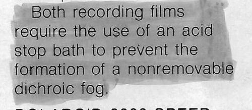

Recently I got this roll of type II perfed 2485. I tried the first roll in Acufine, with a water stop bath. BIG MAJOR MISTAKE. You must use an acid stop bath with recording films, or you will get a non-removable opaque brown stain that seriously will ruin your results. I will try again soon, with Diafine (I have mixed up a gallon).
Increasing Film Speed Petersons 2485 by Nokton48, on Flickr
As I recall Difine recommend a water stop, then fix. I would use Acufine with a standard stop.

According to the Petersons Speed book, the 2485 and 2475 fog is dichroic in nature and nonremovable. What I got was so very dark brown film base as to be nearly opaque. So next 2485 run I will use acid stop bath
