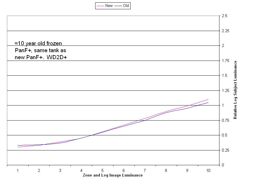

I had this situation (aged Pan-F+) and did some testing after finding a large, forgotten bunch of Pan-F+ in the freezer. Pan-F+ is known to be sensitive to losses of latent image more than some films so I was a bit nervous about using the 10+ year-old film. I had a couple of bulk reels, some factory 35 packs and 120 rolls. I plotted 2 rolls, one new and one from the freezer stash, exposed identically and developed together. In getting some old data transferred to a new computer recently , I remembered seeing the file and thought I'd share. I happened to be trying out WD2D+ at the time but can't say I have any meaningful experience with the developer and moved on to other things at the time. For what it's worth, this quick little test told me that I could assume the old film to be equivalent to the new batch in use.
