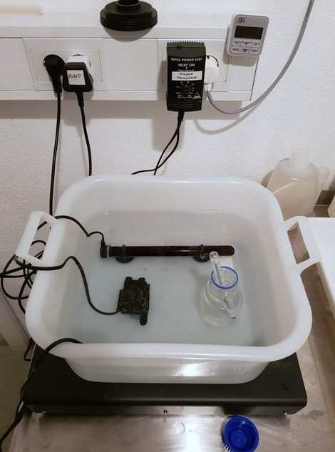

I'm using a NOVA 300W heater and an aquarium pump to circulate the water around the bottles. A precise thermometer is essential, with Paterson and Kaiser being popular brands for color thermometers.
