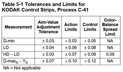

To get my control strips in spec using a paterson tank I use the following below. Agitation is once per second stopping the last 10 seconds during the drain. I preheat the tank with film loaded to ~100F using heat tape before I start.
Chemistry was newly mixed Fuji Developer, Kodak bleach, and Kodak fixer, stabilizer. All chemicals where used one shot. Dev Time was pushed from 3:15 to 3:45 to get HD up in spec.
Sous Vide heater in a large pot to keep water bath / chemicals at temp with a calibrated external temperature probe to verify Sous Vide is holding 102F.
Times used where:
Develop (102F) 3:45
Bleach (102F) 6:30
Wash (75F) 3:15
Fixer (102F) 6:30
Wash in sink with running water 3:15
Stabilizer 1:30
