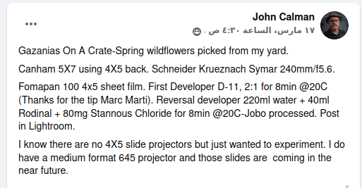

This guy really surprised me...
I read his article hours ago and am seriously considering applying his method. But I don't currently own a D11 developer, so
The method does not need thiocyanate or thiosulfate.
