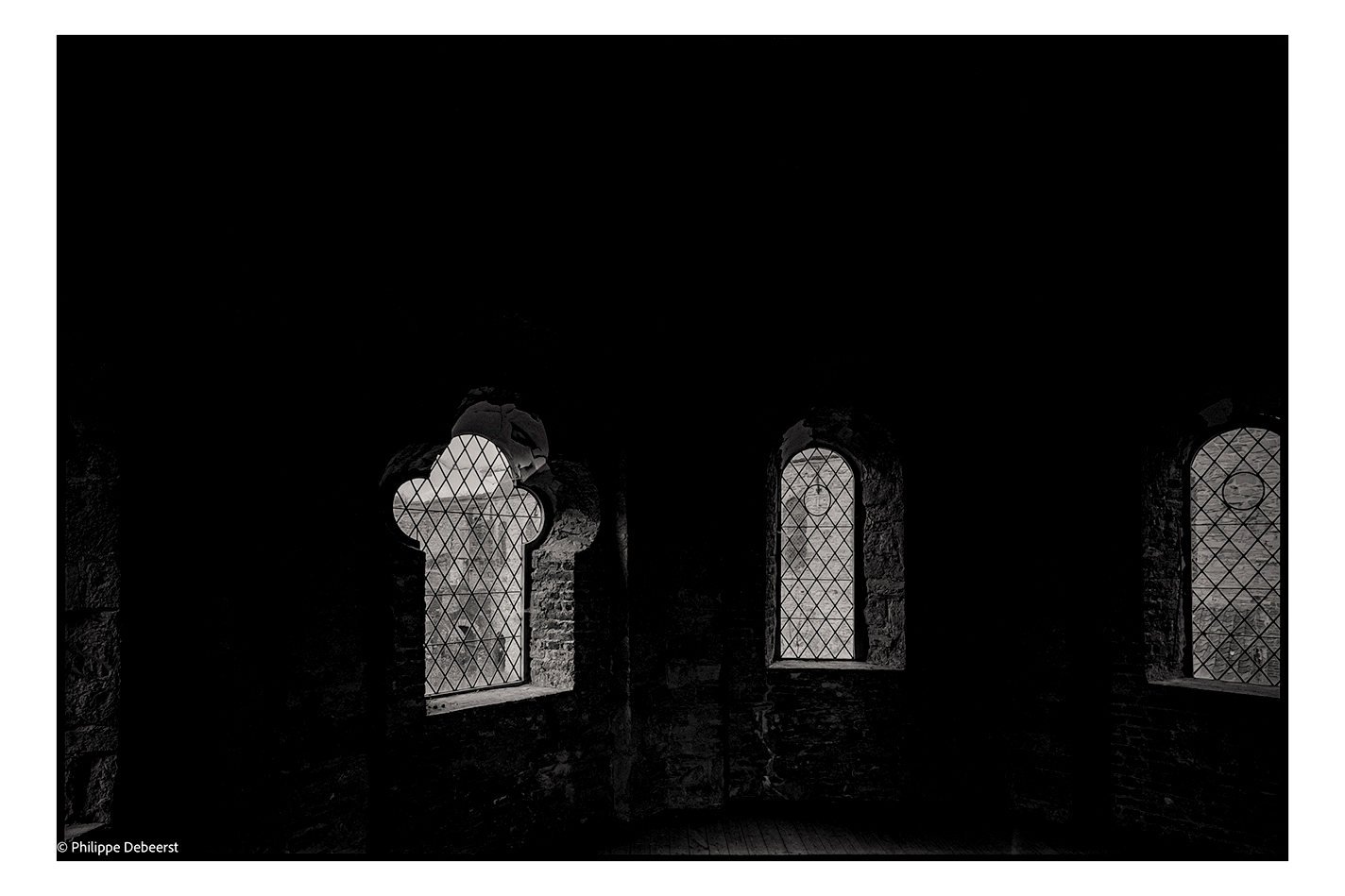

In the attached image, I didn't brought my spotmeter, just an incident meter. And measured the side part of the window's opening pointing towards the camera just to have an indication of the higher lights (not the highlights) and then the light hitting the boarded floor for the lower lights. It was needles to measure from the wall between two windows as there was almost no light there.
Then I trusted on my fingerspitzengefühl, set the exposure, and fired away...
BTW: I have read all the 3 books by AA, and particularly about the Zone System, over again and again, and in all honesty I have to admit not to fully understand and never be able to fully apply that system.
On a certain moment it began to haunt me in my dreams!
Then I decided tho read it just once again and leave it for what it was and do some trial and error, more error than trial, to find my way of dealing with shadows and highlights...
Anyway, I really do like a lot of shadows (3/4 to black tones) in my photos, and sometimes I compose so to include them dominantly, hence the vertical shift in the bellow photo so to include more sealing which adds more darkness (3/4 tones).
Silvestri SLV 6x9 + Super-Angulon 47mm + center filter (EI -3) and vertical shift on tripod, Gossen Digipro F, F1:22 t2sec, on Hp5+ 400ASA in X-Tol 1+1 14min 20°C, dry scanned on Epson V 750 and some minimal (Photo-)Shopping.
