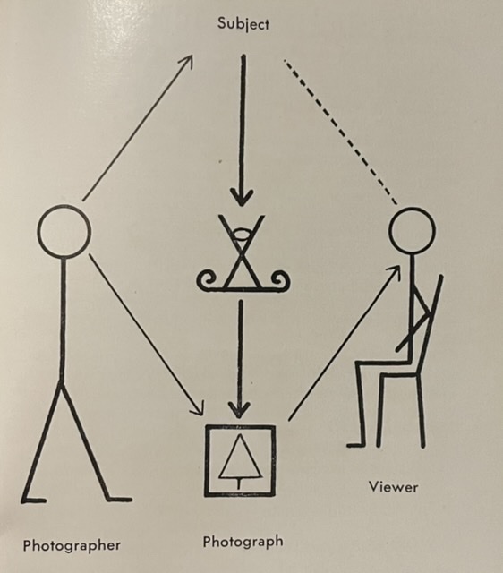

I joke about getting this as a tattoo…. It’s Minor White’s mystic cycle of photographic communication.
