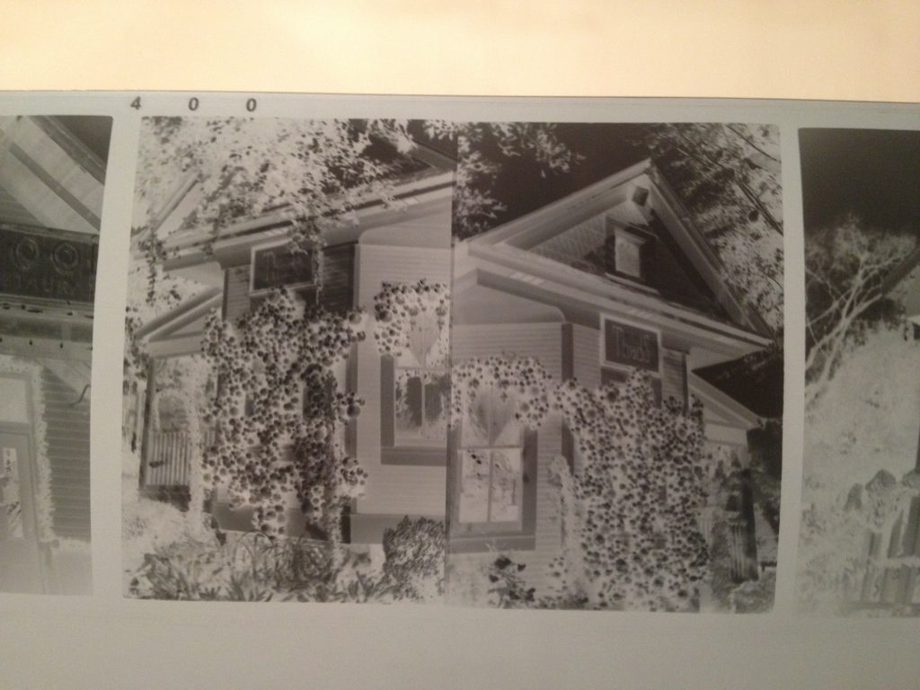

I'm confused. I measured the window, the manual and camerapedia link clearly state it's for 120 film, and that it takes 3x4.5cm frames.... And you still say it won't work as designed?
I usually look up to most of you for information, but y'all seem to be so against the fact that this size frame just isn't possible. What is it about this camera that makes y'all think it's wrong, or I'm wrong or whatever?
All I really wanted to know was how to advance it to get properly spaced negatives.

ChristopherCoy
ChristopherCoy
Aug 9, 2011
3,602
On a boat.
Sometimes you have to sacrifice a roll of film to find out...
Unfortunately you are very right. And so I did. I went outside a blew a few more frames and rolled over the last 12 frames.
In fact my assumption was correct. Frame number in the first window, then frame number in the second window, and you get spacing like this.
Before I figured it out, I ran a few together yesterday, and didn't get spacing at all.
I'd have to say that I like this half frame effect. Essentially I get a 6x4.5 negative, so I could still get fairly nice enlargements if I wanted two photos in one. Could be nice for some art projects, especially detail shots.
