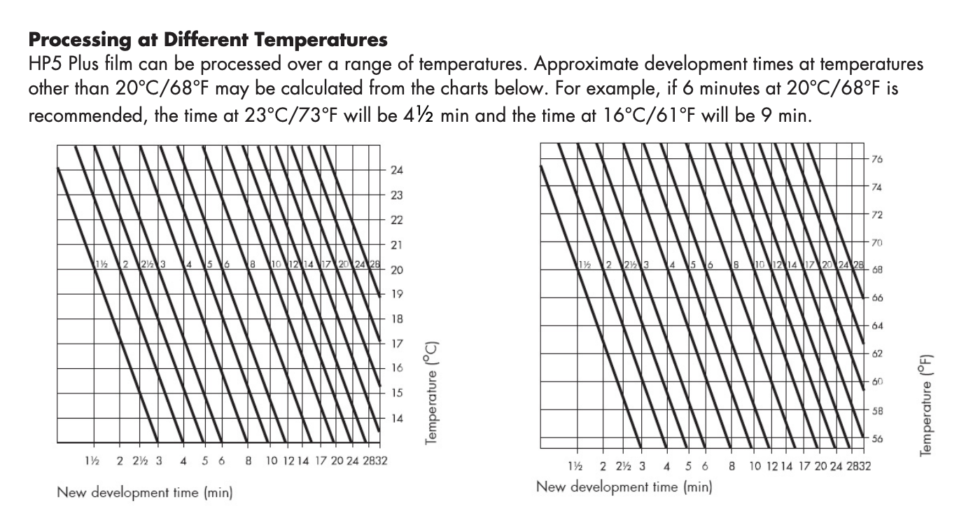

+1 on what bdial said about checking manufacturers charts. Ilford is very good at providing that kind of info (as here, re: HP5):
