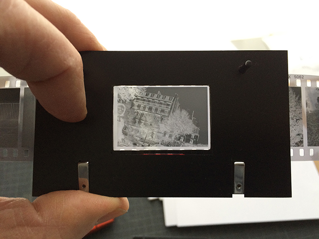

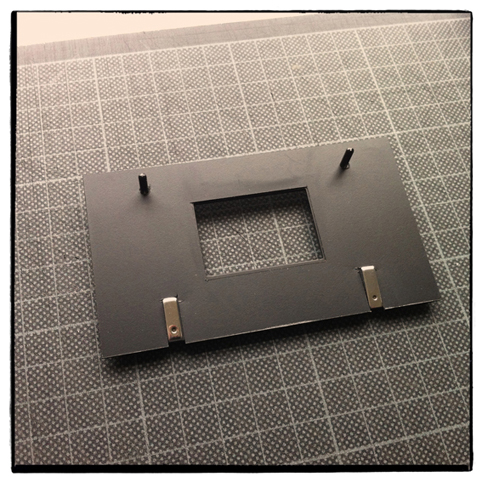

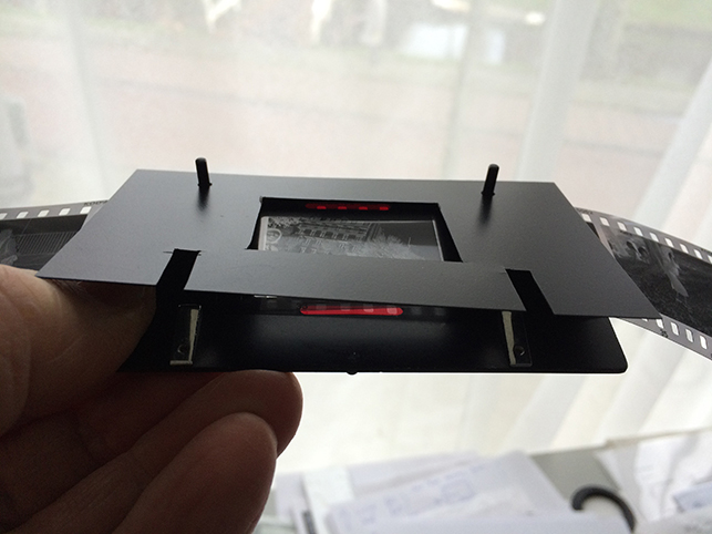

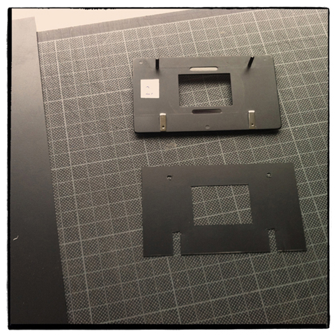

Your do not want the glossy side of the film to touch the glass. So you cut a small mask from black carton or black pvc sheet and cut out your negative size plus a little more. This you place on your negative and then you close your negative carrier.
Attached pictures show such a mask that I made for the negative holders of the Focomat 1c and the Valoy II.
That is how many printers dit it and still do.
So that was what that black piece of paper cut to 4x5 was for that came with my Beseler 4x5 glass neg carrier.
Just had a look at the Gnome carrier. The studs for using medium format film holds the top glass one sixteenth of an inch above the bottom glass. Along with using masks, it seems to me that the top plate is only there in case the neg bends too much.
A set of Kodaloid masks was included in the job lot, so I'll use them once the Kodak Precision is set up.
