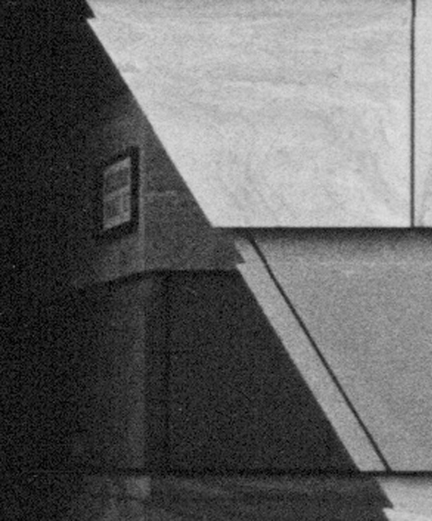

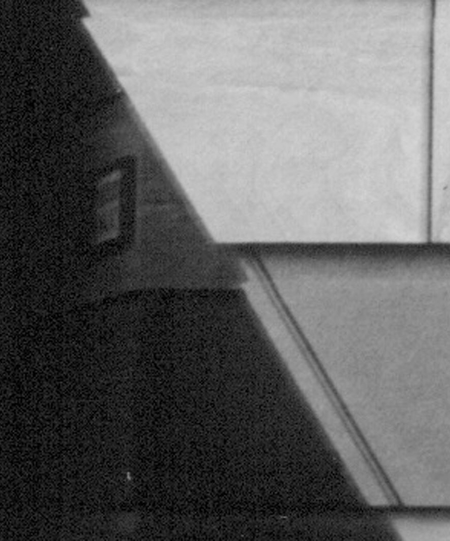

The left side of the diagonal is fuzzy along the entire length. The same with other straight lines.
If the lens is good, I put my money on the enlarger wobbling during or between exposures.

Koraks, I don't see any double lines, even in the cropped section you posted. If there are double lines, that, indeed, points to movement. A popping negative or bumping the enlarger or jiggling it during exposure will certainly cause those.

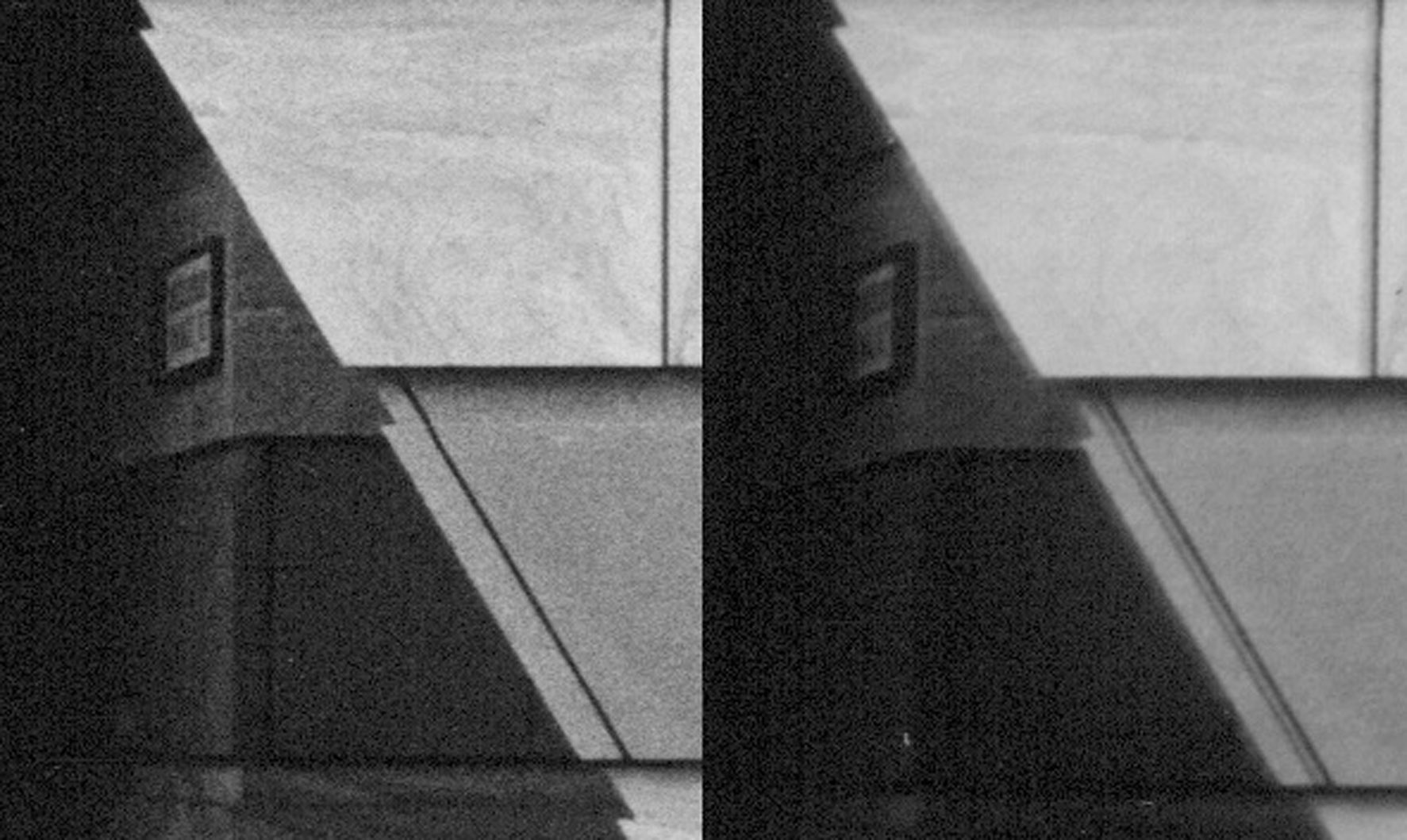

Looks like movement to me based on the following.
This is same(ish) section (enlarged 300%) from both images. Diagonal and vertical lines seem to indicate a predominantly horizontal shift.
I don't see any evidence of movement in the one image you posted at all. Maybe you meant to post two and this is the good one.
In this one, the only thing that could be interpreted as a double line is the two surfaces of the groove between the blocks. Other vertical and horizontal lines don't exhibit a doubling to my eye.

Hi Doremus, That actually IS two separate images that Nige has posted; merely combined into one image to keep them right up against each other for a good side by side comparison.
The diagonal line shows very clearly that something has been bumped between exposures. I don't think focus is an issue because, beneath the two slightly offset exposures, one can still see either film grain or building texture.
I'm with Nige, definite movement there.
Other than that, just the opening up of that bottom left shadowed area and less of the 1.5 grade exposure around the freize to give those details better contrast and clarity and you're pretty much there, Brian. Well done! ☺
By the way, if I'm making a direct replica of another print for someone, I put the original print in my easel and focus the negative on that. That way the crop and any sort of tilt/straightening can be exactly matched very easily.
Correct 🙂
The diagonal line in the lower-right quadrant is the most obvious bit.
I also think that once that is eliminated, the contrast will improve as the mushy grain caused by the movement will 'fix itself'
I'm convinced.
