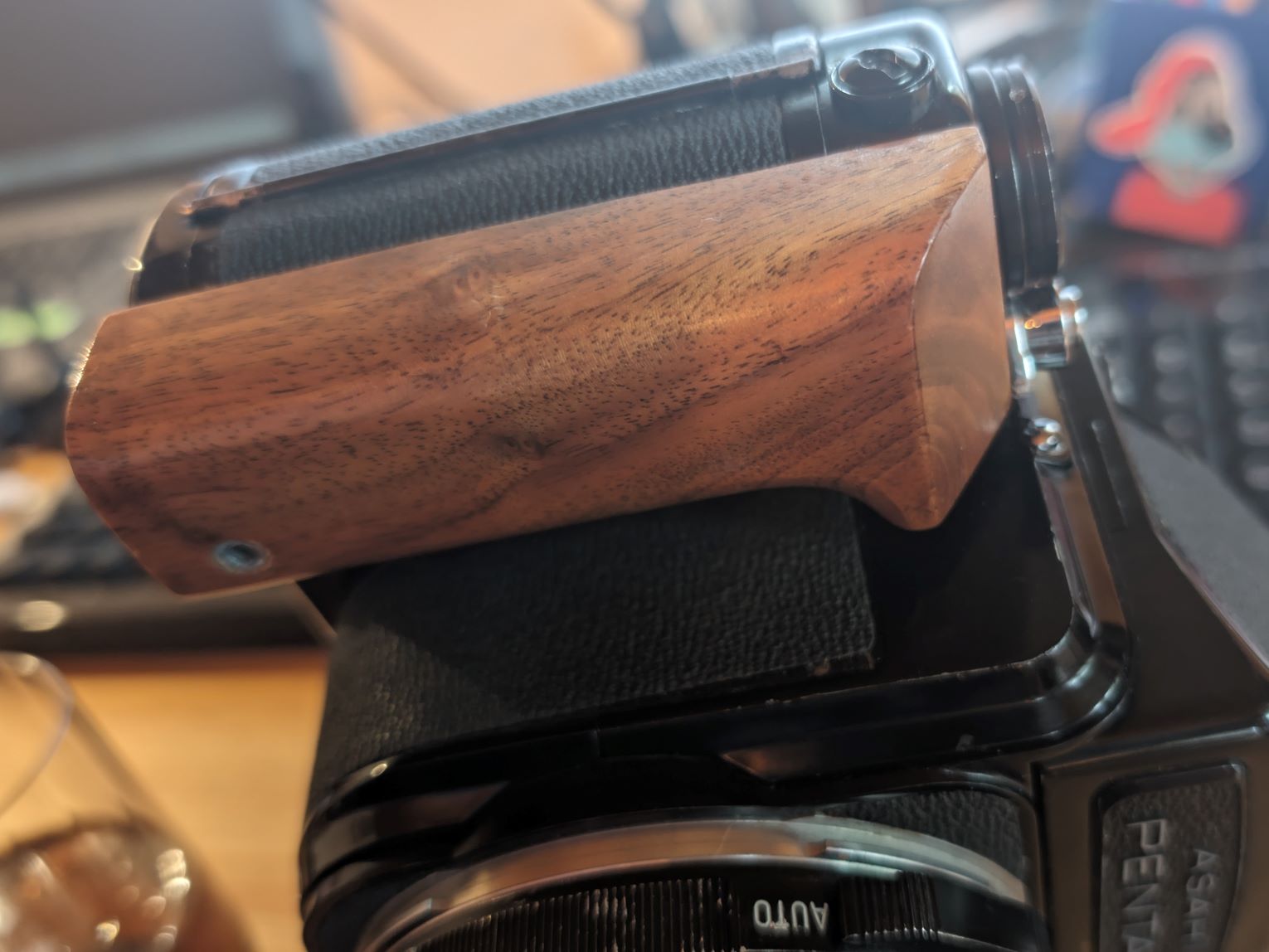

I use both a 6x7 MLU and a pre-MLU a lot (I was going to say I use them "heavily" but that seemed a little on-the-nose given the weight of these beasts!). I agree with everything already said about the consequences of the mirror slap being dependent on factors such as shutter speed and (most importantly) lens length, but I wanted to add that in most circumstances I MUCH prefer the pre-MLU body. The main problem with the MLU is accidentally triggering the lock-up, especially if you have one of these wooden ergonomic grips on the right-hand side (see attached photo showing the grip on my pre-MLU). Accidentally triggering the lock-up wastes a shot and, if you don't notice it, drains the battery. One can mitigate this problem a little by putting tape over the MLU but it doesn't stop it completely and the tape can come off.
Because the circumstances in which you actually NEED the MLU are rare, this makes the pre-MLU body my go-to 6x7. If I could only have one I would choose the pre-MLU.

According to the Pentax Forum, the non-MLU version was only made during the first year, 1969. I'm surprised they still turn up for sale. Perhaps some of them got set aside by their owners once the MLU series soon arrived. Personally, I've never accidentally triggered the MLU button. And as far as alleged sharpness loss with even MLU engaged, I still contend that it's more likely due to harmonic tripod vibration instead. I certainly don't experience it. But I stopped using metal tripods a long time ago. Even garden variety aluminum tripods could probably be improved in that respect with simple closed-cell poly foam snap-on water pipe wrap.
The wooden hand grip probably helps dampen vibrations too. I don't hand shoot the P67 very often, and if I have to, I'm likely to substitute TMY400 for my usual TMX100. I do like the hand grip for more securely handling my 300 EDIF tele setup, and getting it atop the tripod safely. That would be a "crying expensive" lens to drop. Yeah, I do have a clean 300 Takumar as a backup; but the EDIF series has that extra special something.
