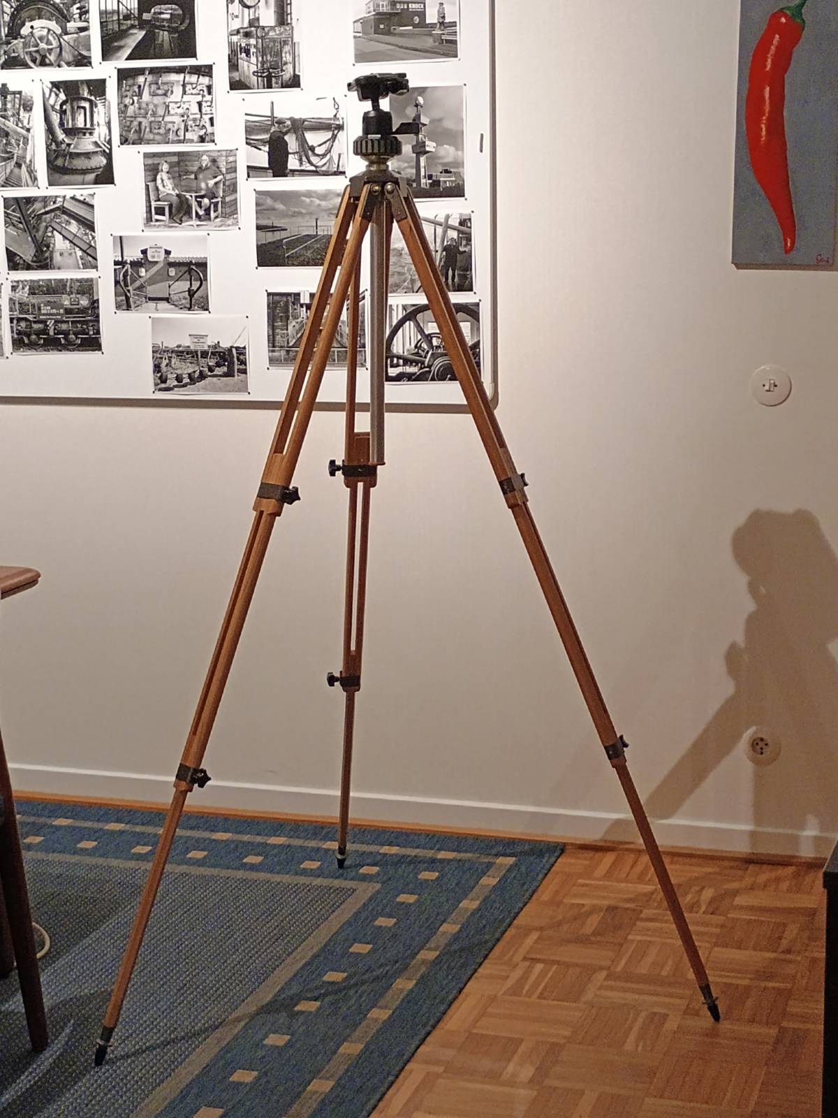

If you live in Europe, I can recommend the wooden tripods brand Berlebach. Sometimes second hand and very cheap at ebay, or available new from the factory in Germany as well.
I own an older model of the report series.
Berlebach Report

When it comes to 300mm and longer P67 lenses, the problem with that Berblach is that it does not have a flat platform top, but a domed one; and as shown, any kind of ball head would be counterproductive. I use Ries wooden tripods. There is some controversy about their level of service at the moment; but it was excellent back when I bought mine. Ries are rather expensive, but they do turn up used sometimes.
That Berlebach is pretty old - it looks more like some of the DDR era ones, or those that were sold under the 'Wolf' brand (from recall, when the relevant VEB was privatised, Berlebach and Wolf were the successor companies with different specialties). The current Report range has two different flat top variations, and the Uni range is much more like the A-100 Ries (which is the specific model I think you are referring to) type of design.

Thanks for updating me on current Berlebach offerings.
