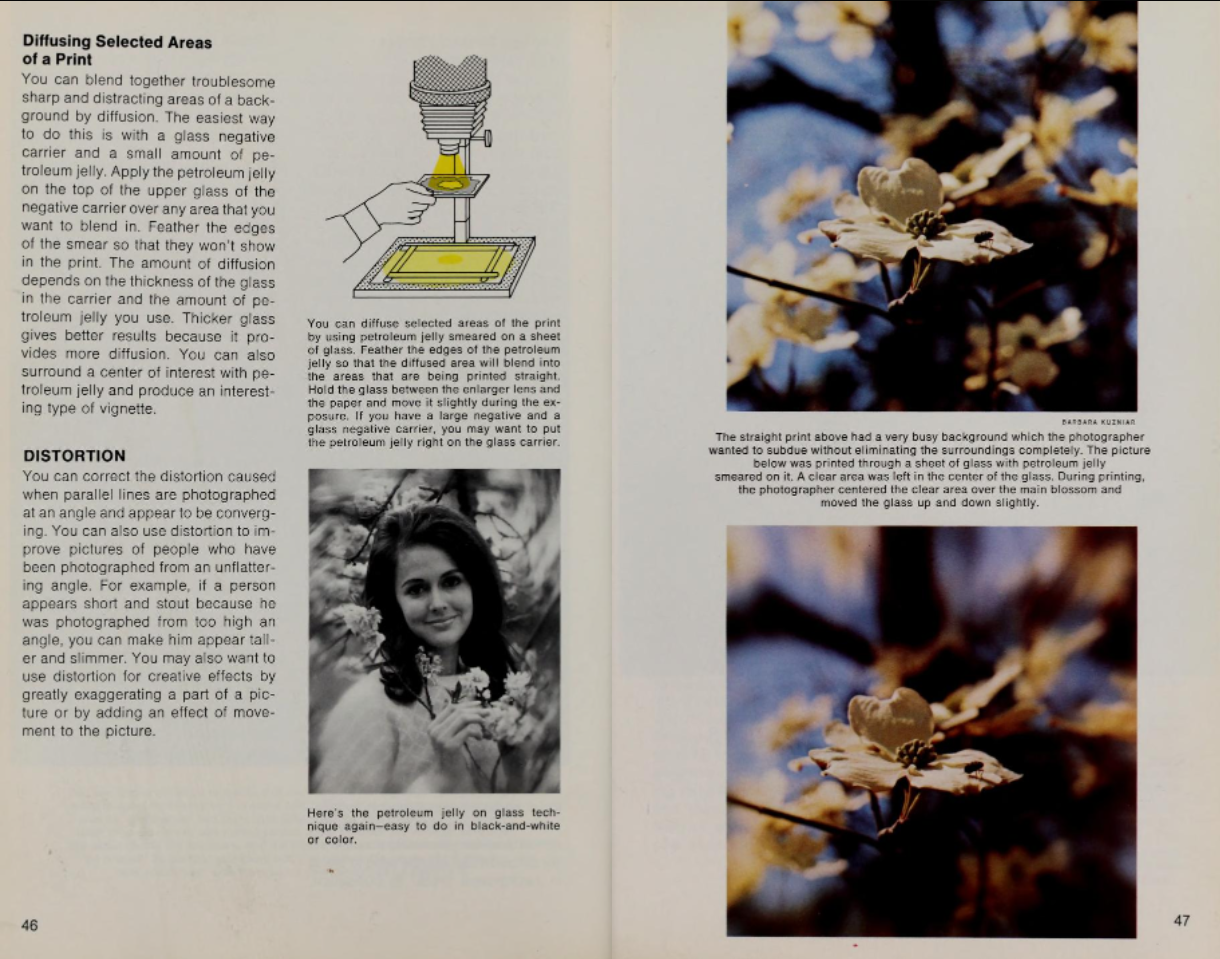

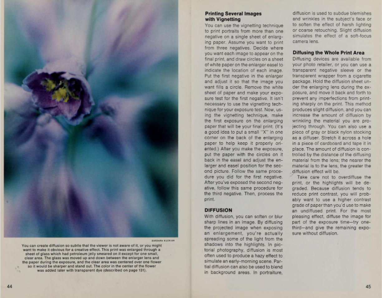

Further, Paul: I found the book is available at archive.org and I believe the relevant pages are:
