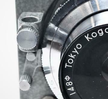

Here are a couple photos of the shutter release from lenses on eBay:
Um, Topcor lenses on Horseman boards are in Seiko or Seikosha shutters that often lack cable release sockets. In addition, the shutters' sync contacts are wired to a PC connector on the lens board.
If flash or, sometimes, using a cable release is important, these lenses have to be reshuttered to be usable on other cameras. The alternative, which I haven't explored -- you have a Galvin, you do the legwork -- is to have an adapter that accepts small Horseman boards (80 mm square, if I'm not mistaken) put on a Galvin board. Not what I would do, but then I don't have a Galvin and our preferences are probably different.

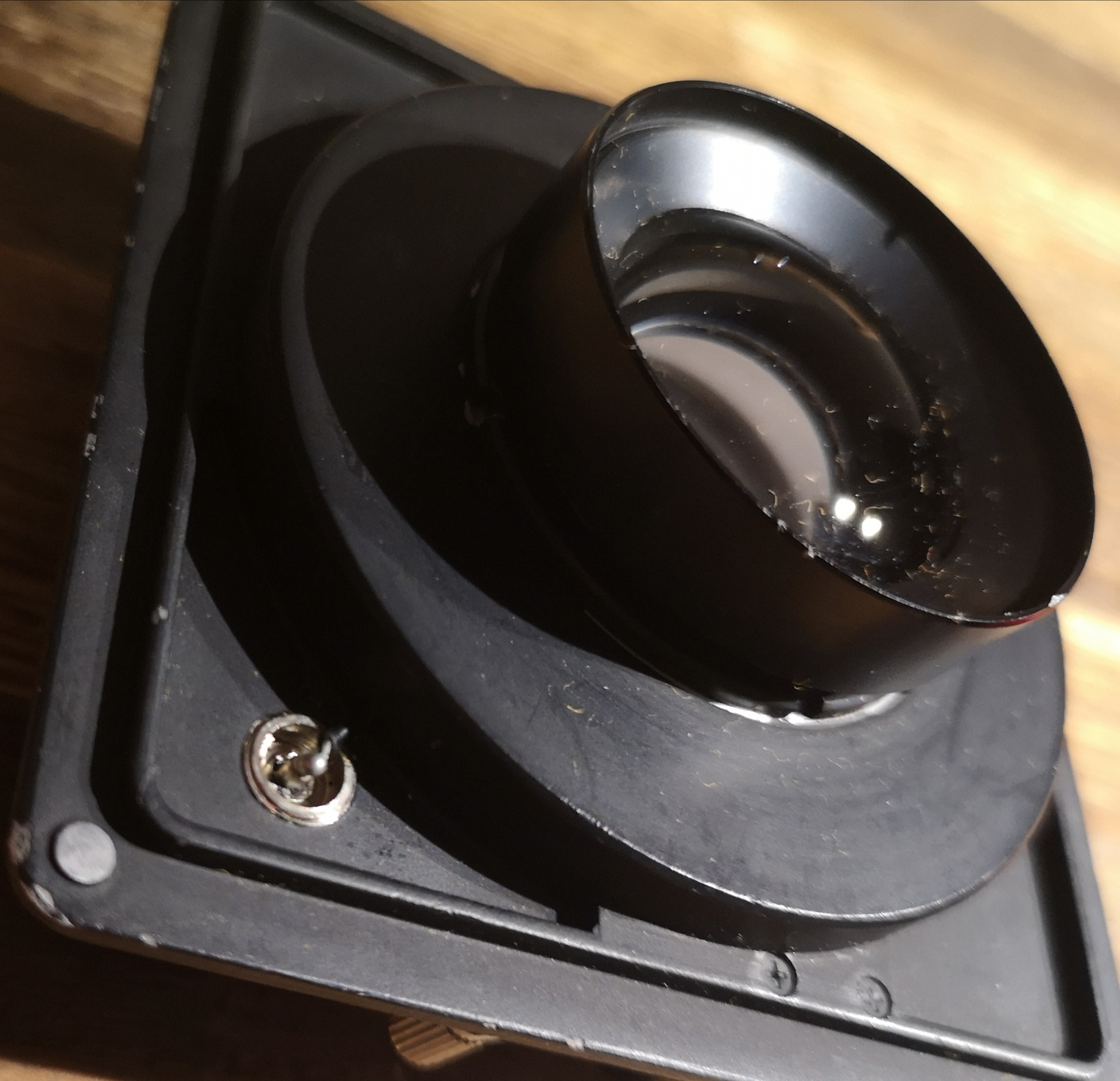

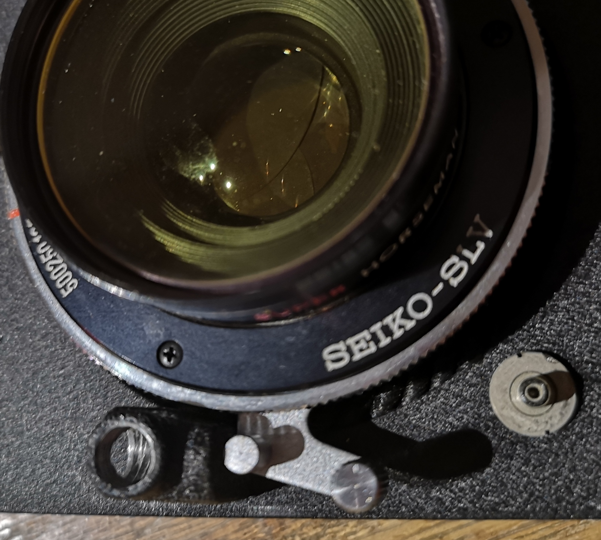

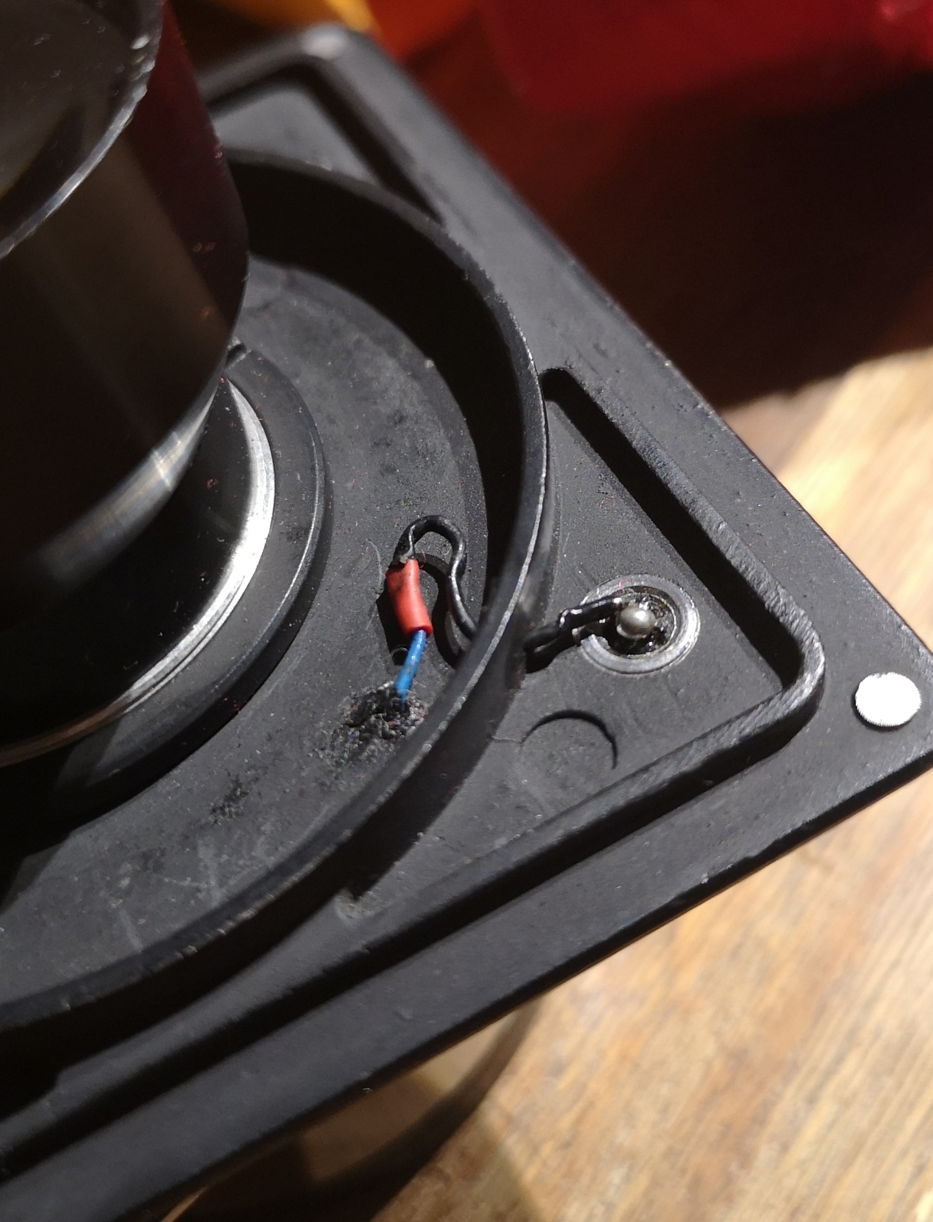

If it helps here are some shots of a 90mm and 180mm topcor I use most time. Somewhere I also have a 150mm but can't remember how it is built.
Afair i can use the 150 and 180 with a cable release, the 90mm I use without hand held on my vh-r.
I found and bought all three lenses as "Tokyo kogaku" readily mounted with the boards.
Hope that helps

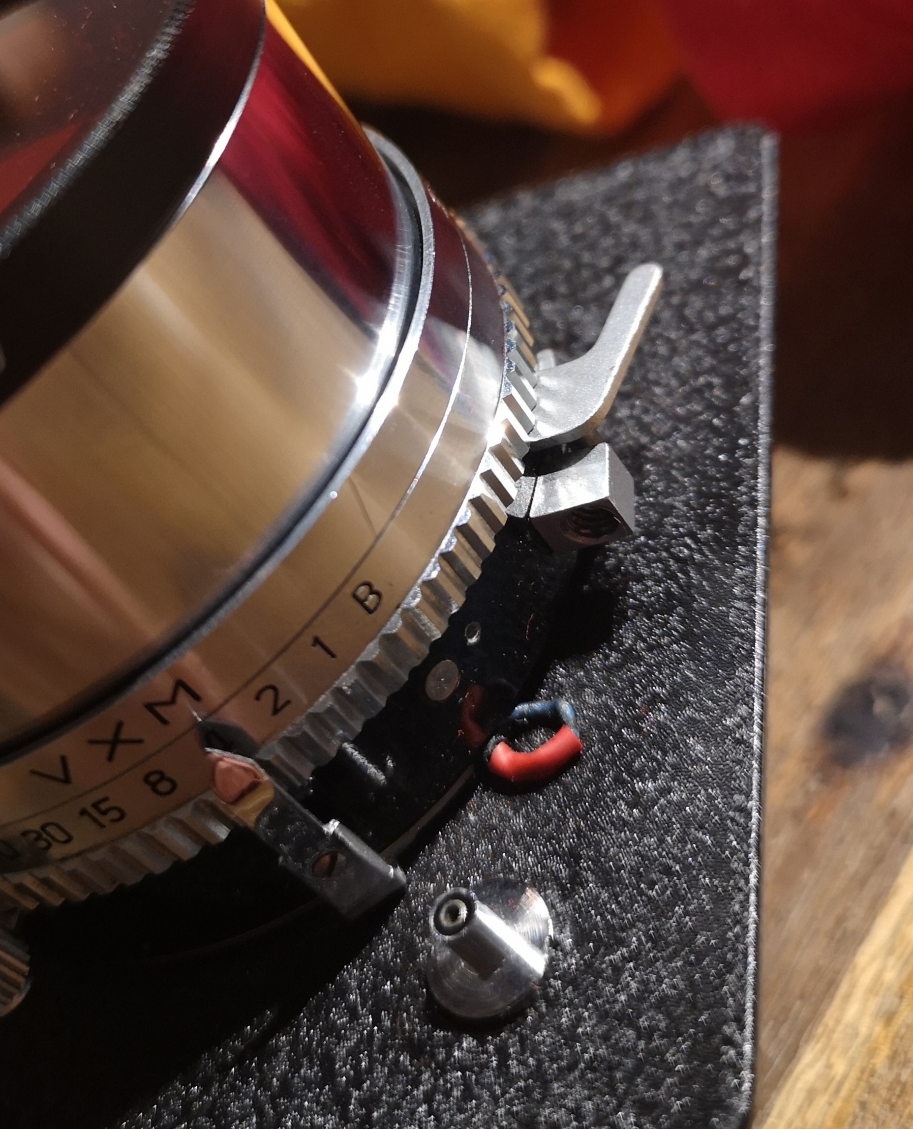

I bought a 105 that is still in the Horseman board, the end of the cable release needs to be somewhat large, at moment I cannot measure how large. The shutter trip lever is pushed by the cable release which is held place in a small tube with a set screw that holds the cable release in place. My standard cable releases are too small to held by the set screw but if I hold in place by hand the plunger will trip the shutter release. Maybe with duct tape wrapped around the end of a standard cable release the set screw will work. If not then a horseman release will be needed. As I am taking my 105 out of the horseman mount for a 2X3 speed graphic board I will need to trip it by hand.
I now have five 2x3 horseman lenses (65, 75, 105, 120, 180) all have a shutter release that can use the weird barrel attachement that horseman used, and all but one can use a normal cable release--you have to screw the tip into the bottom of the recess where the barrel attachment slides in and it works normally.
