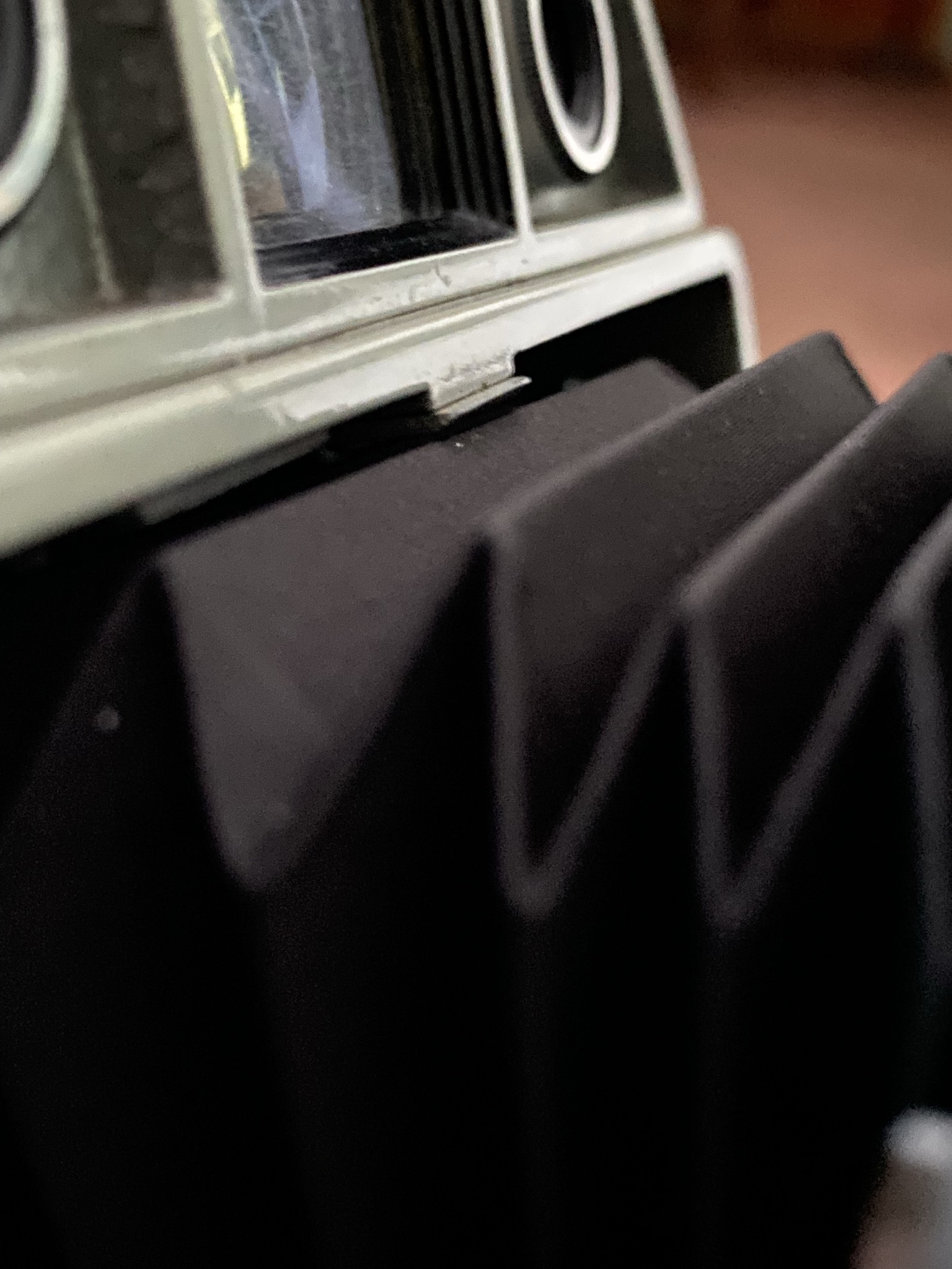

With the camera like this and parallel to the ground, you already have your horizon line close to the bottom of the frame, so it's a generous amount of rise. If you need more, you can use the actual front rise knob. The bellows will prevent full use of this knob, but by that time, you're already past having the horizon line out of the photo when the film back is level, so you shouldn't need it. Note that I'm using a light Nikkor-SW 90mm f/8. With a heavier lens, the rise knob on this camera might not have enough friction to hold it in place.

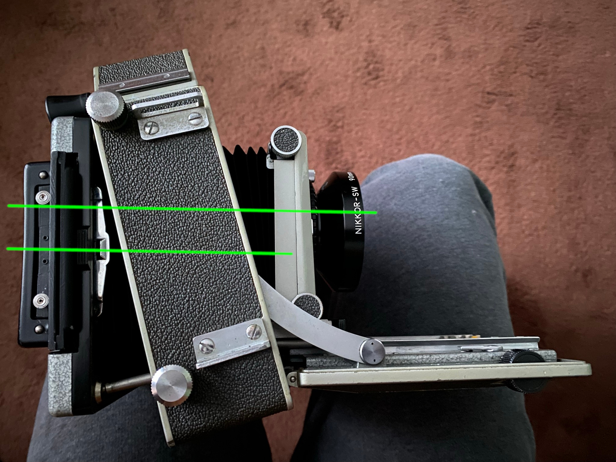

Here's the side view of the setup without any front rise knob turning.

Looking at the last photo I don’t understand what you are trying to do. The film plane and the lens board are both at 90 degrees from the ground. Normally the film plane is adjusted to not have distortion or keystoning and the lens is tilted for more depth of field.
In the last picture the lens is in the simulated front rise position. It will allow the whole building to be in the shot without keystoning, as you say. It can be risen more, with the front rise control, but the horizon line will already be about 1/4th from the bottom of the frame like this. It would help if I drew the central lens axis and film axis in the picture.

With a 90mm lens you're able to use less than half of the normal front-rise control due to collision of the bellows and the top of the camera. It's not enough rise to avoid keystoning in architecture by itself. But when you use the simulated front rise plus a little real front rise, it gives you more than enough to avoid the keystoning.

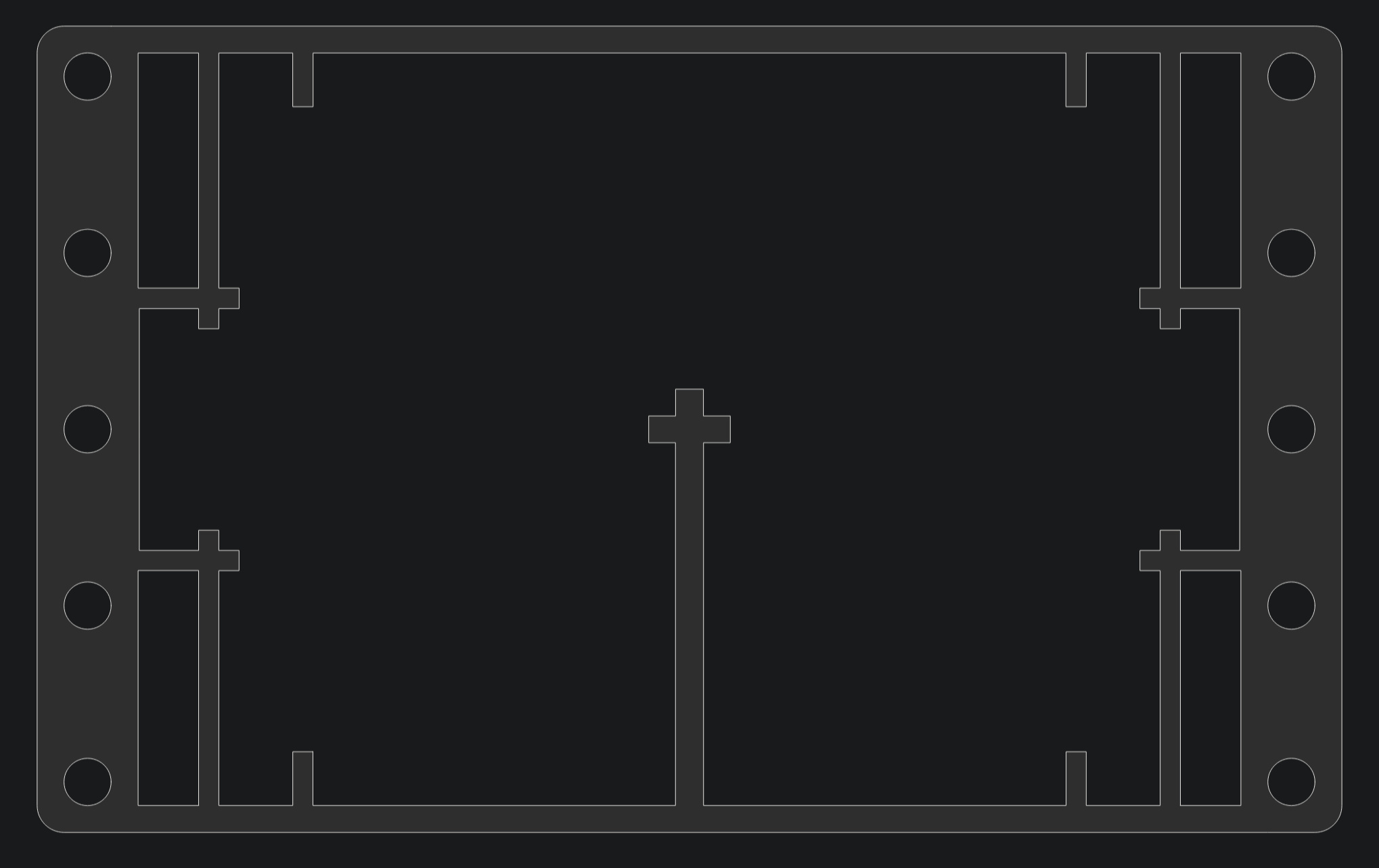

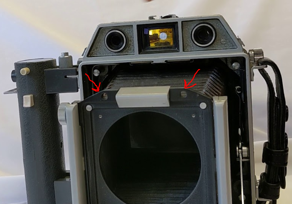

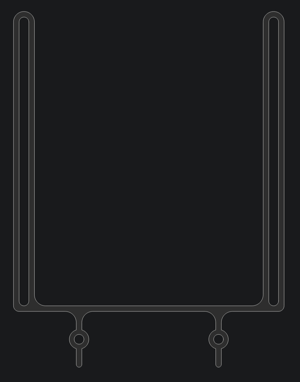

Does anyone have an idea for how to attach a printed/machined wireframe part to these holes on the Horseman front standard, which could be snapped in and out quickly? I want to put something there that can be a guide for framing without the ground glass, when this simulated front rise configuration is used.
  • loccdor
  • loccdor
  • Deleted
  • Reason: unnecessary
The holes are 3.5mm so I'm going to try M3 screws.

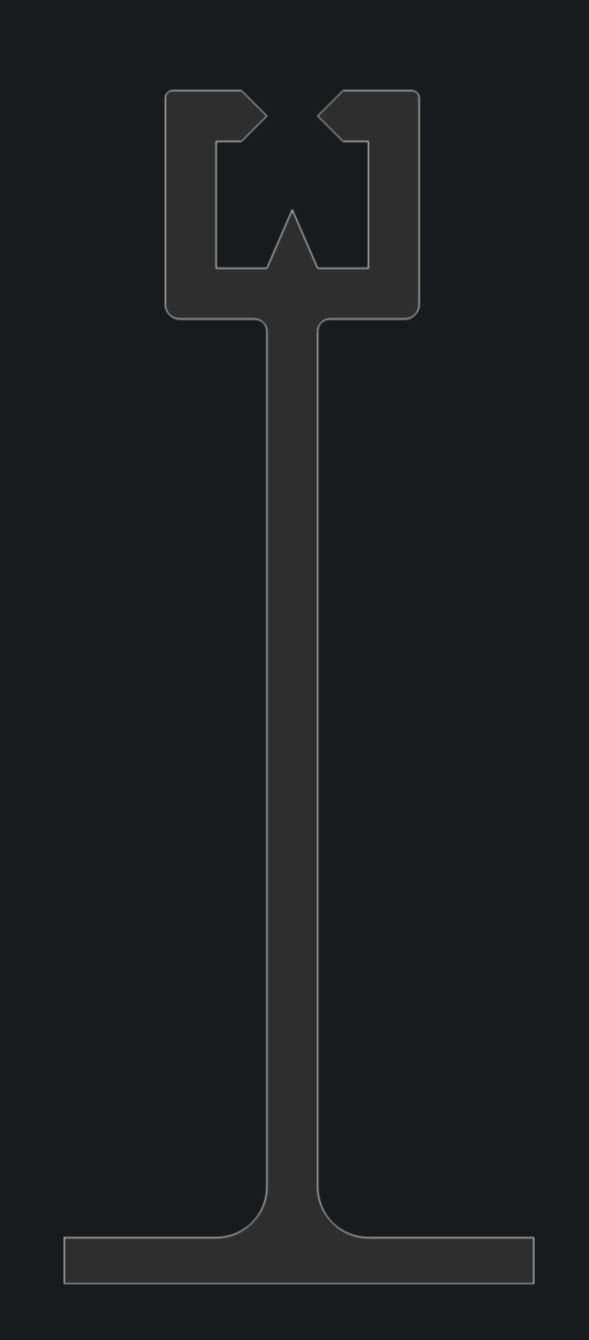

I designed 3 parts in FreeCAD today for the wireframe finder and I'm going to have them laser cut from stainless steel. Starting to get the hang of the program now.

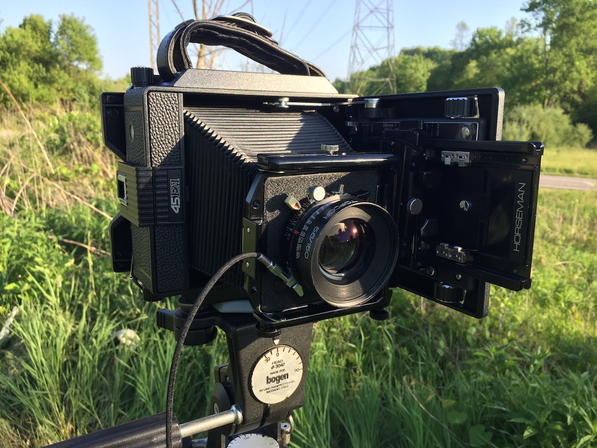

Is there any value to hanging a view camera up upside down?
Did old press cameras ever get used that way, especially under tripods?
Hmm, well if you needed front fall, that would be the way to get the largest front fall on the Horseman 970. One situation I can imagine that would come in handy is being on the top of a cliff or building and shooting what's below.
One thing I visualize is those old sky scrapper shots of the Chrysler tower, etc, taken with 8"x10" and larger view cameras and the hunt for dynamic points of view.
